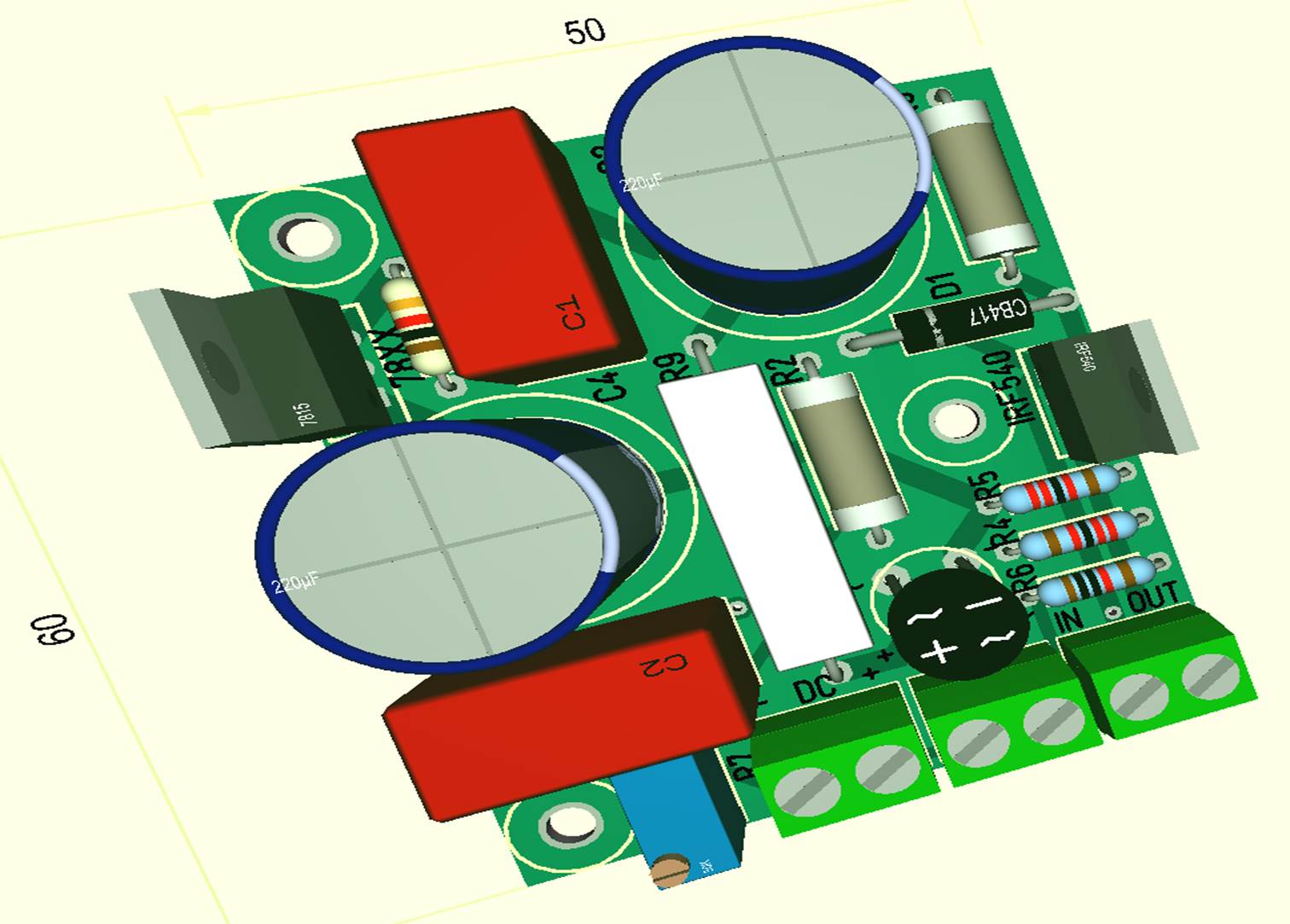

this is a cool way to drive the A2 tubes, if you don't like to use a FET.

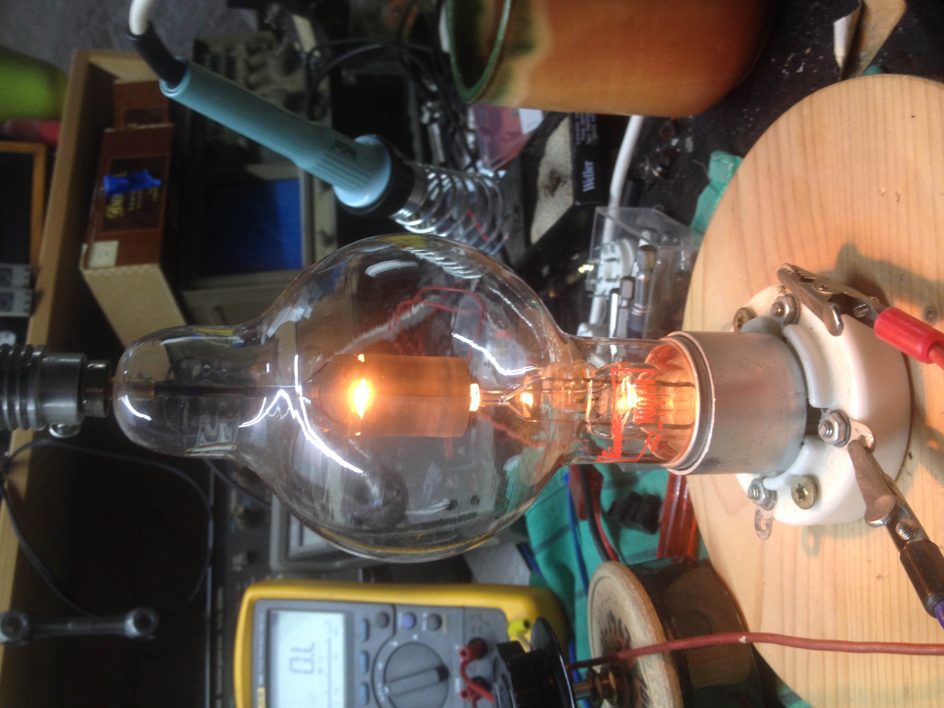

Cool looking tube can't wait to see your finished amps!!!

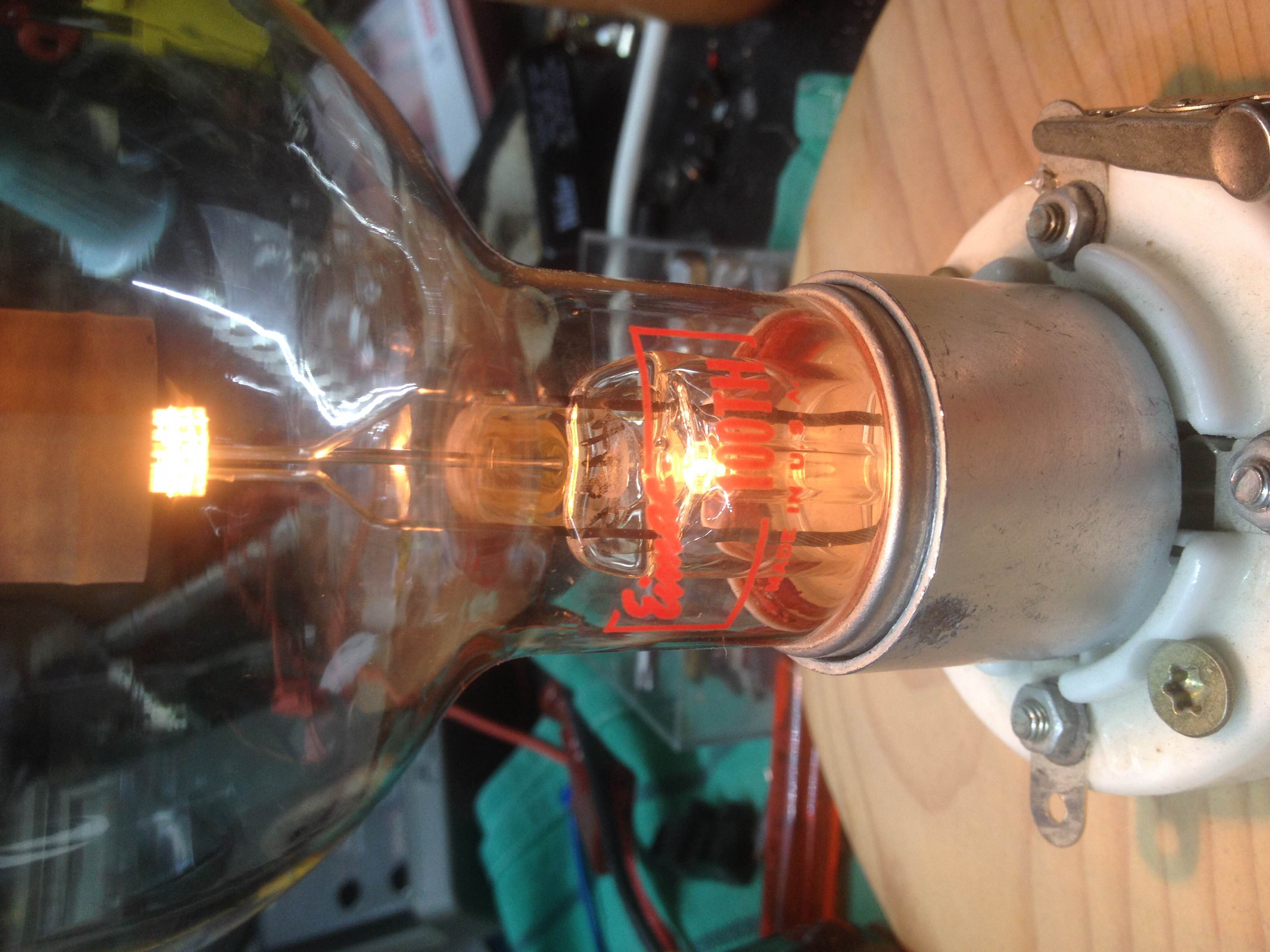

I like a temple bell type tantalum plate valves such as 100TH, 8025A and 808 which sounds are good in bass, though soft and smooth.
Also looking for the reddish valve during operation is a pleasure for me.

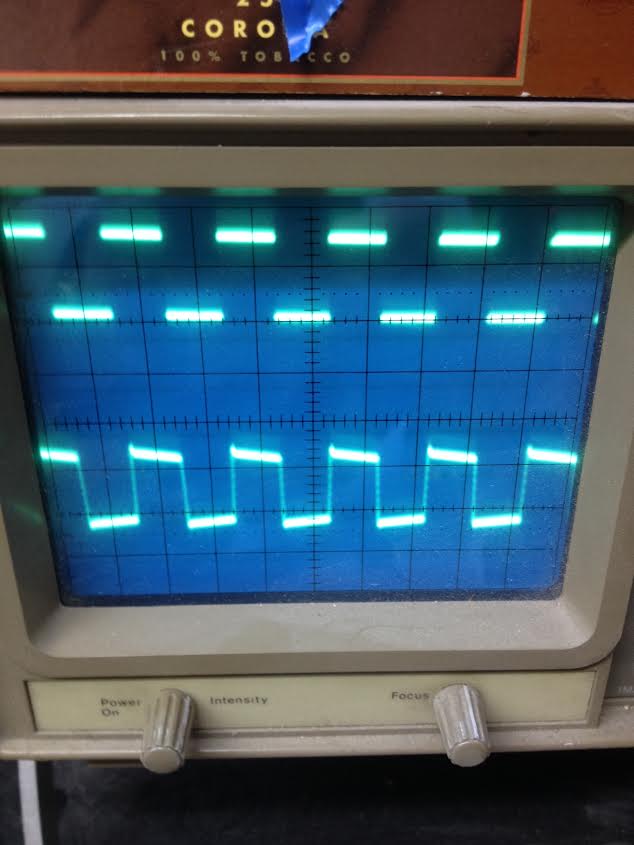

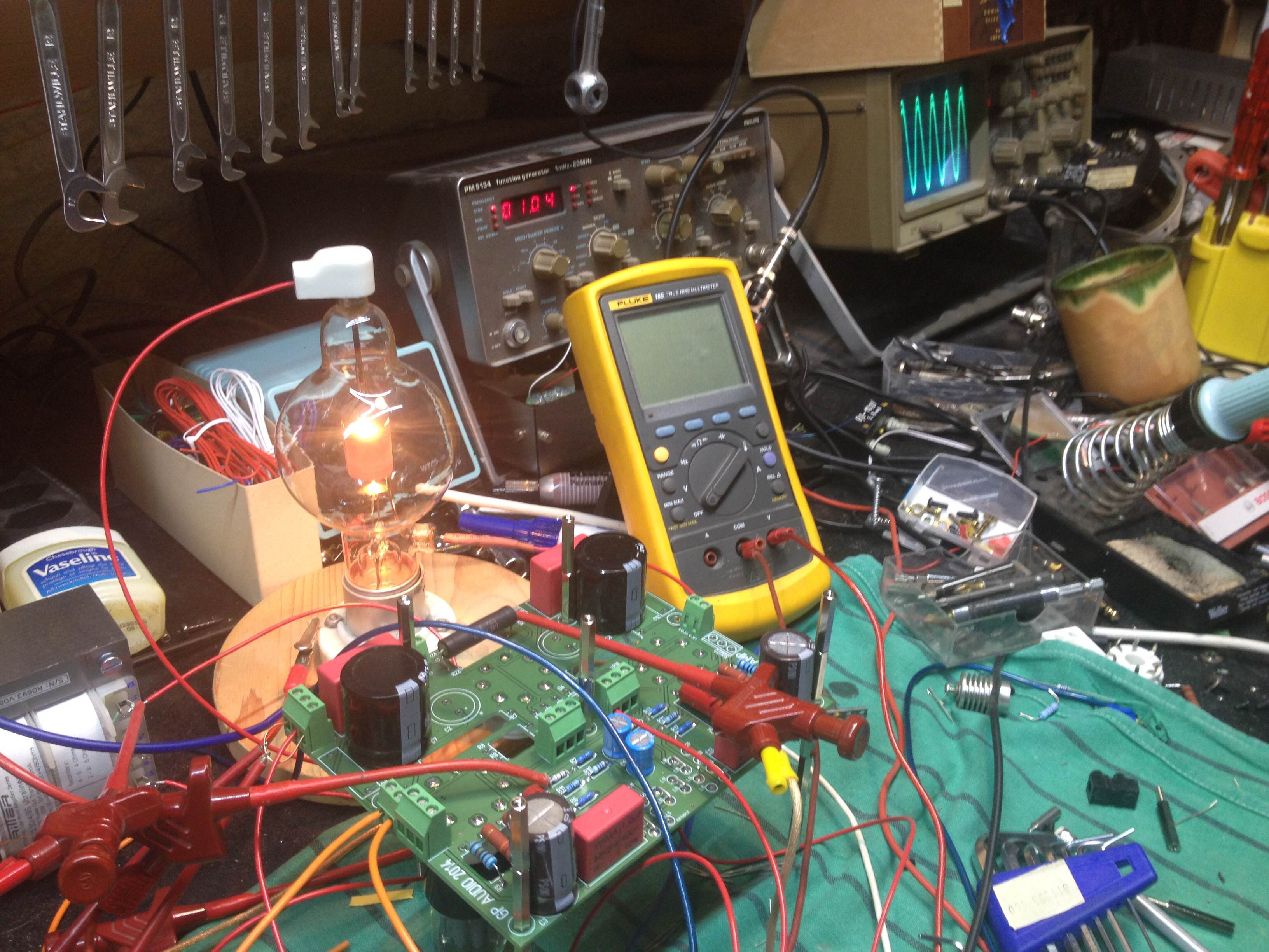

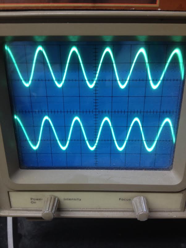

Very nice, have you done distortion measurements? It's interesting seeing Eimac tubes operated at such low plate voltage.
I can make some screen shots of a 1kHz sine and square wave this weekend at different levels.

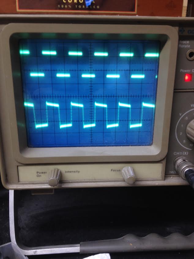

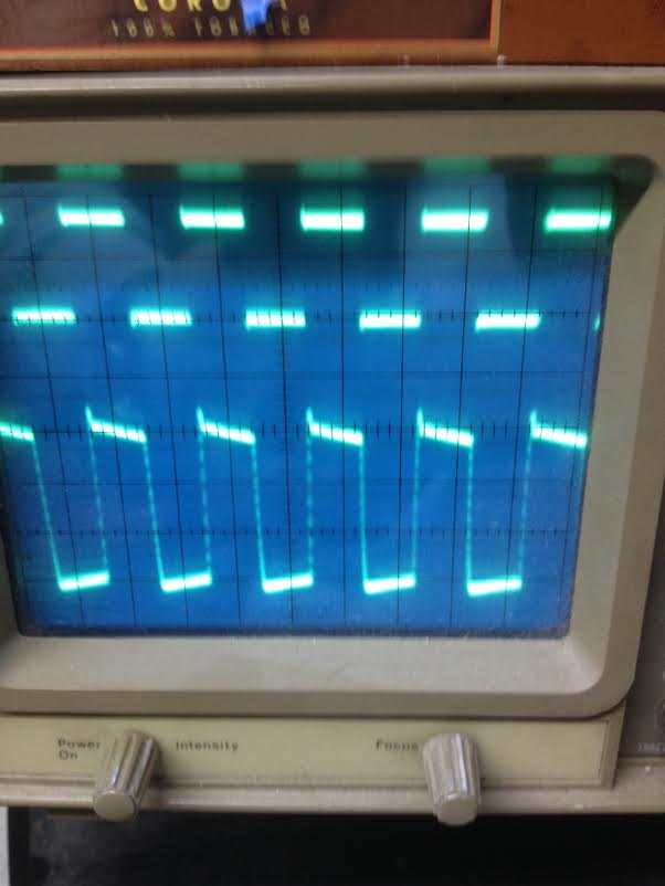

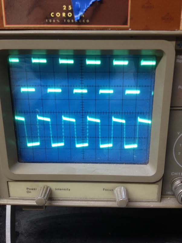

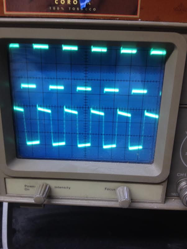

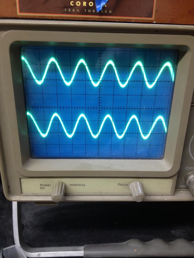

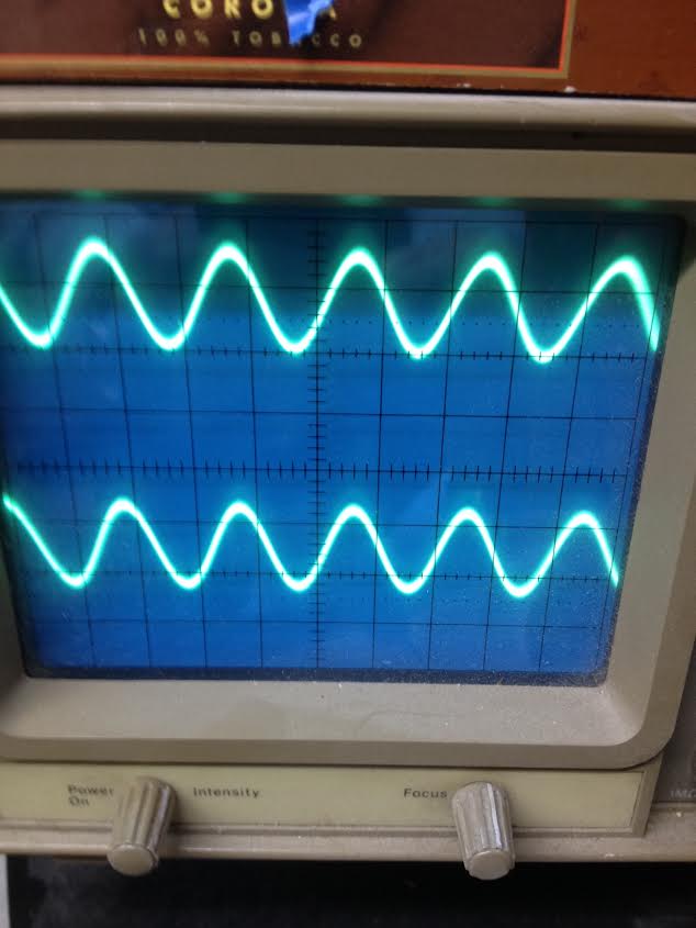

here are some screen shots of my scope.
in order 1W 5W 10W 15W 20W, sine and than square. my function generator (old) makes a little peak at the up flange of the square. I think it looks pretty descent. I also melted the clip of my probe 🙁
I measured on a 5ohm load on the 4ohm transformer output.
The sines are very precise, if I invert one channel and add the other, the line is pretty much flat.
I don't have a real distortion meter.
The little FET interstage boards should be arriving next week. Eurocircuits is pretty fast!!
And if anyone likes to see other measurments, I'll be happy to do them.

What frequency are your scope pictures at?
