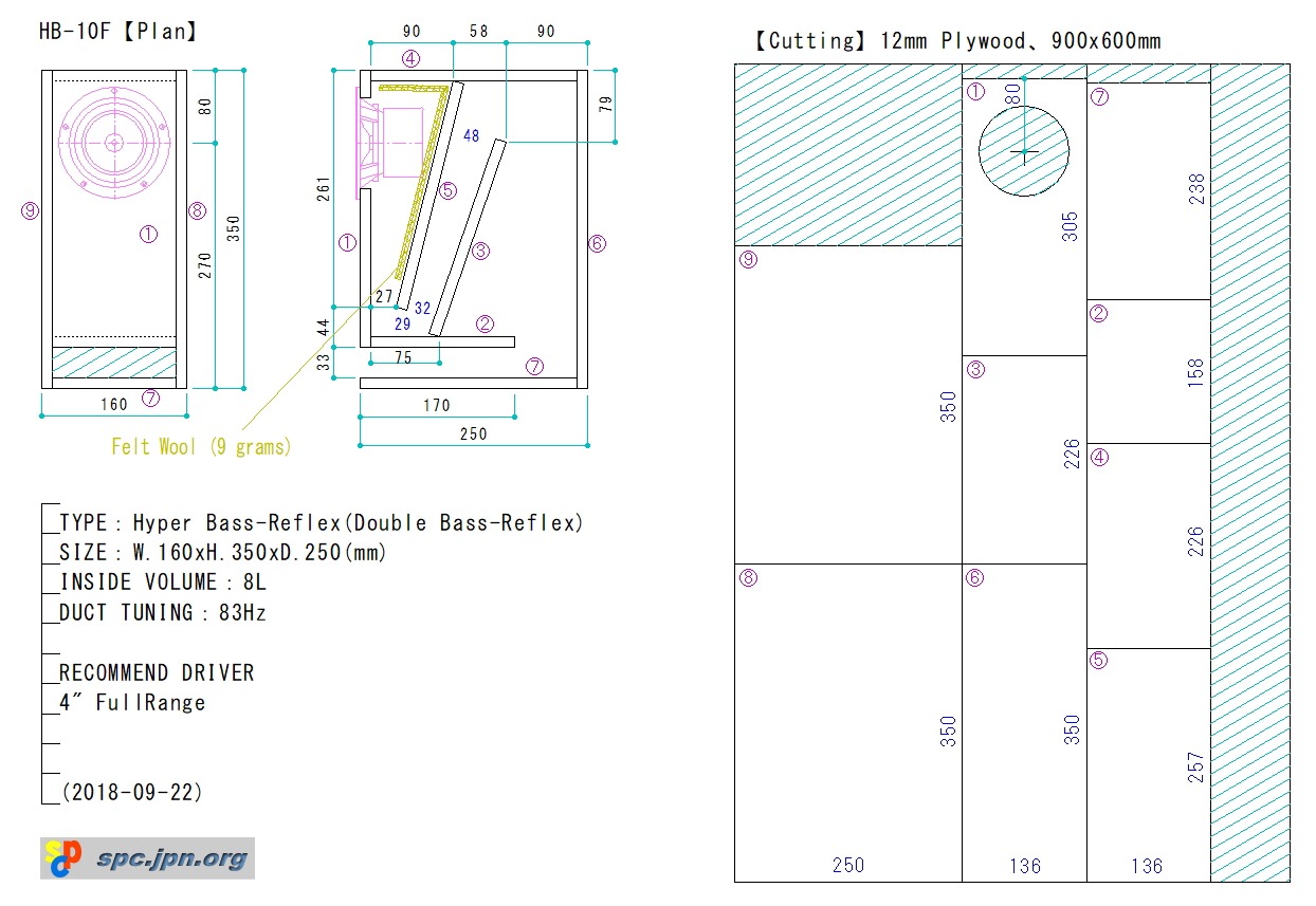

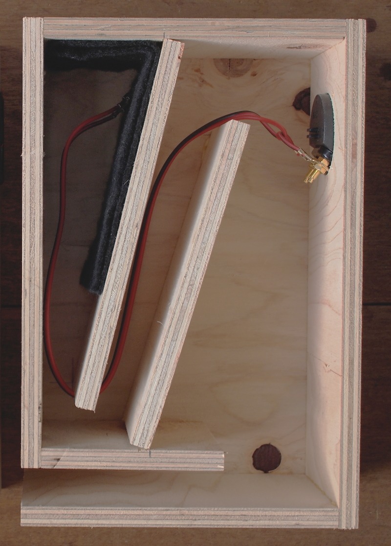

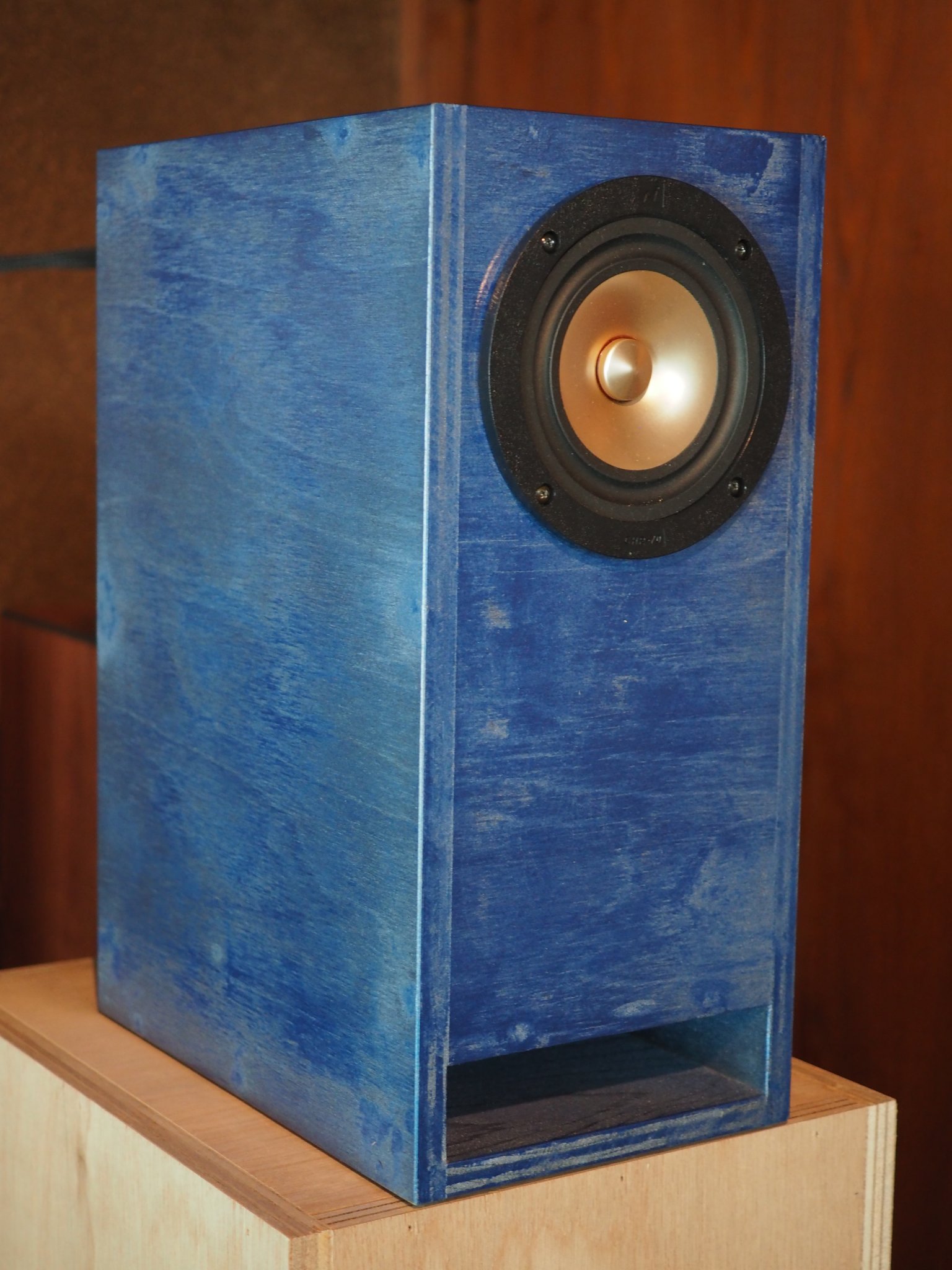

Looking for cabinet ideas for Mark Audio drivers
I use a double(hyper) bass-reflex box.
It is a small size, and it produces the necessary and sufficient bass.
