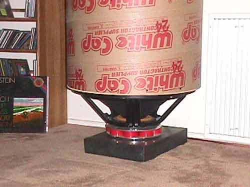

update ..
thanks for the info on woofer sag,.. i will consider repositioning if this sub becomes a longterm fixture at home.
anyways, .. i hooked up the adire shiva DVC in 4ohm config (+ to + , - to -).
much better bass, . wall shaking at times, ...much better than the mtx woofer.
anyway, .. on some bass notes even at moderate volume, .. i still see the woofer making a noise which can only be described as "thuk" , ... this can't be a 200 watt amp clipping at normal levels. the line is still 8 ft long and the high pass on the crossover is set to 35 - 45 Hz . The line is stuffed with polyfill at around 0.7 lb / cu.ft (0.5 lb / linear foot of 12" tube)
Advice? Is this a case of the woofer being unloaded or is there something else i'm neglecting? to cure this issue, .. do i need more length on the line?

finished !!
bored this weekend, picked up another 4 ft length of sonotube and coupled it to the 8 ft enclosure, .. also stuffed this at the same amount (about 0.6 lb polyfill / cuft), .. better control of the woofer at low bass as opposed to the 8 ft version, .. installed this in the corner so it takes very little real space. the flexy style legs are a boon for adjusting the orientation to maintain the tube absolutely vertical , ..as any slight mismatch in leg length shows up clearly after 12 ft.!!
note: i didn't glue the last 4 ft section to the main assembly (just duct taped it) in order to make disassembly easier in case i ever need to move this monstrosity.
note 2: it's amazing how stable the whole assembly is, .. no fear (at least for now) that it will topple over and bean the occupants of the home
will test for a few weeks and report back, .. i've had the shiva in a sealed box for the last two weeks, ... differences I seem to hear are a smoother bass response and somwaht less constrained sound (less boxy??)
thanks to all the contributors to this thread for their help and support. this is your sub, as much as mine.
any other suggestions / advice, ... please post
