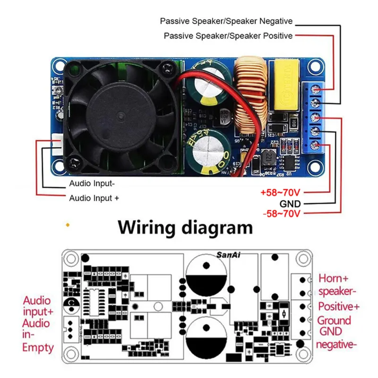

Option-1: Using Two IRS2092 500W 4ohms amplifiers feeding the each 4ohm voice coil of Rockford P3D4-15, Powered using 65-0-65 torroidal transformer linear power supply.

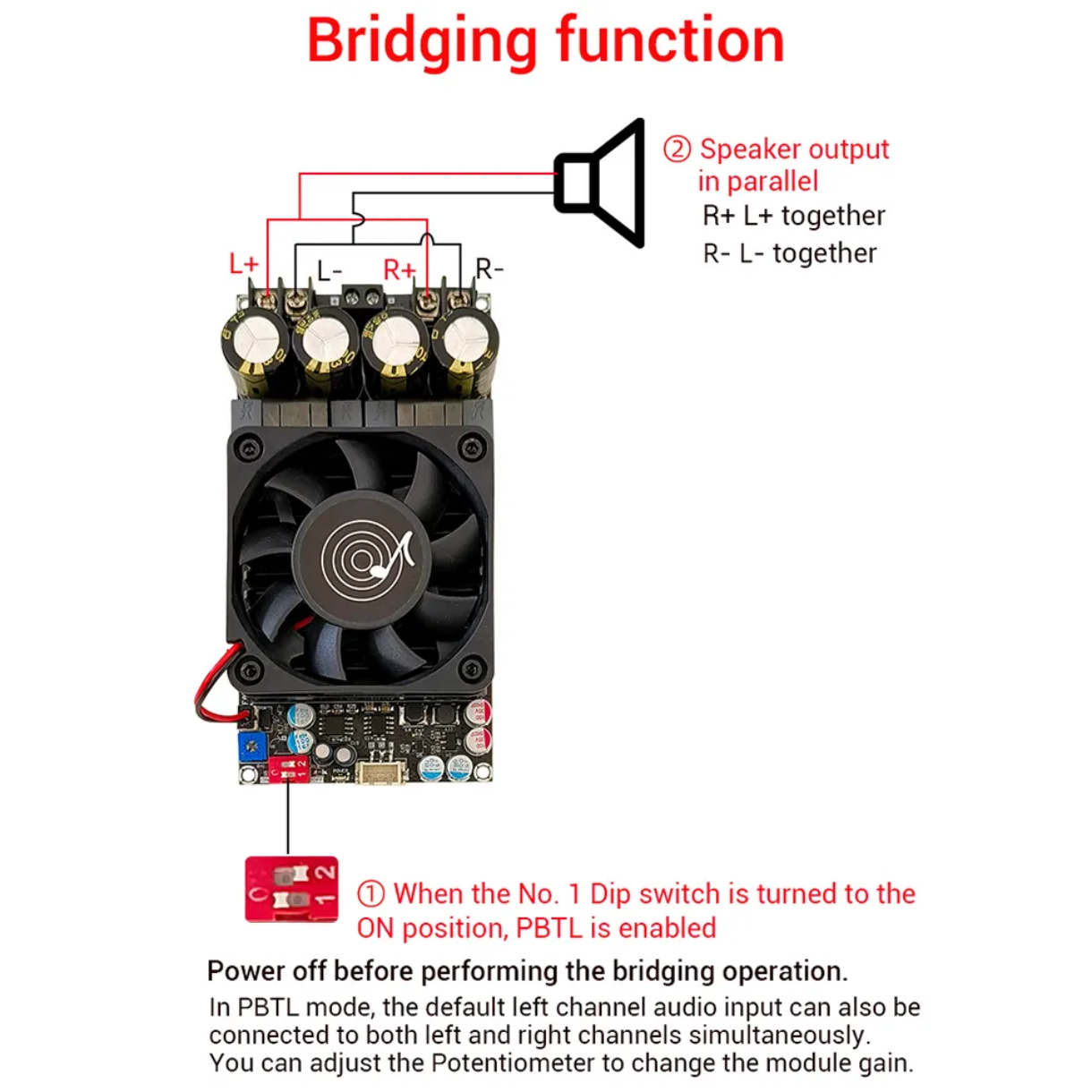

Option-2: Using Wuzhi ZK-3002, TPA3255 based dual 300W, 4ohm amplifier. Powered using 50-0-50 torroidal transformer linear power supply.

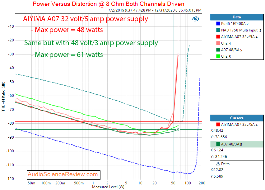

ASR provides good data on how much good power an amp can produce before the distortion knee (or clipping point). Those amp modules above are not rated for 500W and 600W of clean power, but at 10 percent distortion, which is not what you want. You want to know generated maximum power before the distortion rises sharply.
The red cursor is at the maximum clean power, which in those conditions is 48 W for a TPA3255 based amplifier, that is advertised as:
PS. In my opinion that measured amplifier, when given a good power source with high voltage and amperage, would be a good amp for subwoofer duty if total power is sufficient for intended application.
on their web site. The measurement seems to be within spec, if you pushed it to 10% distortion. Save yourself from a lot of trouble by learning how to read power measurements. In chip amps you can see all you need when looking at the chips data sheet.Output power: 300W*2 (4 0 load) 10% THD+N
Note that the 3255/48V measurement in that test is at 8 ohms, so theoretically double that into 4 ohm loads (so ~120Wpc into 4 ohms) and again into 2 ohm loads (so 240Wpc into 2 ohms.).
FWIW, the quoted 1% THD ratings for the TPA3255 chip used those amps is as follows:
Total Output Power at 1%THD+N:
260-W Stereo into 4 Ω in BTL Configuration
150-W Stereo into 8 Ω in BTL Configuration
480-W Mono into 2 Ω in PBTL Configuration
It's also a 4-channel chip and it can be run in 2.1 mode. This suggests to me that the amps that were tested by ASR are configured to use only two of the four available channels, as the measured results look like those quoted for the chip being run in SE mode, but I might be wrong here.

IRS2092S amplifier boards tested in the video links shared below demonstrate that the amplifier can actually give clean output upto 300 watts before clipping.
So I am thinking to connect two IRS2092 amplifiers to dual 4Ohm voice coils of the Subwoofer. This way I can drive the sub upto 600 watts without any issue.
