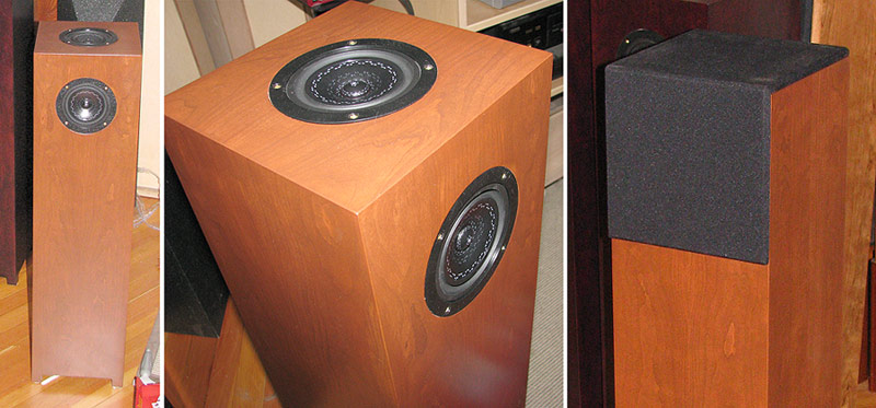

your idea for the madisound grills sounds appealing. Easily implemented and could be removed when the boy is a bit older.
What if you got 2 of the speakerworks grills and fastened them together in an L shape. Then with a small bit going down the back they could slip over the cabinet and cover the top and front driver without any attachment hardware at all. You could cover the metal with grill cloth if you like the look of this better. Seems simple and effective.

You'll see a photo of L-shaped frame posted in Dave's documentation of this design - those are captive by buried magnets.
If you were to wrap around the back as well into a U-shape, a couple of magnets would likely be all that's required to keep a snugly fit frame in place.

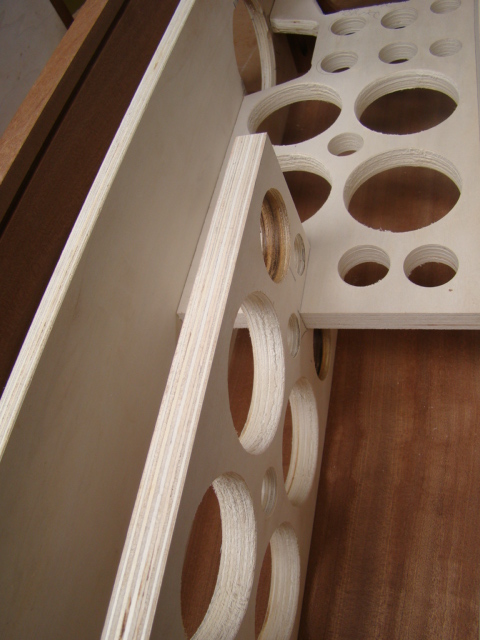

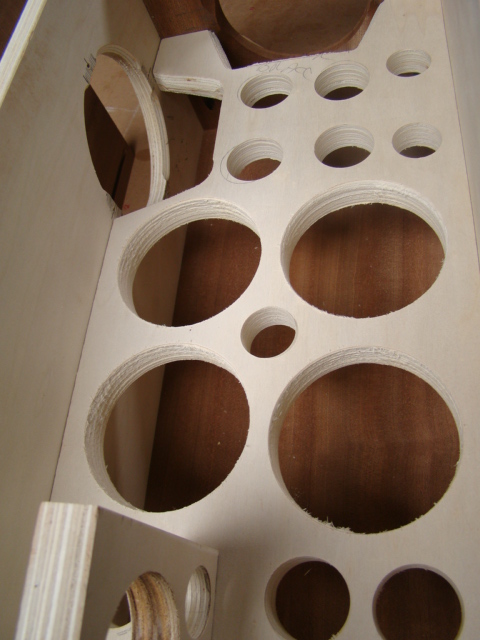

Since your here can you chime in on the need for the brace from side to side. In this case the sides are a full inch thick.
Thanks for you input, Evan
Different material so i'd only be guessing. That it is that thick may actually increase the need.
We built ours without (and a shorter driver brace). After listening with a mechanics stethoscope (an essential tool) we lengthened it in the drawings and added the lower one.

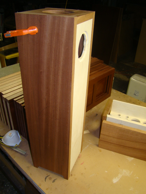

OK,
so von shipped me the drivers and I got the braces fitted. I also have felt to line the driver area, and insulation bats for damping the cabinet. I'll post pics of the damping when I get it in.

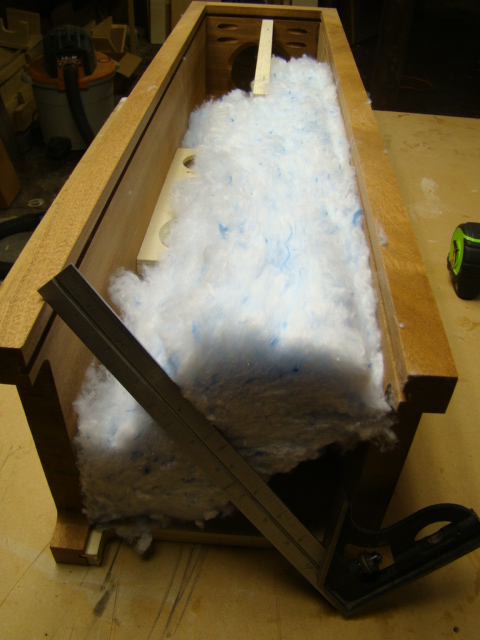

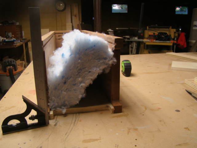

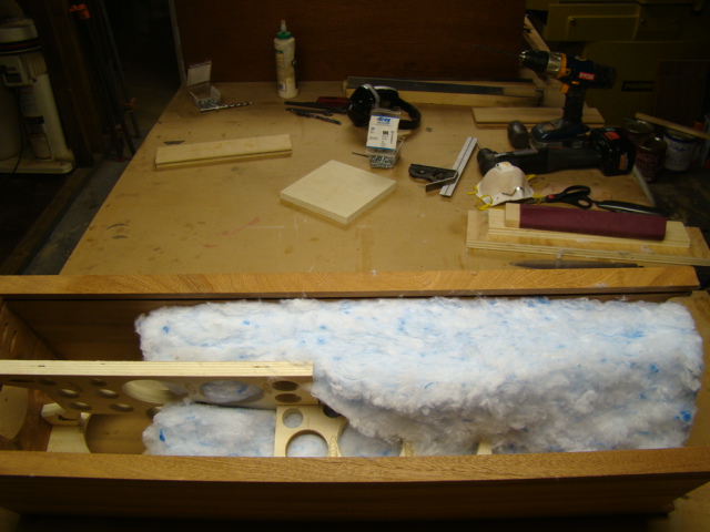

after having to take some time to finish up some of my "regular " work I'm ready to finish von's boxes. Please take a look at the damping mat and tell me if this looks close. I know I will need to clear an area around the port. I also have 1/2" felt to line the cabinet around the drivers, and fluff for between the drivers. Thanks for the advice.......Evan
Another question is how much to ease the edges. Just a bit 1/16" to 1/8", or up to 1/2" radius? What do you guys think? Thanks again...Evan
Even a 1/2" radius will have little effect on diffraction behavior except at the highest frequencies, so I tend to consider the edge treatment as cosmetic. As you're working with solid wood ( Sapele was it?) on the sides/top you have the freedom to go as large as you like, so whatever looks in proportion.
