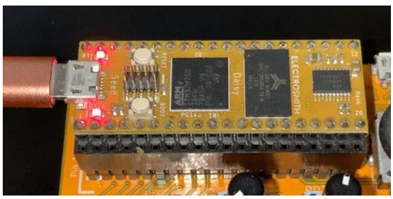

That's an interesting platform / environment !.
On electro-smith GitHub, picture of the board shows that the MCU is a STM32H750IBKx, x is 5 or 6. after checking only 6 exists.
This MCU has 2× USB OTG interfaces (1FS, 1HS/FS), but no High Speed PHY , you'll need to add an external PHY such as STULPI01B or USB3300 to reach USB2 High Speed compliance.
