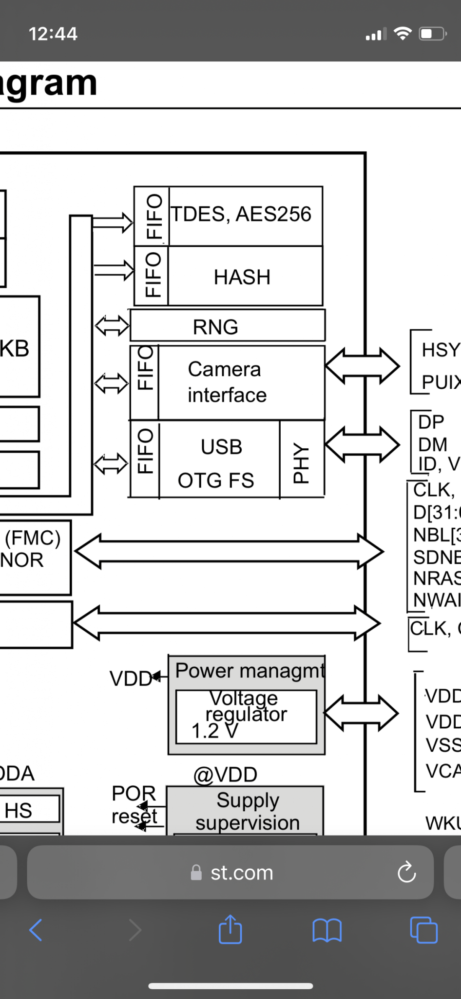

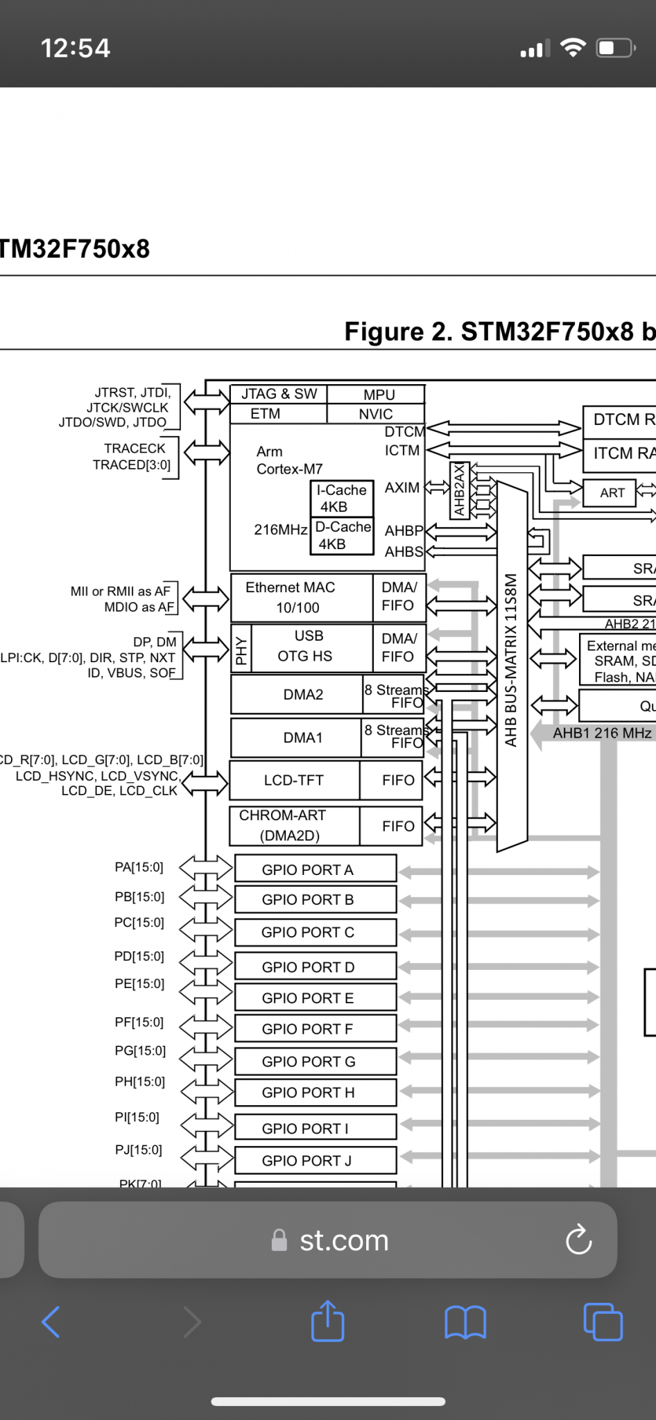

I was looking at the STM32F7508 dev board, it supports HS on the board. It also has a screen for debugging trace output but just looking at the board it has a direct connection to the WM8994ECS codec/amp. That includes a non jumpered MCLK and data lines so those would have to be hacked in physically. Possibly simply desoldering the codec may be the way forward.
I have a AK5572 adc doing straight through transfers so, in theory, it’a not going to be needed.
– USB 2.0 full-speed device/host/OTG
controller with on-chip PHY
– USB 2.0 high-speed/full-speed device/host/OTG controller with dedicated DMA, on-chip full-speed PHY and ULPI
– 10/100 Ethernet MAC with dedicated DMA: supports IEEE 1588v2 hardware, MII/RMII
Hmm so USB2.0 HS but then seems to state on chip FS .. so it looks like the onchip OTG is FS but can be expanced to HS with external help. If I read that right.
However the diagram shows PHY FS:
