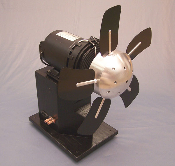

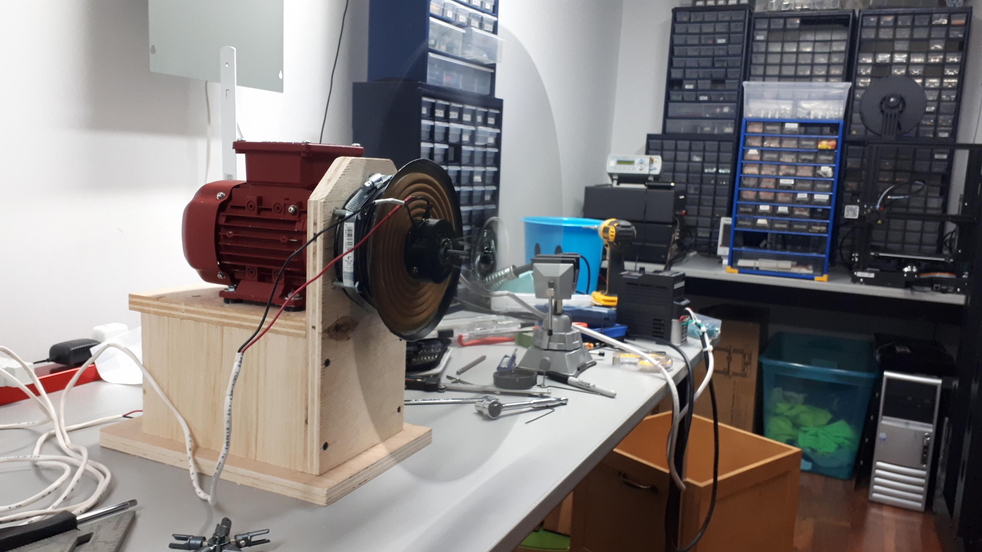

Please clear my doubts, I´m straight answering your original question but need more details.
As I see it, unlike any type of "piston" speaker, your modulated fan CAN go down to DC.
In fact, all fans produce Acoustic DC, just unmodulated.
In yours, blades rotate at constant speed and output is produced by varying blade pitch ... please confirm/deny.
Yes that is correct ... like a helicopter controls blade pitch
IF so, a DC supply drives the electric motor, and Audio power drives the blade actuators. Yes/No
Yes ... the motor is a 220 volts 3 phase design that is controled buy a VFD (Variable Frequency Drive) and runs at 800 RPM
IF so, please provide the actuator schematic, with coil data: drive voltage needed, and resistance/impedance.
Speaker motor came from a 15" subwoofer with a 2" voice coil and a spider diameter of 7". Impedance is 8 ohms and can support 150 watts RMS

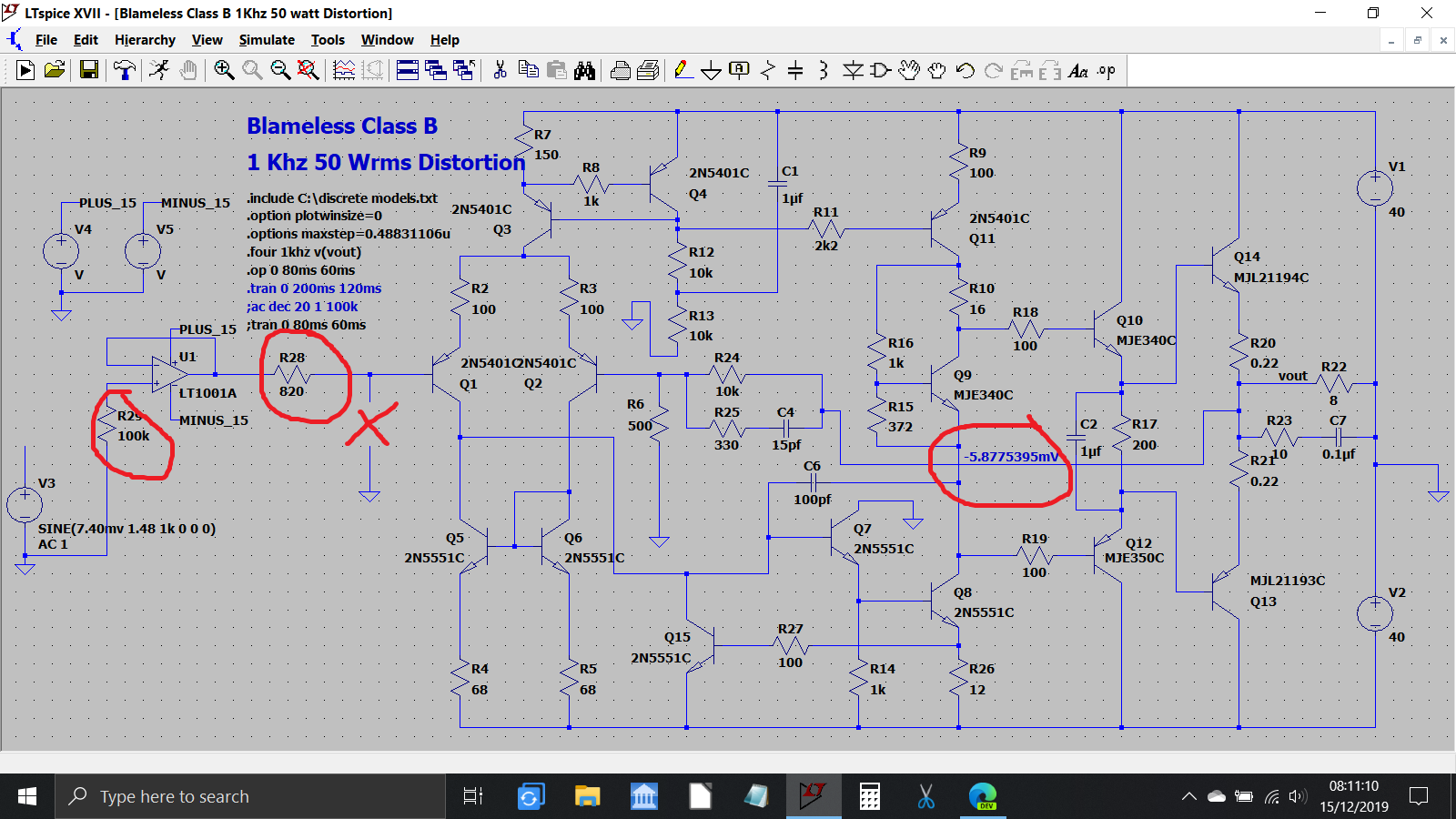

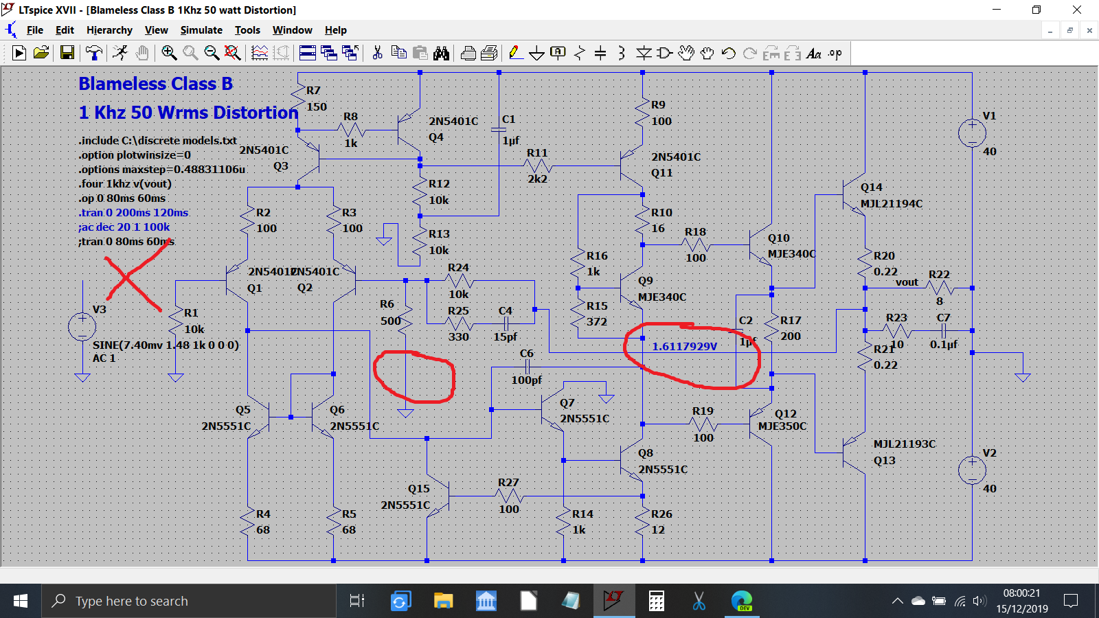

Lets do a quick hatchet job on the Blameless Class B... and this will show how to approach altering any suitable design
We remove the input coupling cap and short out the feedback return cap. This amp is actually pretty good and gives a DC offset in this state of under 2 volts DC.

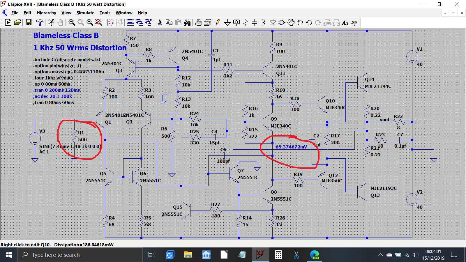

The imbalance at this point is caused by the 10k input resistance R1 and the 500 ohm feedback return R6.
So we make R1 approximately 500 ohm. The offset is now less than 100mv.
You now have a small problem of actually driving the DC coupled amp because the input impedance has to remain at that 500 ohm level. One option is to add an opamp in front with a 500 ohm series resistor (you can tweak the value to get zero volt DC offset at the final amp output. This now allows for us to set the overall input impedance to whatever we wish (100k here).
Cautions...
A relay delay at the output would be mandatory because switch on and probably switch off will not be pretty in terms of transients generated.
The opamp should probably be a FET type like an OPA134 etc.
Higher power can be achieved by using two or possibly three pairs of output transistors.
All this would be a starting point for converting an amp to DC operation.

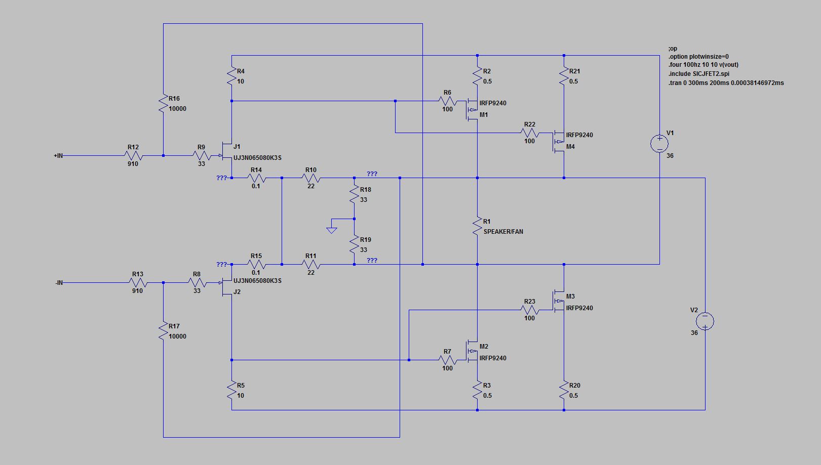

Here is a DC-capable but DC-stable circlotron amp. It will need more paralleled P-channel MOSFETS on the output to lower distortion and lower output impedance. I have not optimized this amp yet, so distortion is way to high. See it as fast and rough early draft.
I would prefer some IXYS devices (IXTN120P20T) on the output instead of IR/Infineon devices, but I don´t know how to add those to LTSpice.

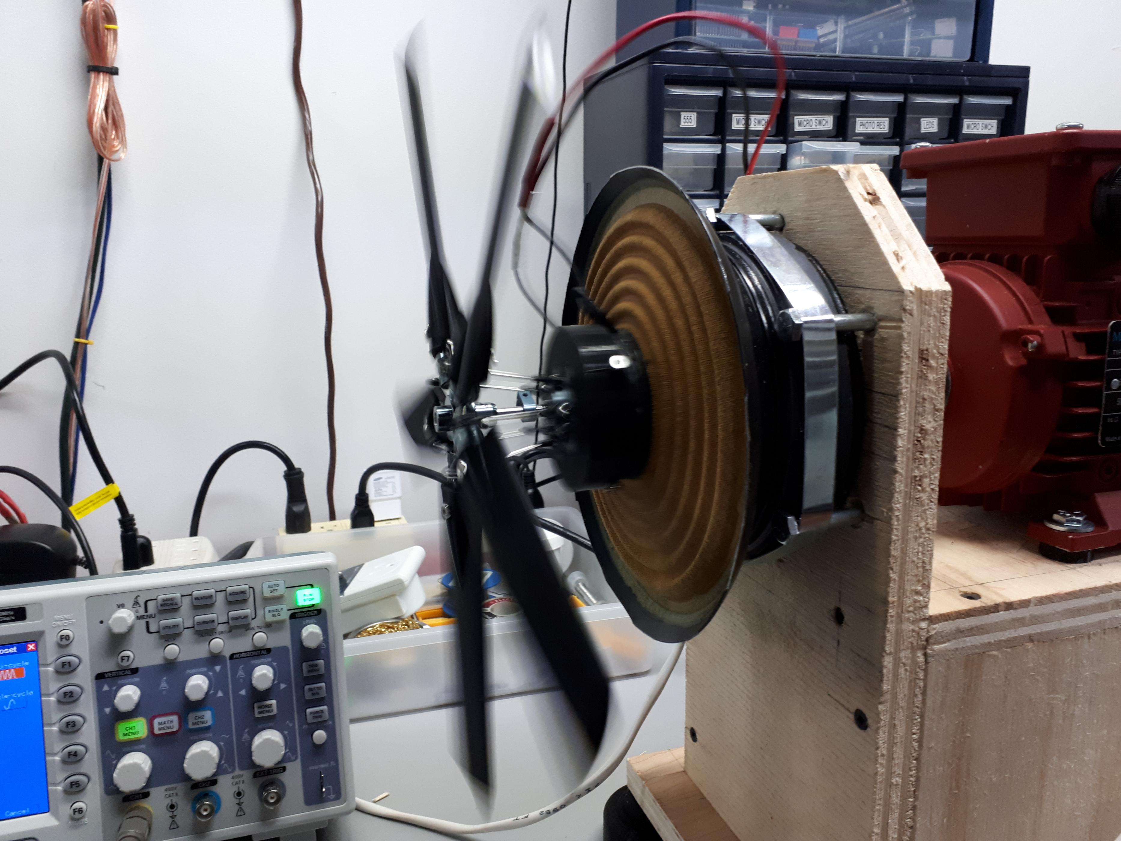

Finished building it and it works great
