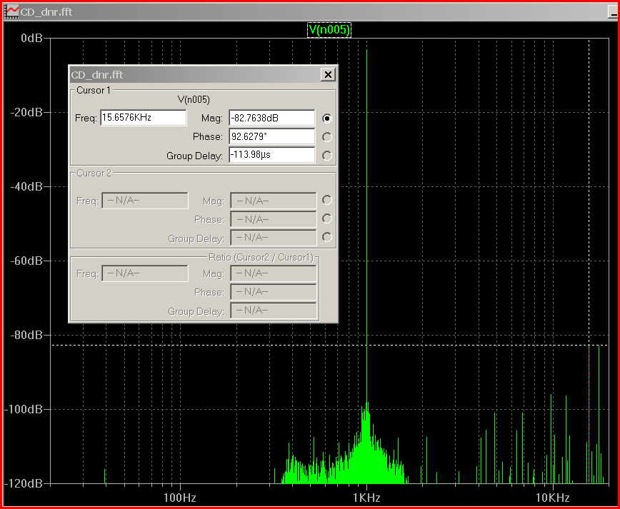

You can put out nice sinewaves from your soundcard...
even in mp3:
I don't see big problems -80 dB spurs are pretty good compared to what a "simple" analog sine oscillator will do
no way you're going to get the narrow linewidth even a poor xtal in a cheap DAP will give
I created a 1 kHz sine in Ltspice - exported with the .wave function
used foobar2000, lame 3.99.2, encoded as mp3 v2,
reconconverted to .wav - back in to Ltspice
below is a 1048576 point fft of 10 seconds 1kHz sine > 16/44.1 .wav > mp3 v2 > .wav
that shows a spur as the 1st limit - you can measure around spurs if you just want THD, IMD
