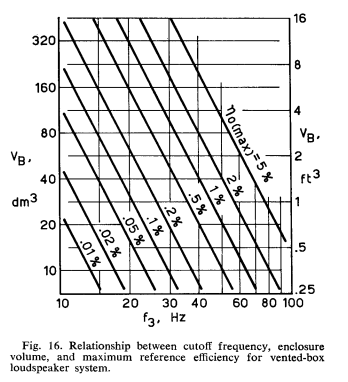

This is an oxymoron IME, especially if it has to fit in a 1 ft^3 box, so 'chasing the impossible' is apt. 🙁
Per the sealed chart, a 1 ft^3 cab @ 20 Hz can only be 0.1% [0.001] efficient = ~ 112 dB + 10 log (0.001) = ~ 82 dB.

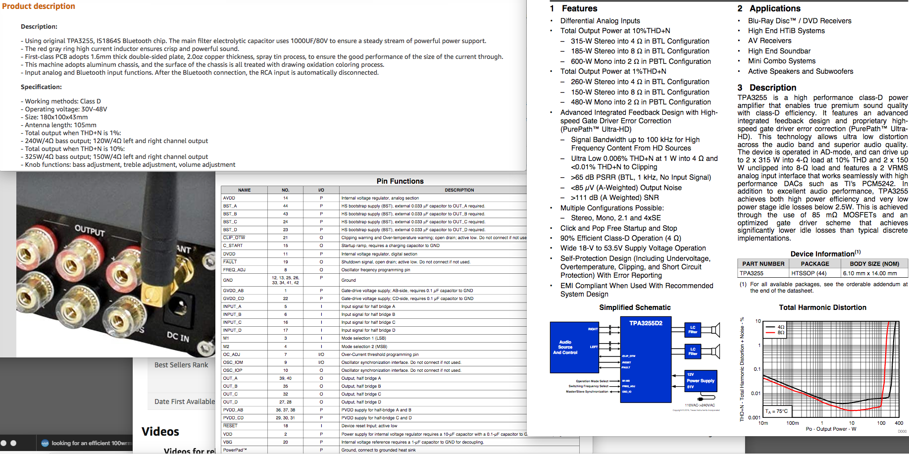

so I'm looking at 2 different TPA3255 boards with bluetooth. I read on the Texas instruments website that the chipset can support different outputs options. My question is, If I get this one with 150wx2 +300 for the Sub If I don't hook up the sub, do the 2 stereo speakers get the FULL 300w x2 ???
or should I get THIS one with only 1 knob 😛
Assuming you have a 48volt (actually 51VDC) supply that can provide about 700 watts, and the little DC plug does not melt, and you don't mind 10% distortion, the TPA3255 amp can provide about 600 watts total at 4ohms.
In the L/R/Bass configuration, not using the bass output won't allow any more output from the L/R, they each can do only 120 watts at 1% distortion in to 4 ohms.
The "1 knob" unit can provide two channels with double the power, 240 watts at 1% distortion at four ohms.

Awesome thanks thats just what I thought! I ended up grabbing the 2 channel model, and a meanwhile 48v 7.5amp power supply for 28 bucks 🙂 7.5amps x 48v will still get me some decent power for short money!
