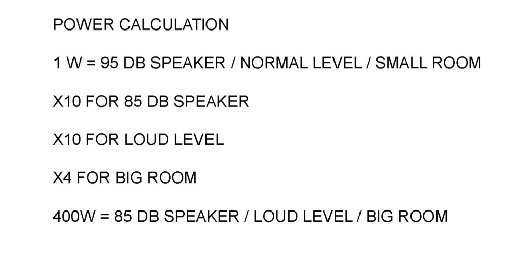

My suggestion are :
more power = less natural sound [ too much transistors inside ]
the same power amplifier with more efficient speakers = much louder
and transparent sound [ only few transistors ]
speaker big magnets push the sound for free non additional electricity costs.
Was from CAS 2015 Mr Pass write article about amp watt / speaker dB / room space.
Thanks Papa
Hay, thanks a lot for the table. Unfortunately, my speaker is 85dB and for some louder music session (Movie soundtrack or symphony) enjoyment 100W is right in the ball park.
Or maybe I will cut down my enjoyment to 1/2 when I realize how big and expensive those heat sink costs.
I like high efficiency idea, but that is probably going to derail this thread.
I'll research more on that later.
