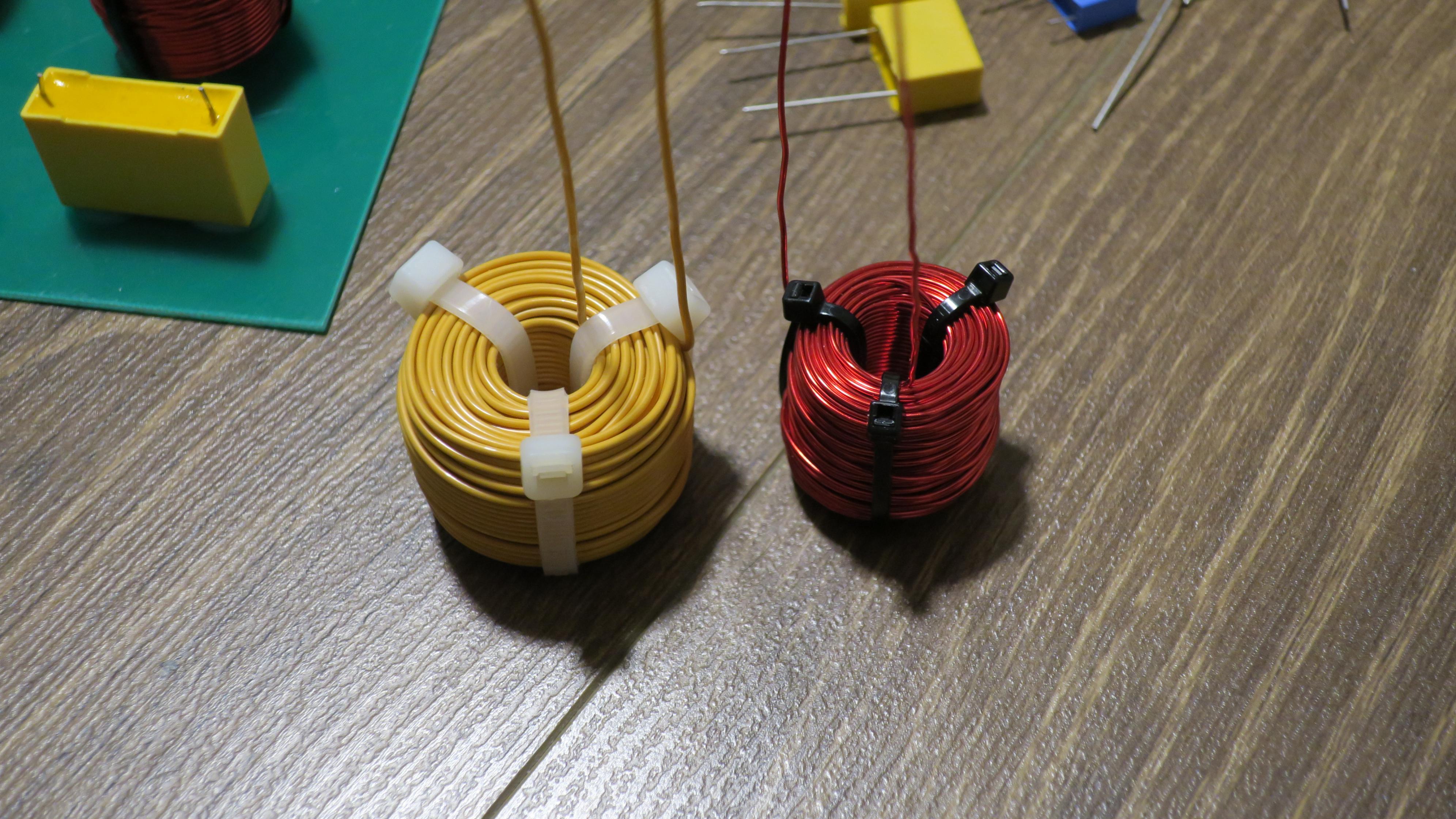

18/19/20 awg inductors are fine - especially if you can factor in the resistance and get rid of adding resistors as noted above.
For woofers, I tend to go iron core for space saving and 15awg - not because "bigger is better" but to reduce resistance and maximise sensitivity.

I just made some 0.5 mH air core inductors (15 minutes for each inductor). The yellow inductor is 18 AWG triple insulated magnet wire (OD=1.7") and the red inductor is 20 AWG enameled magnet wire (OD=1.3"). You can see the differences in size of both inductors.
