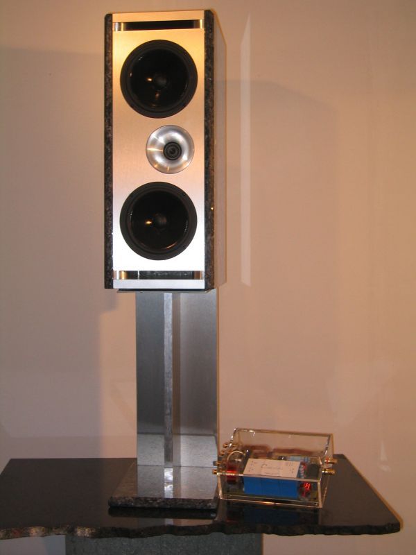

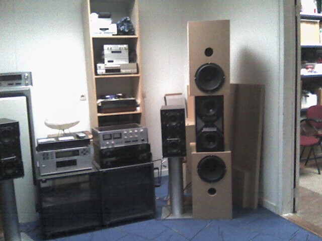

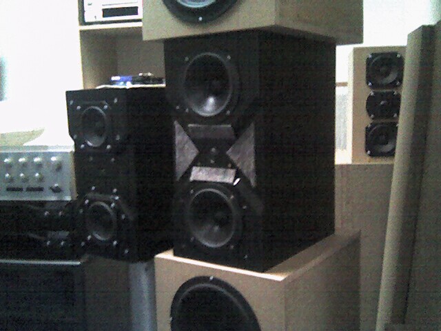

Some pictures
Picture of the modular setup at this moment.
Perhaps my previeous message wasn't to clear.
I like the D28 much more then the TX300.
Perhaps what some might call "synergy"of the system ??
The dynaudio sounds less sybilant , to my ears , which I find more "sweet".
XT--D28

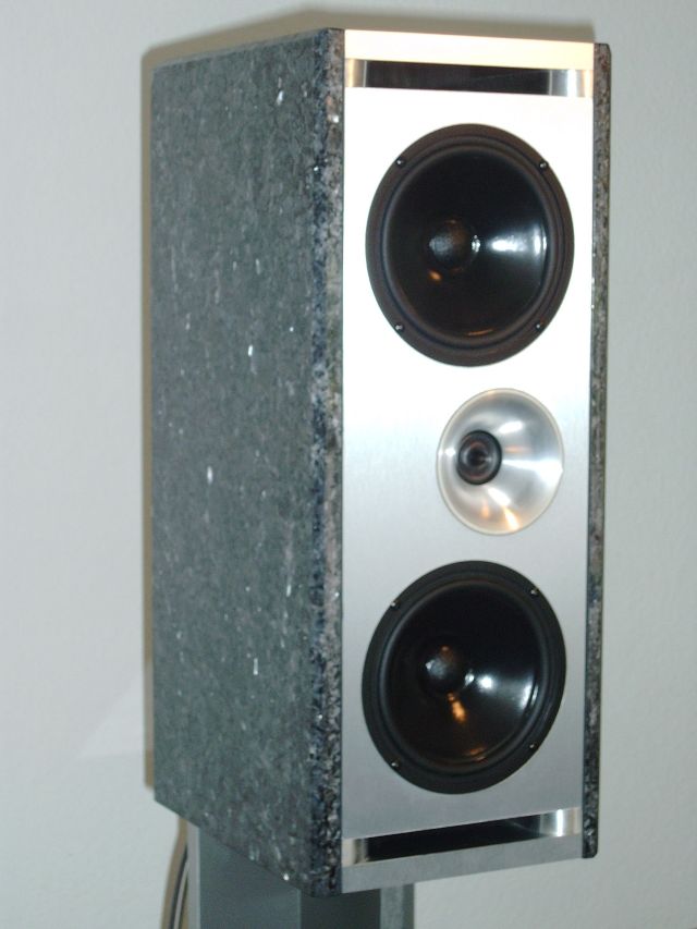

Hi Leonidas,
have used the D28 (without ferrofluid) and the XT25. The former with 2 15cm-Drivers in a symmetric D´Appolito-Style. I found the D28 too mellow for my taste with too less resolution. Using the D28 without the Ferrolfluid improved things much. Still the D28 sounds very smooth.
A newer Design (the Calvini) features two 17WN225 by Vifa (imo not only the oldest but still the best 17cm-Driver of Vifa )😎 and the XT25 is mounted in a spherical Horn. The XT sounds silky smooth this way without giving in on resolution and with the chosen dimensions of the Horn step response is excellent.
Compared to this, the D28 w.o FFL and even more the FFL-filled D28 sound dull and mellow.
A minor drawback for some applications is the high directivity of this sytem
Filter
with the horn the frequency esponse of the XT25 (its identical to the XT300 apart from metal face plate) alters. It becomes a rising response with a max of app.100dB at 2kHz and from then on a steady linear falling response. So You can design the HP-filter with a higher cutoff-freq to get a linear response again. I used a second-order HP together with a Notch on the Tweeters fs. The Filter runs without any serial resistors to fudge with sensitivity at a crossover point of app. 3kHz. The box has a sensitivity of 93dB, which is just a bit over the tweeters sensitivity (thats what made me think about a horn in first place!). So the overall frequency response of the box is very linear up to app 15kHz and starts to roll off above this point. Using the horn had several benefits. Distortion at the lower frequency range is reduced, the tweeter has ample headroom left, the rolloff at the upper end leads to a very crisp, but smooth top end and step response and phase responses of the woofers and the tweeter is improved (the horn is 38mm deep)
Some listeners at the High-End-Fair stated, they hadn´t heard the XT before so smooth on one hand, so dynamic on the other.
The Mid-woofers I use are paper types with a small VC of 25mm diam. Because of the smal dustcap and just the 17cm basket they lok a bit oldfashioned. They are rather the brain- than the muscletype 😉 They have the highest SPL of the Vifa-range a strong motor, yet a leightweight swinging system. Measurements show very easy to use parameters for a BR-loaded small box. frequency response is very smooth with a close to perfect roll-off -You might be tempted to run this speaker even without any Filter if it wasn´t for beginning directivity. In the Calvini I use just a serial inductance of 0.56mH
jauu
Calvin
