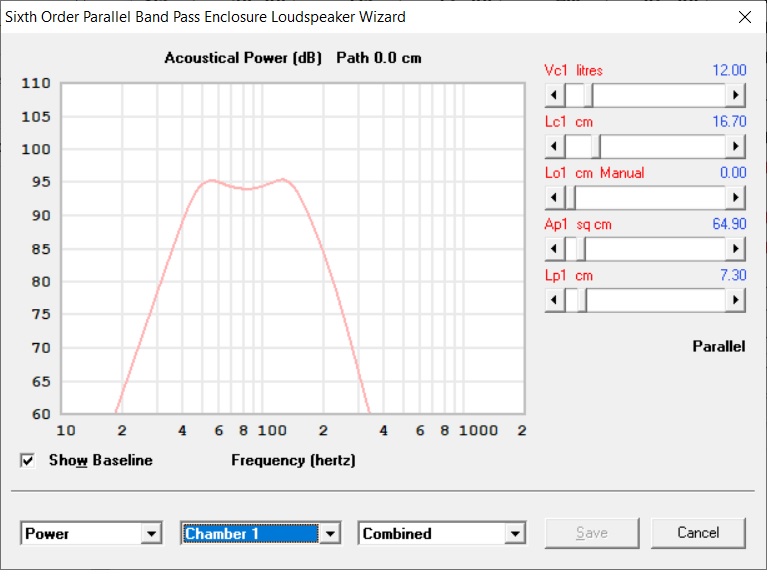

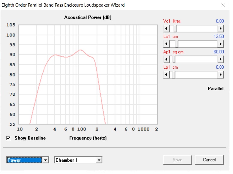

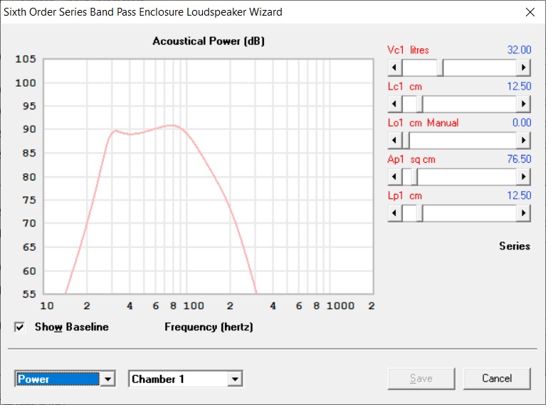

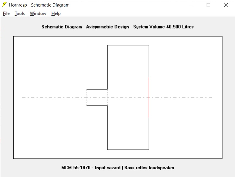

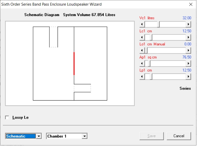

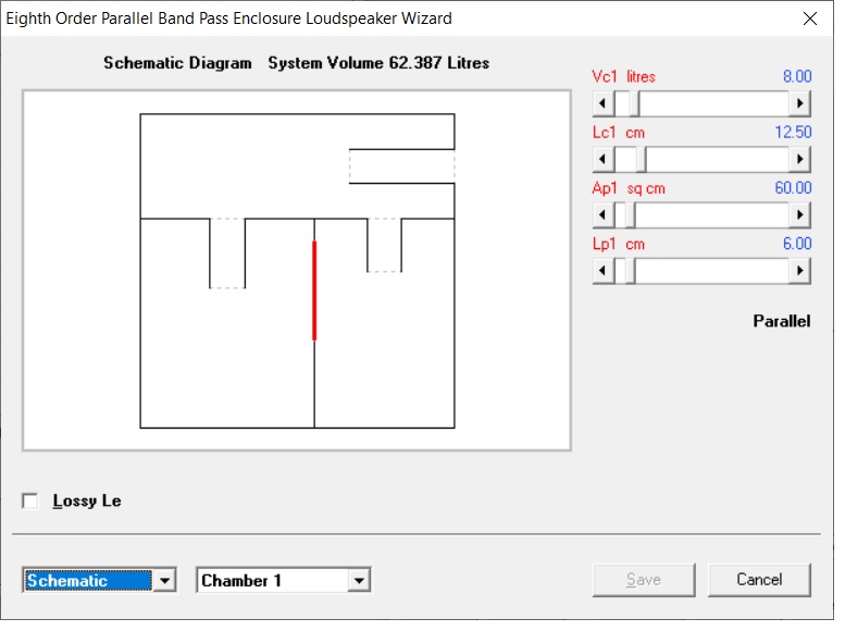

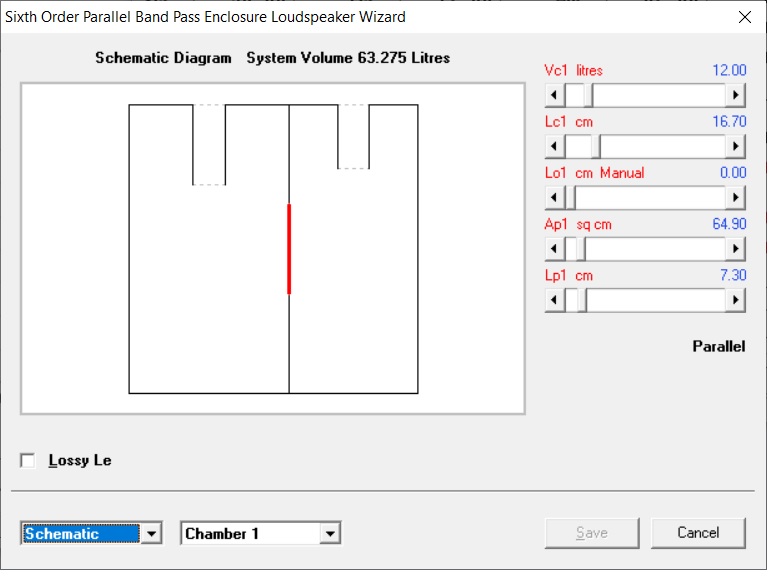

Using 2 woofers in a small closed box will have LF roll off at ~100Hz. So you'll need something to get the LF back. A BP6 can be placed against a wall or corner giving you some flexibility w.r.t location. I used BPx (BP4, BP6, BP8) as generic bandpass n-th order.
Here is a sample from Hornresp using your woofers in 2S2P BP6 series arrangement. You can import the txt file into HornResp if you want to retune the design. You will need your DSP to add subwoofer bandpass filters as well. The woofers are not ideal for this application and will not go to concert levels (Xmax limitation) but should be more than adequate for an apartment to get full sound.

Got it now, thanks again for not only clarifying, but also sending additional data specifically for my components. It's like having someone else doing my homework 🙂
I was not familiar a all with the bandpass enclosure, need to read more about it
Thanks David, you're right it's parallel. It even says it on the diagram 🙂. When I changed the driver config to 2S2P it seems to reassign the BPx config. I just updated Hornresp and this seems to be fixed, so I'll try it again 🙂
@DonVK at this point I'm tempted to send you the drivers and let you build the subwoofer 🙂
I really appreciate you sharing all those designs, it's helping me a to get familiar with a subwoofer configuration I knew nothing about
