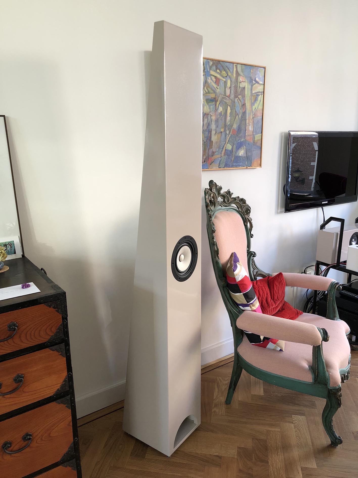

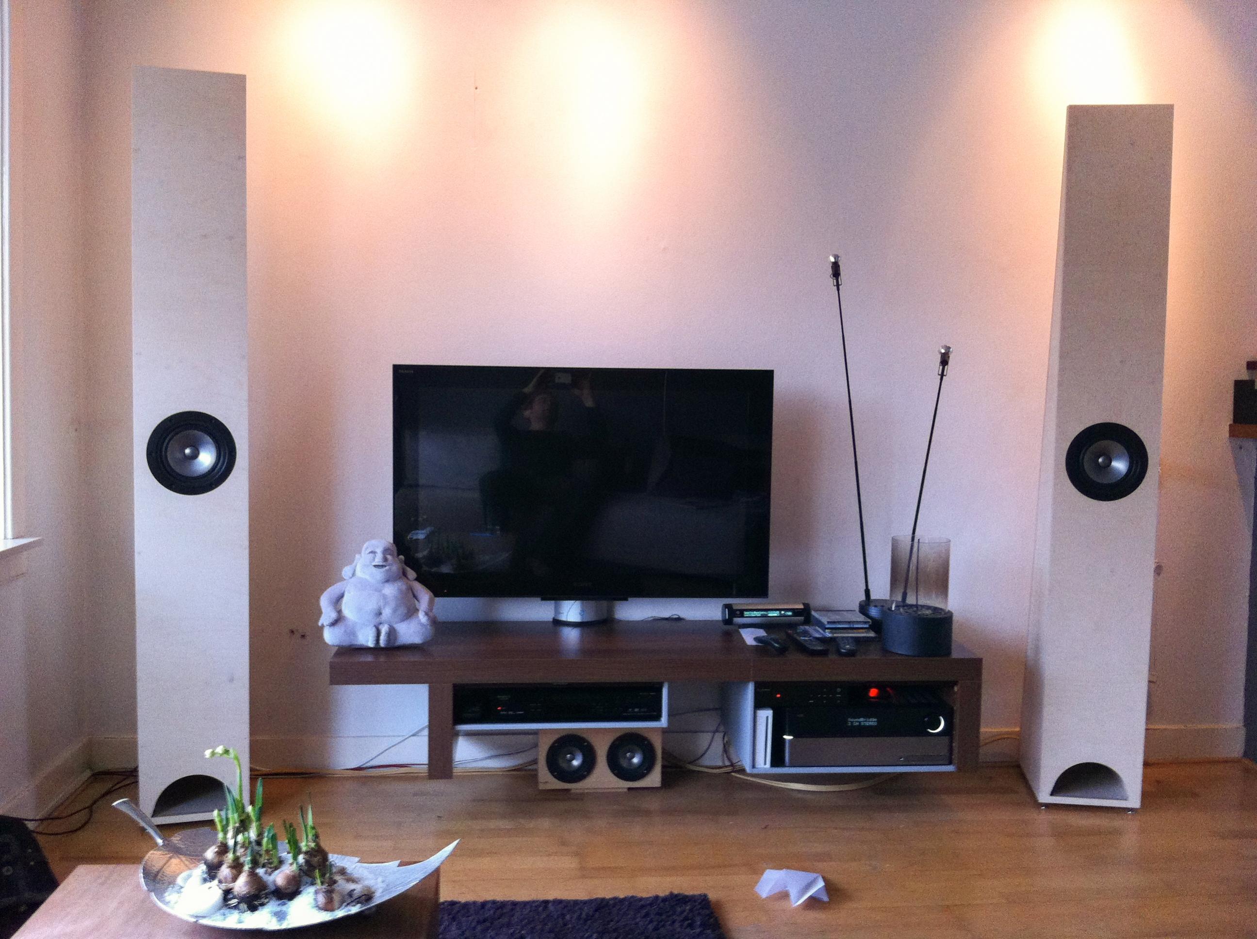

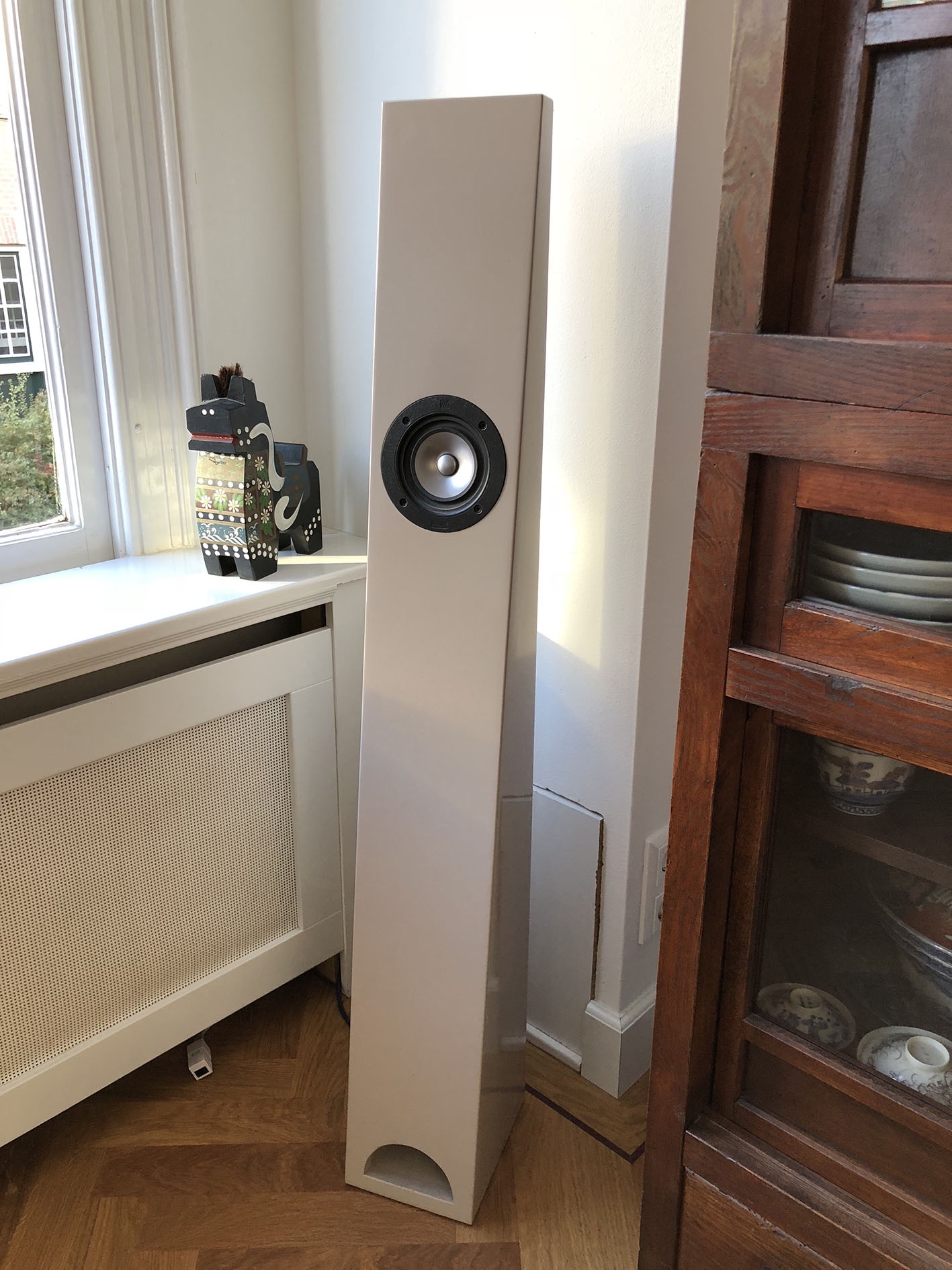

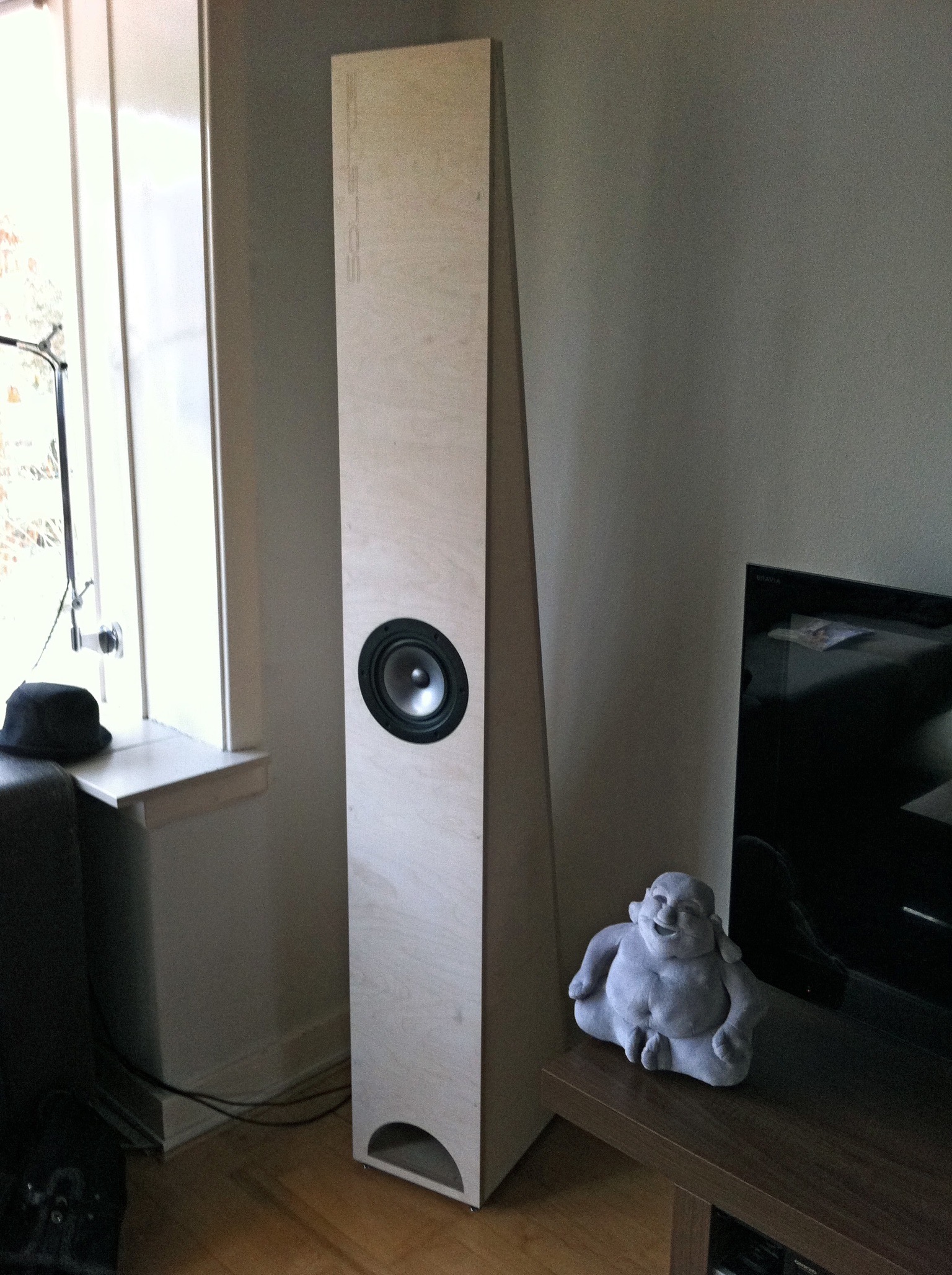

The plywood version was my first Solstice build using the wonderful Alpair 12.
After the release of the even better Alpair 12P I decided to rebuild them for those and sold them to a good friend. Both sets had a door in the back so I could adjust the long hair sheep’s wool damping. When satisfied with the damping I covered the plywood with a 3 mm layer of MDF and had they spray painted in a matching color to the cones color. This color is great, I tones well with the wall behind.
As I use them also for surround purposes too I designed a lookalike Alpair 7.3 rear speaker and a twin Alpair 7.3 center speaker. They all sound amazing but the true winners are of of course the Solstices by Dr. Scott Lindgren!
We are enjoying them every day, big, awesome sounding and beautiful!
Cheers Ingmar
