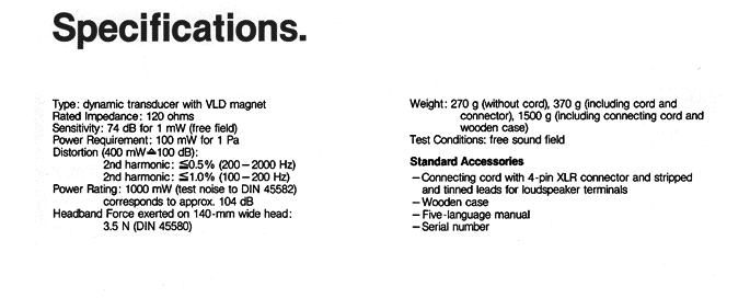

I posted this in the Aleph X thread, but there were no takers, so I will try here. I'm looking for a class A amp that can be biased to deliver it's optimal power into a 120 Ohm load of the AKG K-1000 headphones (head speakers). The manual states that 1 Watt will make it deliver 104 dB SPL at the ear. I don't know how much power my Adcom GFA-555 puts out into the AKG load but the volume knob on my Sony converter is near max at this point with the level switch in the -20dB position and it's not all that loud. These headphones are rather inefficient. The sound while pretty good is still a bit on the bright side. I would love to get something that is optimized to drive 120 Ohm with maybe 5W tops. AKG used to sell a small class A amp specifically designed for the K-1000. Can you tube amp guys think of something that would suit the situation? I'm looking for detailed but not harsh top end and liquid midrange. The bass is not very powerful in the AKGs so a bit of emphasis on low end with good control would most likely help. My Philips SACD-1000 had the round low end I'm looking for before it broke down (now for over two months in service- under warranty!).

Watt you mean? Volts, watts and mW.
I think you mean volts not watts (mW)

Therefore you need 2 volts RMS into a 120 ohm load = 32mW for 104dB SPL.
1 watt into 120 ohms = 11 volts RMS
2 watts into 120 ohms = 15.5 volts RMS
I believe that much voltage/watts would fry your headphones. Headphones are rated in mW (thousandths of a watt), 1000mW = 1W
Most amplifiers run the output signal thru a resistor, 330 ohms or so, to drop the voltage down. CD players and such have a dedicated opamp circuit for that duty.

if you need to double the power for every 3dB of SPL gain then starting with 1mW and doubling it 10 times (30dB gain from 74dB to 104dB) you arrive at 1024mW or just over one Watt.
I screen captured the bit of spec from the K-1000 manual that I was refering to. See attached file.

@ Thunau
I apologize , you were absolutely correct !
My math was off, I was using 6dB instead of 3dB $$***!
I went back and reread the description at AKG's site and they're not headphones, but little spkrs! So I guess you do need that much power. Sorry to everyone for the confusion, which was all on my part!
