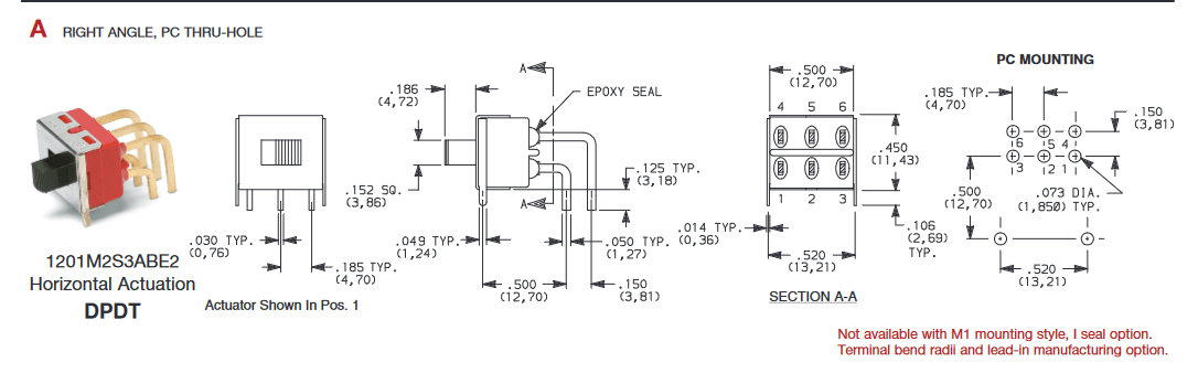

Method21 Member Joined 2024 2024-09-11 10:51 pm #1 2024-09-11 10:51 pm #1 Hi I Have a DD amp C5d, has a couple broken off/on switches. I have searched like crazy with no luck, It's a right angle 2 pos 6 pin 12.7mm width and 4.7mm between pins, through hole. any help will be appreciated. thanks. chrisng Member Joined 2015 2024-09-12 4:26 am #2 2024-09-12 4:26 am #2 Something like this? Can you post photo of the switch? Reactions: stv Method21 Member Joined 2024 2024-09-12 9:10 am #3 2024-09-12 9:10 am #3 Thanks for your response, I ended up getting help through Digikey and found the right one. You must log in or register to reply here. Share: Facebook X (Twitter) LinkedIn Reddit Pinterest Tumblr WhatsApp Email Link
