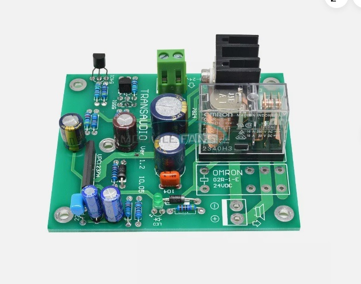

Just jumper the bridges on either the 12V BJT kit , or (below 2) , the uPC1237 24V omron kit.
First kit will run ac-dc 16-35V , second kit will run 27-37V. LM7824 will run up to 40V.
I'm using both kits. Second kit has current protect tap , goes on one amp emitter resistor.
Only 7-15$ for complete kits. I swap the caps out with panasonic/nichicon's.
OS

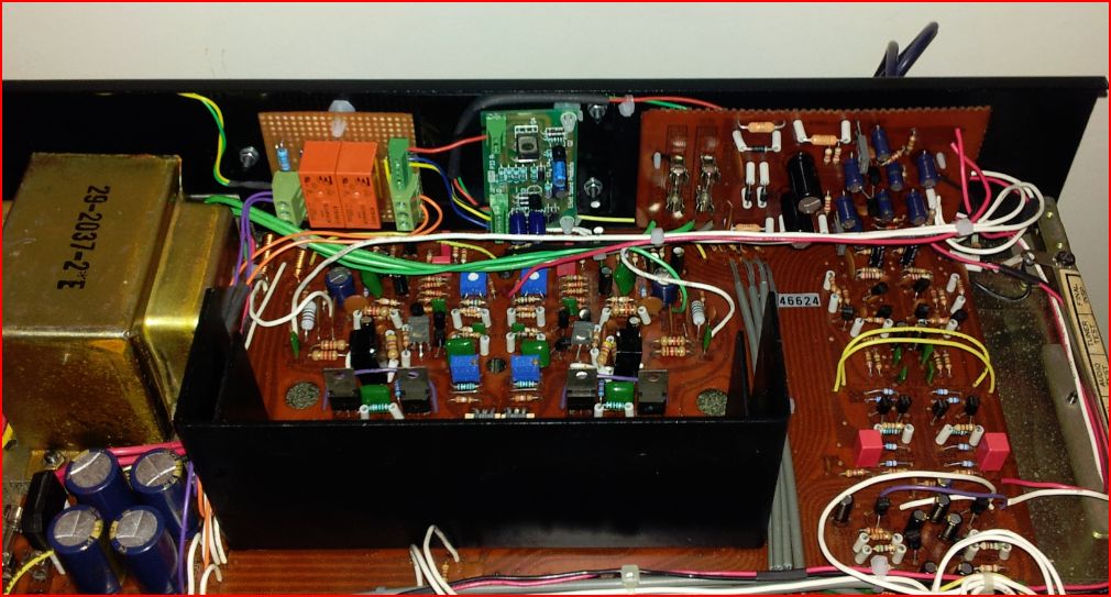

The biggest 'problem' adding a protection pcb to the 3020 is simply finding a pcb / relay arrangement to fit the available space in the amp - but it's certainly possible. I added one to a 3020 a few years ago when I was just starting out with diy audio, using one of Rod Elliotts 'Project 33' pcbs + a couple of TE (RTD14012) sealed relays. It's not the most elegant by any means (I never did get back to tidying it up...), but it still works fine. 10 years later and I'd probably use a similar circuit but with solid-state relays, just as a smaller option.
I've looked at the diyaudio shop option, for more recent projects, but I can't bring myself to paying £37 ($48+) for the bare pcb. The additional shipping costs to UK are simply prohibitive, I suspect for many UK members.
