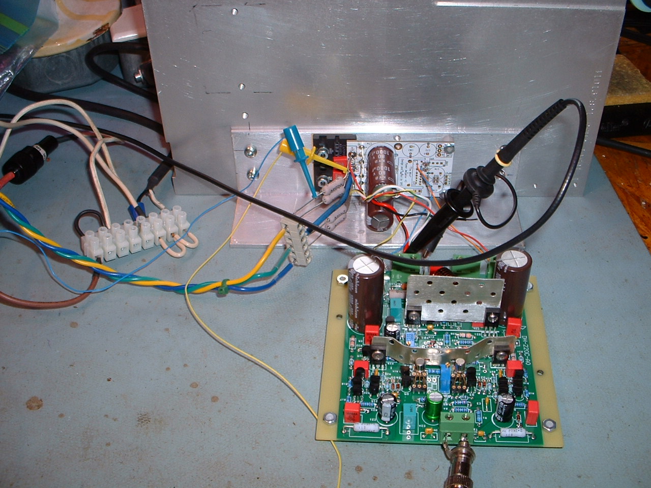

In Bob Cordell's new book, he has a chapter devoted to the design of a power amplifier that meets your stated requirements. I have done up the circuit boards for that design.
With Bob's permission, blessings & after the book is released, I can offer the design for sale as in, the pcb's, full set of doc's, a link to a Mouser shopping cart to buy the parts. The bigger challenge is the mechanical design.
I also did up Bob's DH-220C Hafler re-design this winter. You can use that with your own lateral fets (as I did) if you do not have a Hafler chassis. It is more expensive due to the fet premiums.
