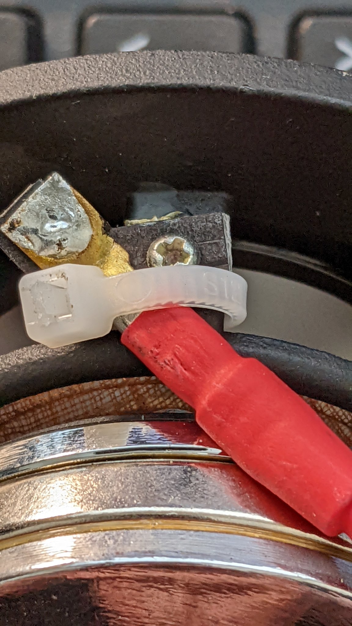

Looking for a miniature speaker solder tab.
As the title says, I am looking for a very tiny speaker solder tab that is used on the Audible Physics RAM 2 driver. I know it's a shot in the dark but I figured this global community may know the supplier and point me in the right direction.
These are tiny.. 1/8" terminals...
Thank you in advance!

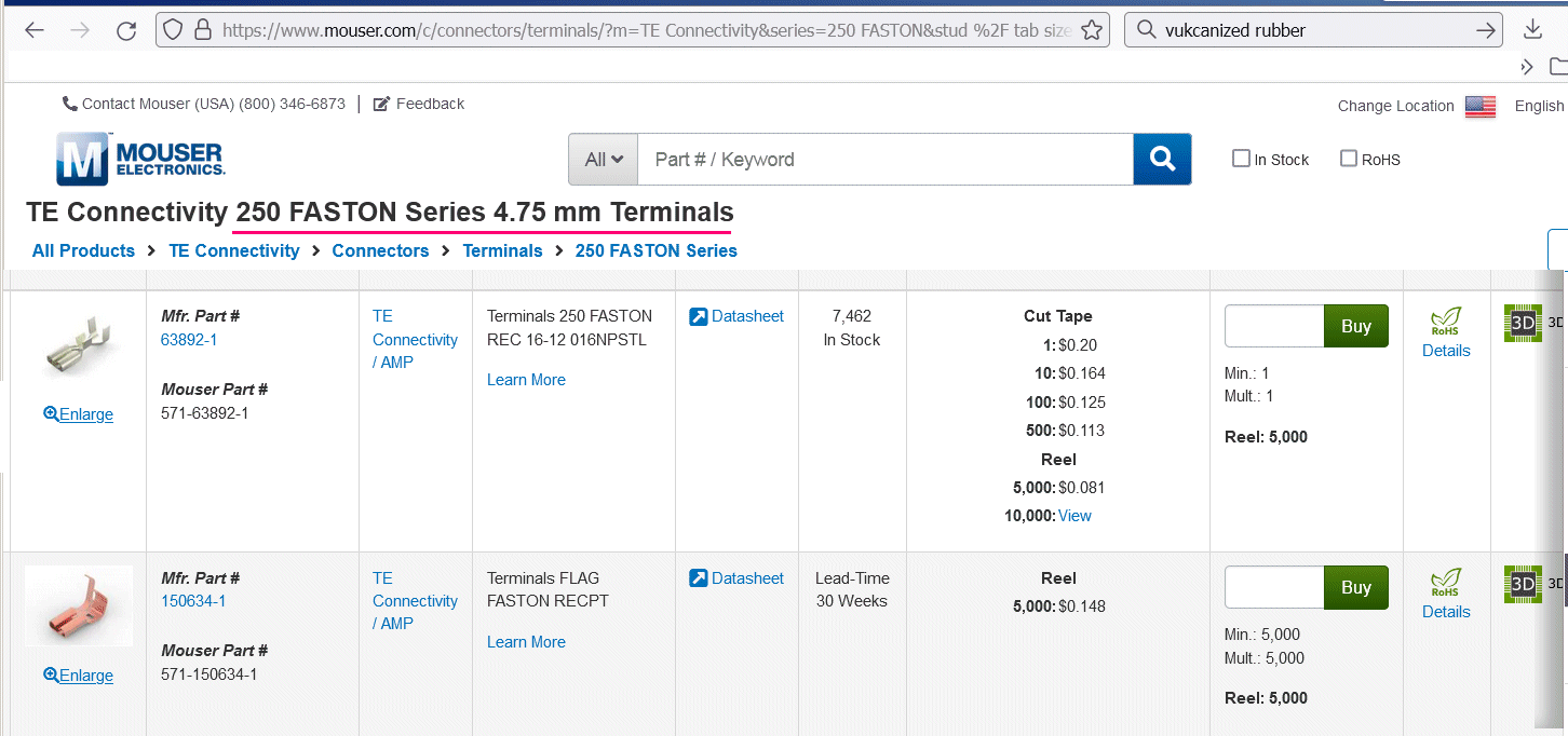

Mouser. "250 FASTON Series", sizes from 1.57mm to over 6.35mm. There is also a thickness on those tabs, and sometimes two thicknesses for the same width. A metric caliper may be wise. Altho at 20 cents each you could order two of every size just to make a minimum order.
