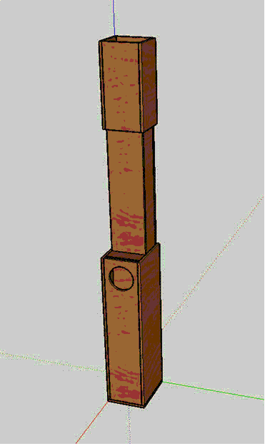

Always liked the looks of the one that looks kinda like a Fletcher system, but open in front.
And I've always wondered how those dual blh systems would work, tuned slightly apart to spread the FR...
Never built one though.
Don't know what a 'nessie' is, but I do know about staggered vents in a common Vb, at least typical PVC or cardboard tube ones and if you spread them too far apart tuning wise, the short one will dominate same as mis-matched drivers in a common Vb where the higher Fs one will provide almost all the output until it grenades. This is why in prosound apps they tend to either use push-pull layouts to average out non-linearities and/or separately tuned cabs for each driver.
GM
Here be monsters... 😉
The Nessie's were one of Nagaoka's specials (although I imagine someone else had done something similar before, given that there's not much new under the sun). Twin constant cross-section resonant tubes basically, the longer rear one larger than the front.
