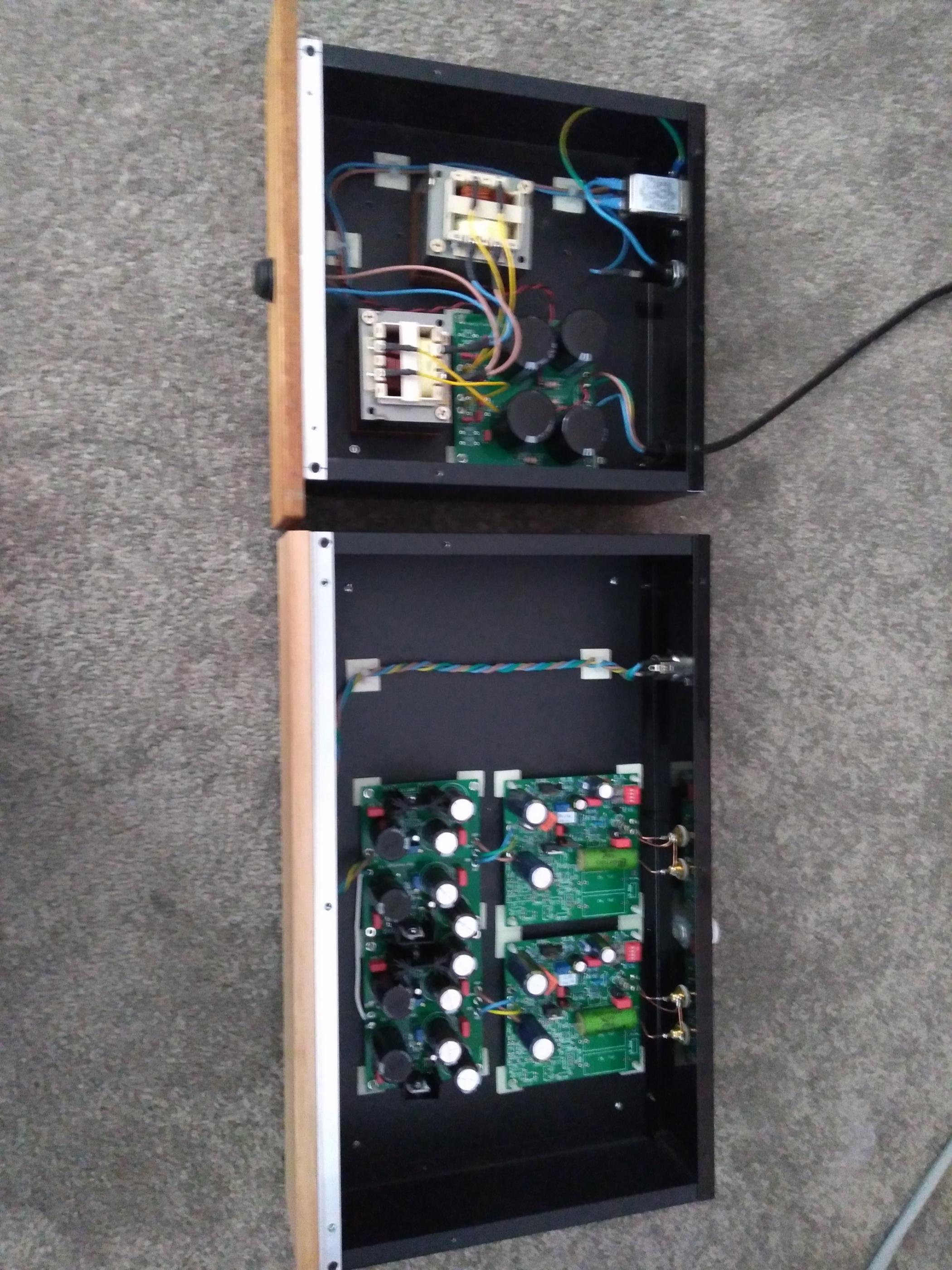

I will finish building the Xono. As I said I bought the loaded PCB's for less than I could buy the bare boards and components.
I appreciate everyone's input thanks.
Built the Xono and WOW, this is a seriously good phono stage. If anyone is interested I bought it from Frank Wilker, he has an eBay listing but I bought it directly. He was easy to deal with and I received exactly what I was expecting. I would definitely recommend him if anyone is interested in Xono PCB's

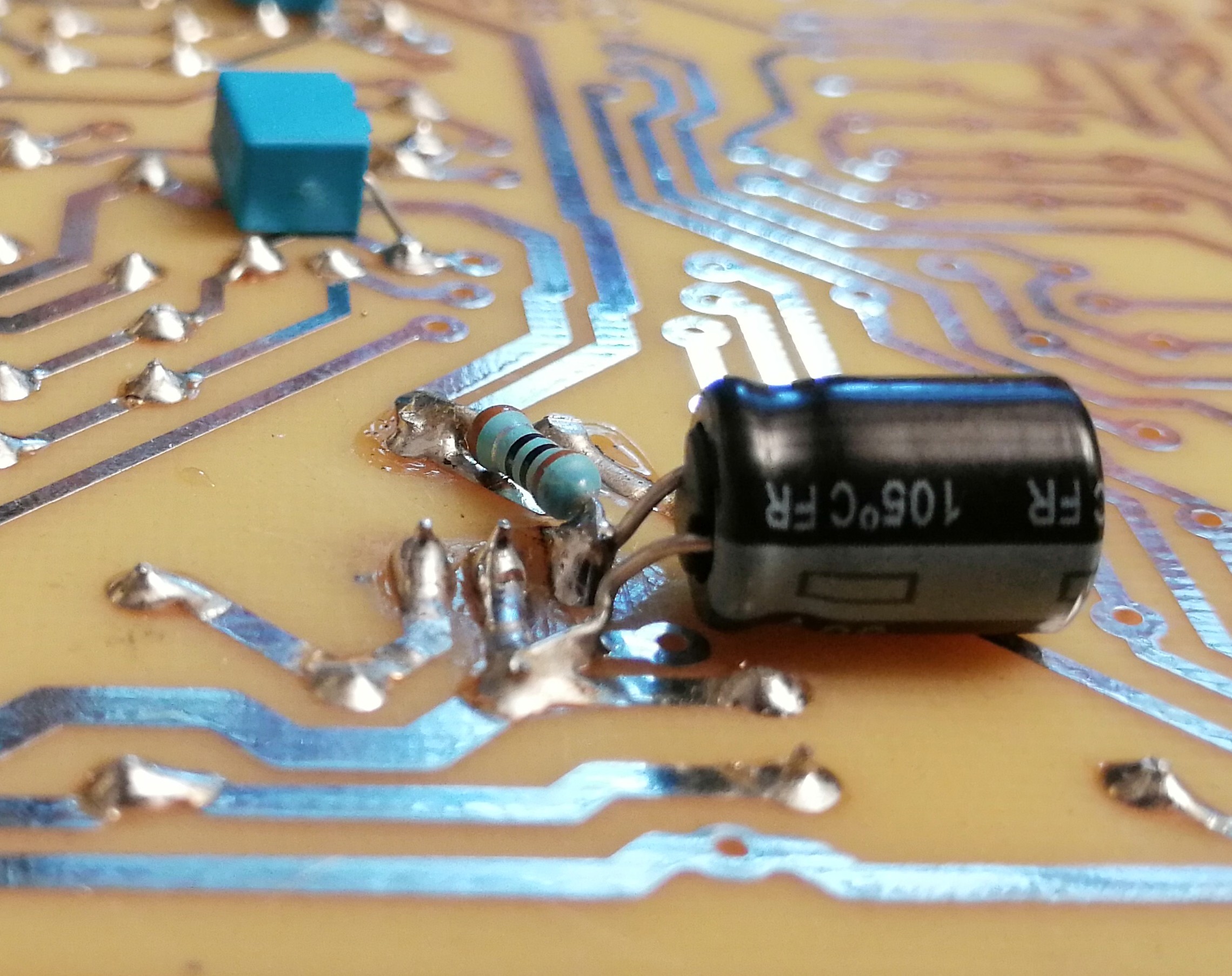

I've only gone semi-diy. I have a Graham Slee Reflex M. Rather than using the psu1 from Slee I built my own linear supply with higher quality components and a CRCRC filter. With the green plugtop power supply the sound could be a tiny bit thin and uninvolving. The addition of the linear supply completely transformed the sound putting the meat on the bones of the music. The final tweek that actually made even more difference than the linear supply was to swap out the reflex's voltage regulator for a sparkoslabs discreet regulator. I'm contemplating rebuilding/cloning the Slee as a full dual mono with a separate power supply for each channel and possibly the addition of an output buffer, possibly Pass B1. I've got several other projects in the pipeline and I'm more than happy with the phono stage as it is so probably won't get around to further tweeking anytime soon.

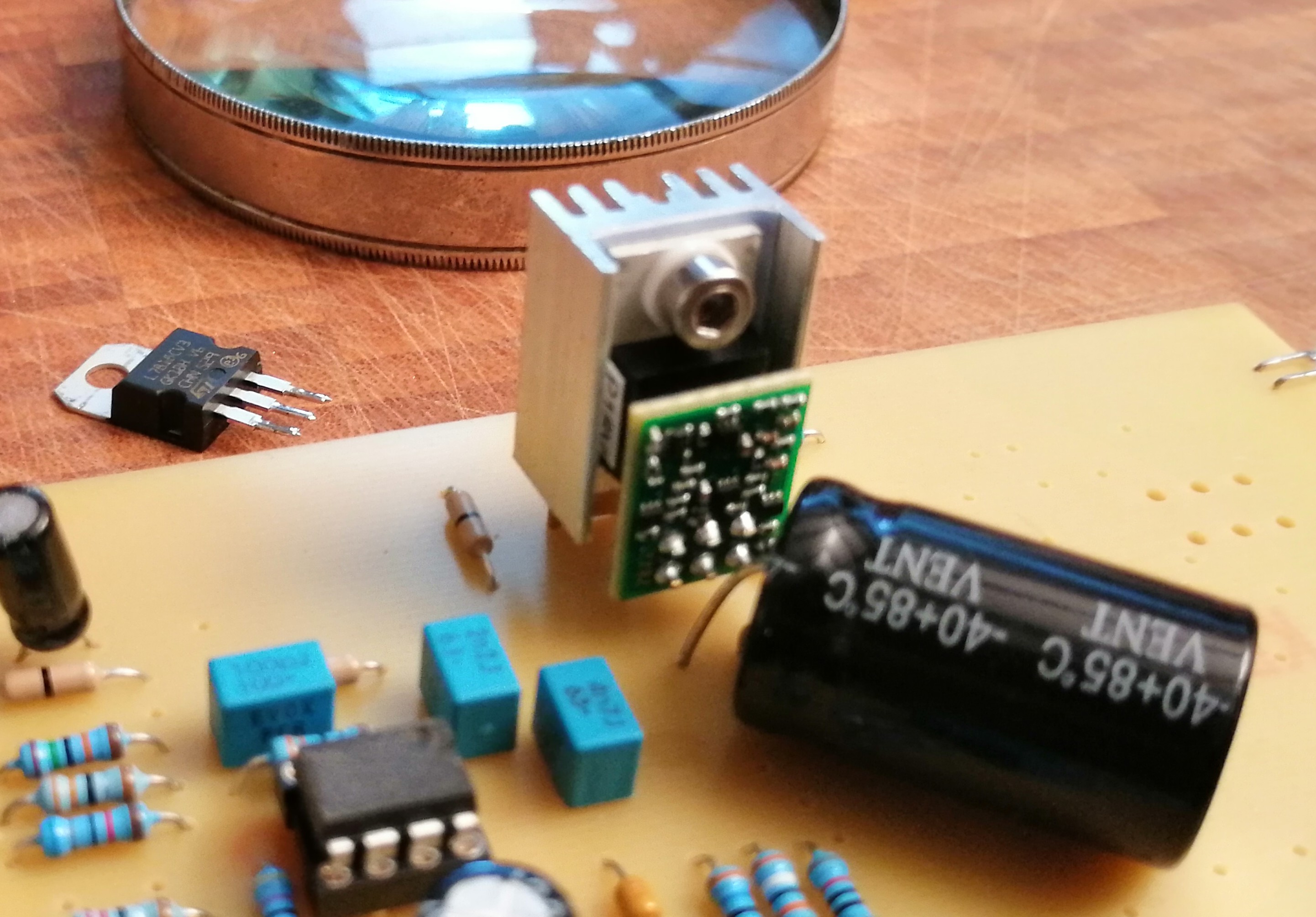

Curious Niffy -- is the process to upgrade the Reflex voltage regulators documented anywhere? I also built my own alternative to the PSU1 (in my case an amb Sigma11)
Hi jphabc54,
The voltage regulator in the reflex M is a standard to220 package and the sparkoslabs is a drop in replacement. Sparkoslabs do recommend a specific Panasonic low esr capacitor be fitted across the output as close to the device as possible. The exact model is specified in the spec sheet on their website. I mounted the Panasonic on the underside of the board. I also added a heatsink.
The sparkoslabs documentation is comprehensive but easy to follow and has all the information you need. If you do have any questions Mr Sparko himself will happily help. Plus he is honest. I enquired about adding one of his products in a different place and he said straight up not to bother as it wouldn't make much difference even though this cost him a possible sale. The Graham Slee requires an 18 volt positive rectifier. It took less than half an hour to fit.
