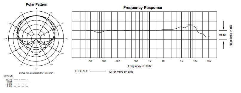

Been a long time since I've bought microphones, but I found the Audio Technica Pro 37 cardioid electret microphone to work well for a wide variety of instruments, at a decent price for good sound.
It's small size makes it convenient for getting in and around drums.
It's proximity effect boosts at much lower frequency than most dynamic mics, so close miking drums requires less EQ to sound "huge", while it has fairly flat response (other than the 5-10kHz "presence peak")when at a distance of 12" or more.
Has a maximum sound pressure of 141dB, which can be exceeded if placed in a kick drum hole, but have not heard them clip on any other instrument.
