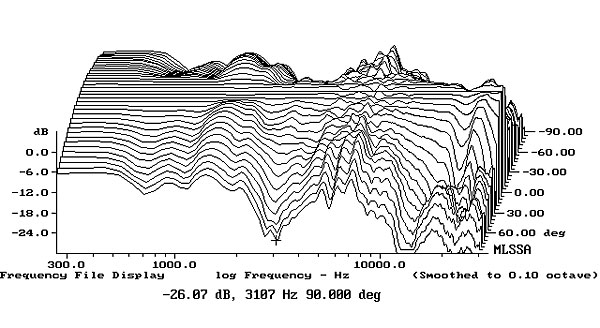

Stereophile has measured som Spendors and Harbeth 3-ways
This is directivity of Spendor Classic SP100R2 (looks like LR4 xo by step response)
and this is Harbeth HL5 (looks like LR4 too)
Most 2-ways nowdays are crossed around 2kHz, which means that tweeter gives wide dispersion around 3kHz, while a 3-way with usually higher xo and smaller mid diameter have bloominig around 4-5kHz.

The region you are talking about is the result from mismatch in directivity between drivers ( evident in both the Spendor graph). The gooseneck you see surounding the area is the place where the filtering take place. This is the result of different drivers diameters having different directivity (the larger drivers start to beam lower in frequency) and center to center length being superior than 1/4 the wavelength at xover freq.
This is typical from 'regular' threeway layout (WMT) and in my opinion this is an artefact which is not nice at all ( in fact this is what i've tried to escape from with my own main which are WMT layout).
I tried to mitigate the effect using a Linkwitz transform on medium (which is closed box loaded- to lower the xover point which initially was 750hz to 500hz for a 15" to 3") and FIR xover to extend bandwidth of mid and have higher xover point ( from 4,5k to 6k- outside the critical frequency range ( also known as inteligibility range :300hz/6khz)of our hearing). Fir xover steep slope help in that it make approaching cone breakup less of an issue.
Overall i prefer the rendering with this setting but the loudspeaker still have a gooseneck in the 500hz freq range and i had to accept the loss of 6db max spl.
I still prefer 3ways to 2ways but now i target to diy a speaker design solving this gooseneck issue ( not even power transfer to the room, unbalanced power response).

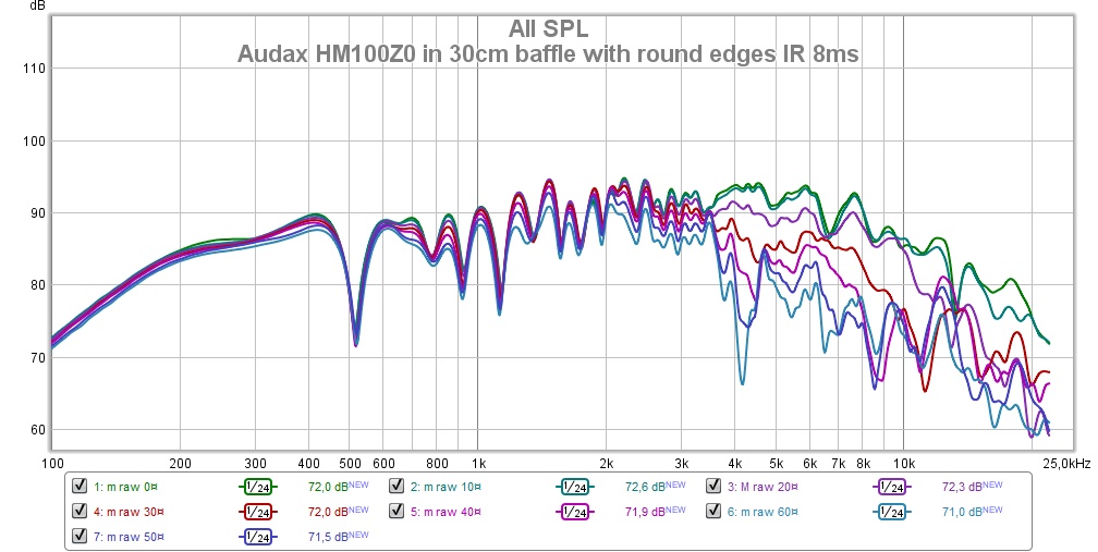

Audax is available in Europe, but sparsely. This is my HM100Z0 in 30cm baffle, no eq or xo. Dip at 510Hz is reflection or internal standing wave.
