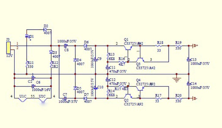

I also have already shown through an eBay link in a previous post what the circuit looks like, it is just this one circuit and I would be adding a transformer to it, nothing else. I am doing my best to "lay all my cards". This circuit will be powered by a 30VA transformer. They will both go into an enclosure and I am looking to protect this by adding either or both a primary or secondary fuse.

huh Im still not following what your doing. your link was just for transformer? you keep talking about a tube buffer? now your schematic above simply shows an unregulated +/- 30 VDC power supply ...show us the rest.

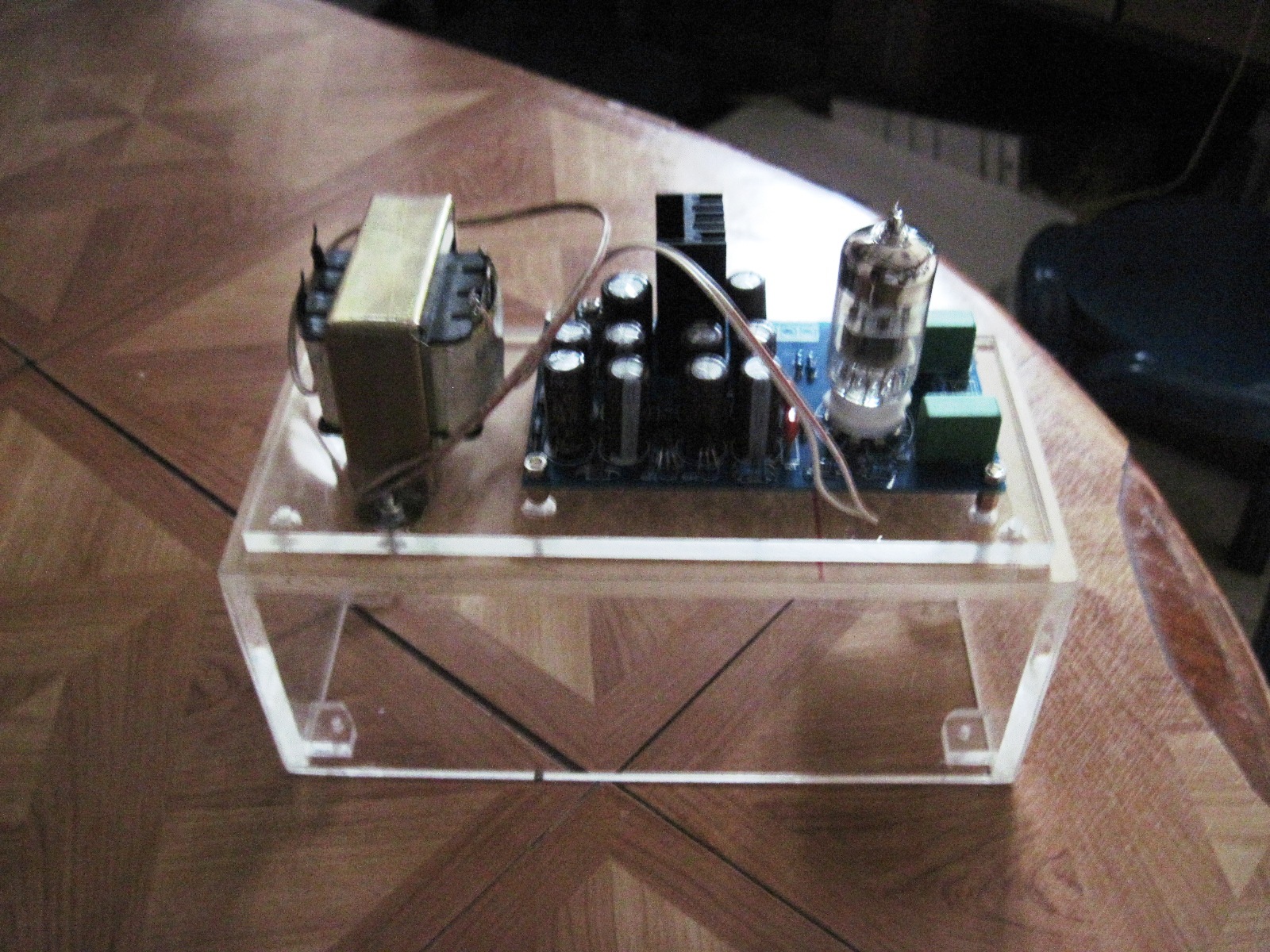

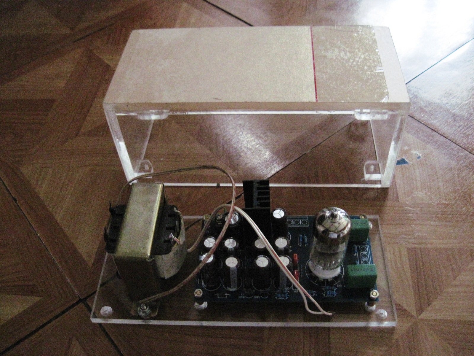

see below pictures of my build..

OK, so we have a "tube buffer", probably a cathode follower, with tube plate connected to some +25V , tube cathode resistor tied to some -25V , adding its tube magic, whatever that means.
There's not elbow space for much else, if any at all, and in any case a regular tube with meager 25V plate to cathode can't do much anyway, even as cathode follower.
Talk about starved tube !!!!!!!

Infinia - This is the only schematic that I have which is of the circuit, I did have one other one for how the tubes linked up but I ended up deleting it thinking he may have not send the correct one.
