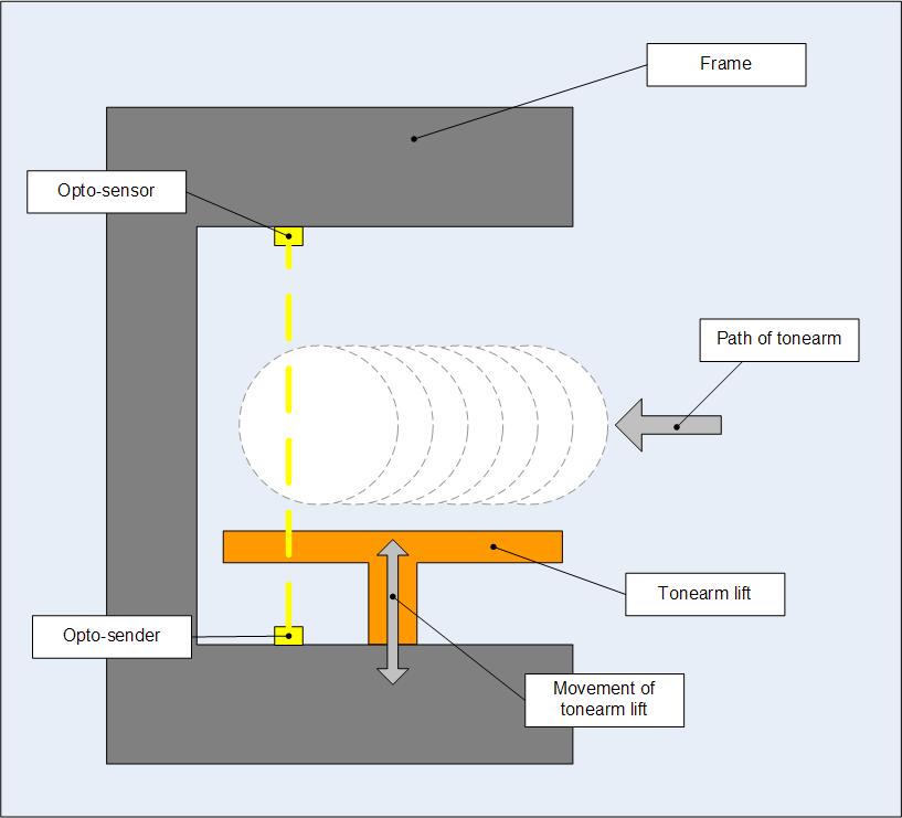

I have fantasized about, but never built nor even properly designed, a lift which would use an optical sensor to trigger a (hydraulic? magnetic?) lift arm - see the drawing, which shows a plan view. Ideally, I suppose, a second optical sensor mounted towards the outside would reset the lift to its lowest point when you moved the arm back out.

Agreed, not the fault of the mechanism, but frustrating nonetheless. The real issue, I suppose, is whether the geometry of one's particular table and arm allow positioning the Stylift far enough away from the arm pivot that the arm has significant lateral motion at the Stylift. Ideally suited to 12" arms, perhaps?
On looking at my previous post, even two edits were apparently insufficient. I meant to say that the drawing showed an elevation, not a plan view.

I once had a similar plan, and some nice "reflector"-sensors, that did not need the big pillar...
(The sensors came from an old copy-machine, for detecting paper).
And the lift could drop as soon as the arm was taken out of the zone...
Arne K

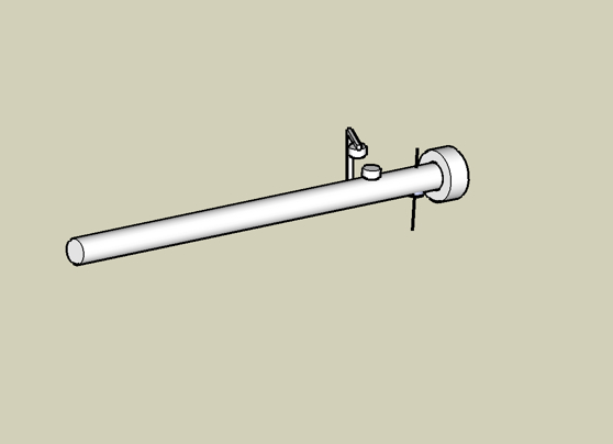

Something I have been thinking about for a while now.

I've seen something similar tried. The problem is that as soon as the magnet on the tonearm starts to get within range of the stationary magnet, it starts to lift and drag the tonearm across the remaining grooves - an ugly sight (and sound). I suppose one could interpose shielding material to make the magnetic connection wait until everything was almost aligned, but it seems it would be tricky.

seems if some use magnets as a means for anti-skating, couldn't one use magnets for a lift?

obviously I was thinking about having the ability to adjust the distance between the magnets (and also trying varying strengths of them). It may work, it may not but may be worth a try. If magnets can be used to adjust anti-skating, why couldn't they be used as a lift.? Again, this is only an idea.

Yep, not saying it can't be made to work. Just that the implementation I saw clearly demonstrated that dragging the arm laterally was a problem that would have to be overcome.
I suppose one could adapt the optical device I proposed earlier to trigger a lever that moves the magnet within range once the stylus is in the run-out grooves. But as you say, it may be possible just by carefully tuning magnet strength and distance.
