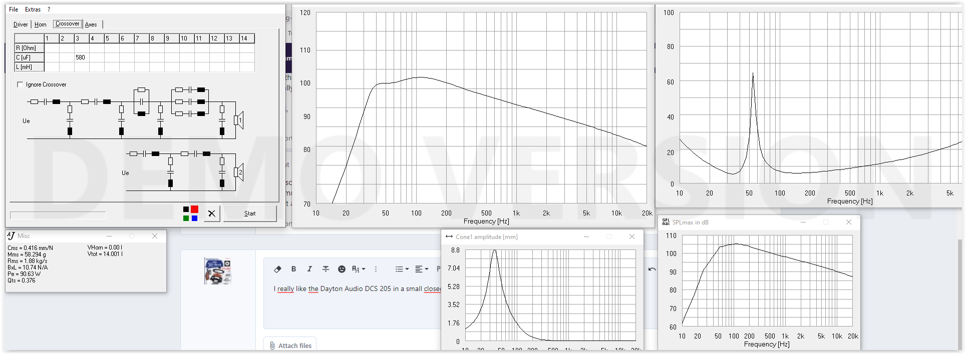

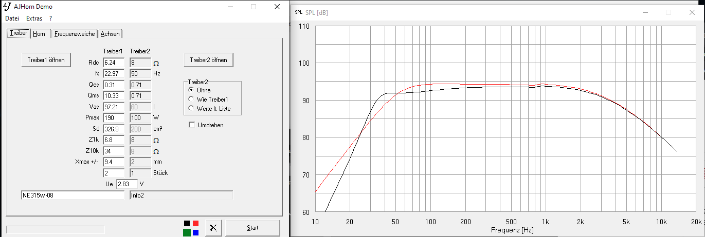

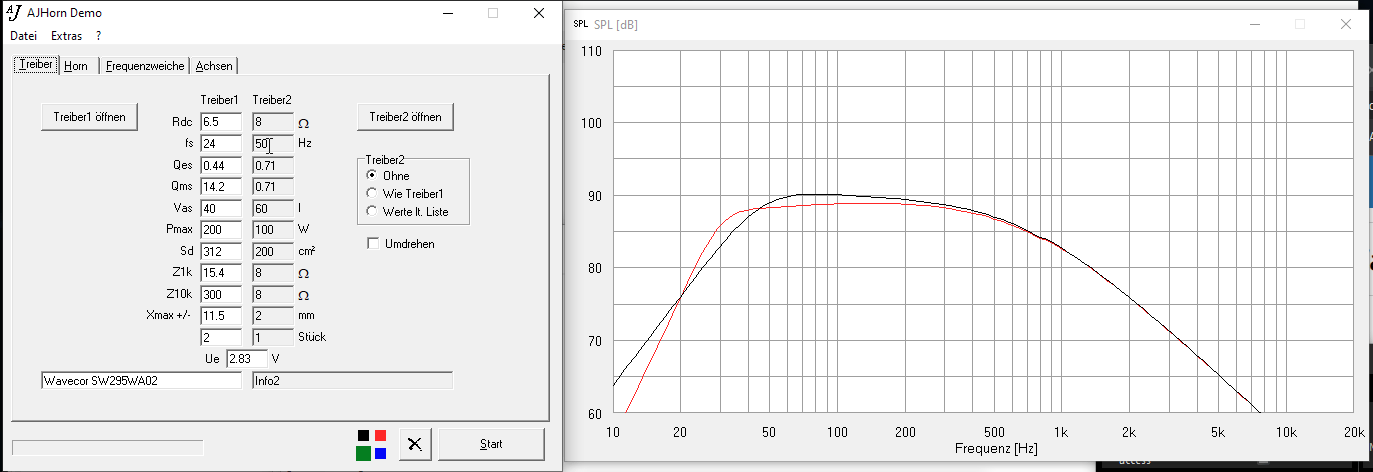

I've looked at many drivers now and it's actually not that easy for me to find a 10" model that is rated at 8 Ohms and will work good enough in smallish enclosure. Space wise, I was hoping to get by with 30 liters or less. With 60l or so, things would be easier.
The SB SW26DAC76-8 (in a 2x 10" push-push setup with a HPF at ~1900µF looks most promising). The Peerless XLS-P830452 was also looking good but it only comes in a 4 Ohm version so I'd have to connect the pair in series which I gues I should avoid...
This is how I think it might look like. 45x45x26 cm with a separate chamber for the amp module. Vb = 28 liters...

Nice! I would suggest to seperate the woofers from each other. Thiele small Parameters are never exactly the same. With two seperate enclosures for the woofers, these small TSP diferrences will not effect the sound quality. Tolerances of 1 to 5% are quite normal between pairs.

When I put the drivers in separate enclosures, I'd be loosing the push-push effect of "impulse compensation", wouldn't I?
If they are opposed-mounted on either side of the enclosure, operating with same electrical phase but opposed motionally, then an internal partition matters not in terms of opposed forces being cancelled. It would only serve to isolate the drivers and brace the cabinet.

If you're still considering driver options, the seas l26roy is a 10" sub that goes in a small enclosure (40 litres) with an f3 in the 20s

It seems these only come in a 4-Ohms version. For connecting them in parallel in a push-push configuration, that would yield too low of an impedance so I‘d have to wire them in series which is not ideal unfortunately…
