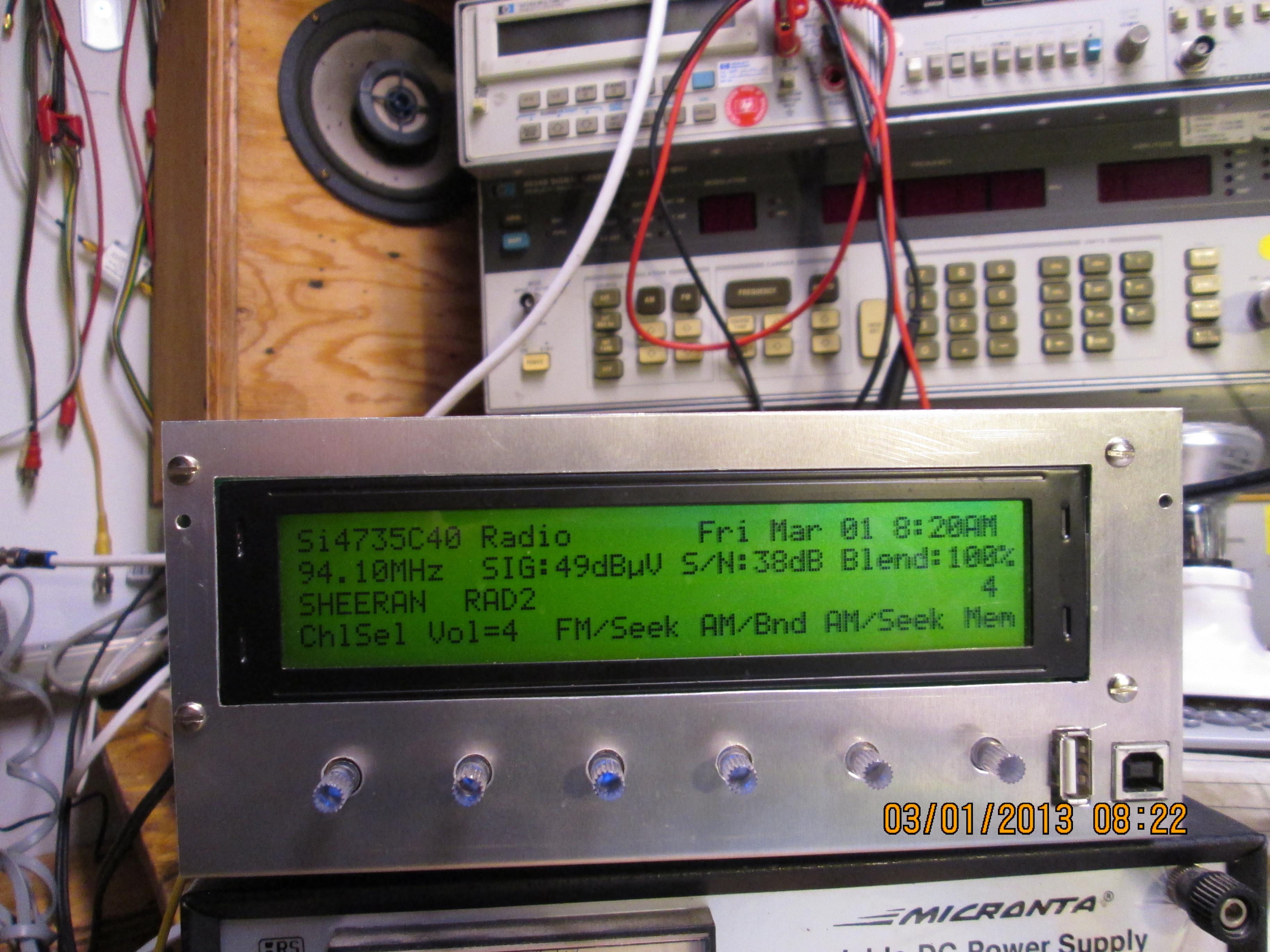

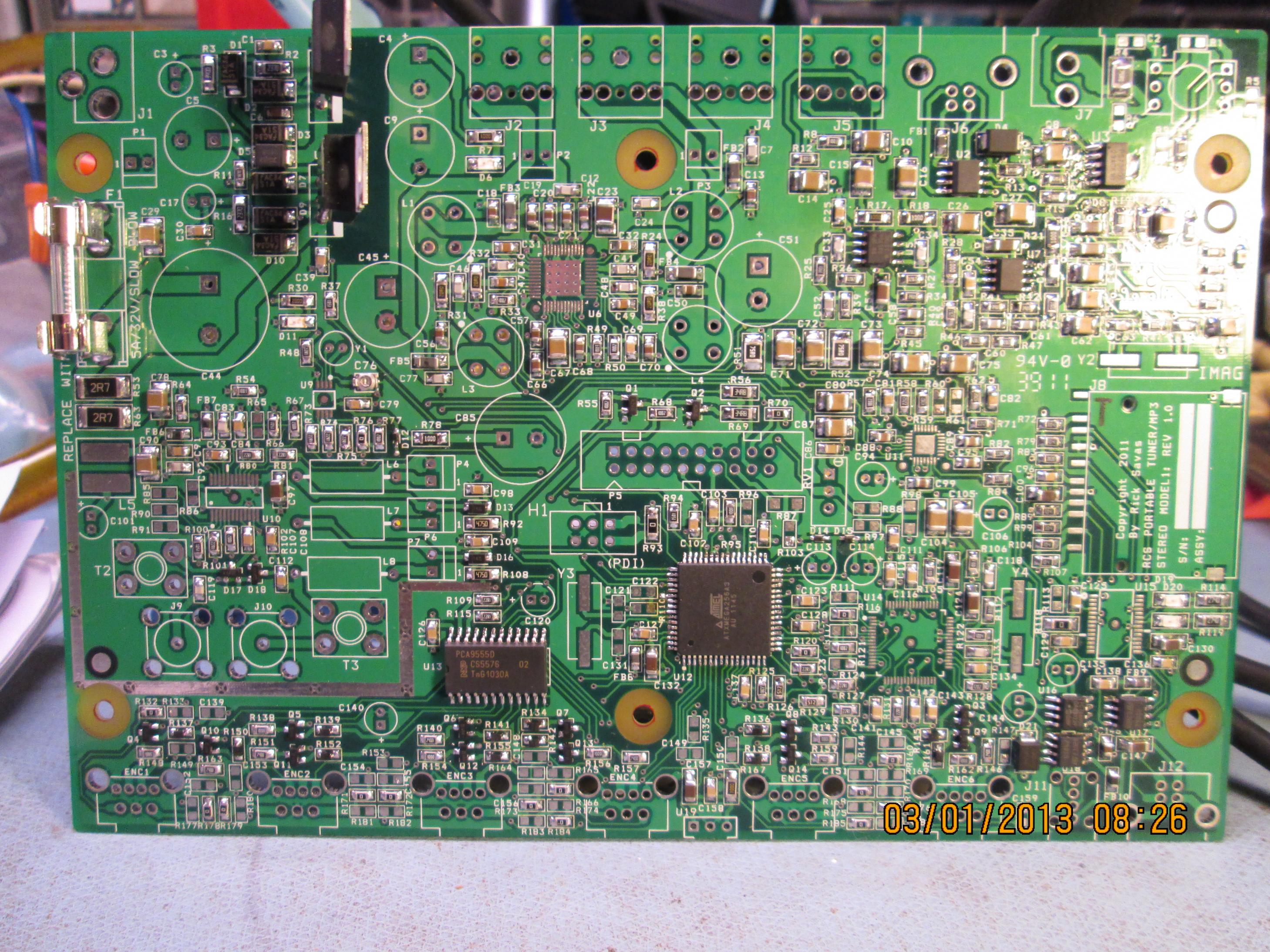

As a comparison, this is what I built, it is 25W/ch, drives 4 ohms just fine.
I call it a Portable Media Player/Radio
Si4735 radio
BU9458 USB/SD memory stick player
PCM2902B USB Codec(ext PC Sound card)
TPA3100D2 class "D" amp, does not run off USB power!!
MAX9729 pre-amp/headphone amp
The mechanics are not fine tuned, but you can always do better.
The amp kit referenced 'GT-101' is a good deal however.Looks to be Class "AB", and I see modules, certainly not discrete, can't be sure what they are.
Rick
