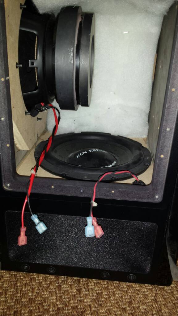

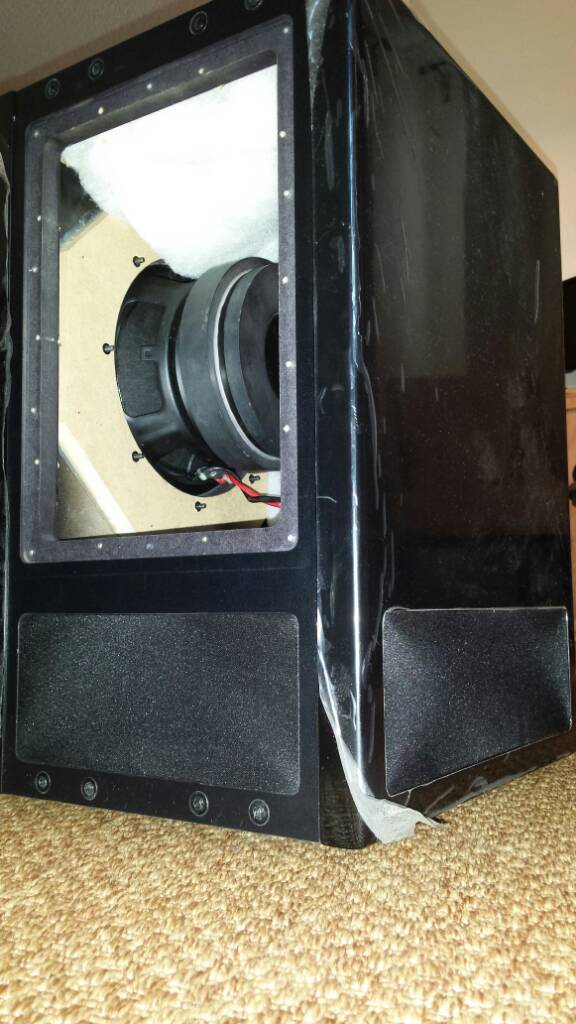

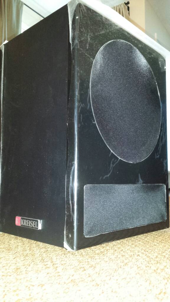

Picked this up from Steve at apexjr.com and it has 2x 4 ohm woofers and I am trying not to have to put them in series.

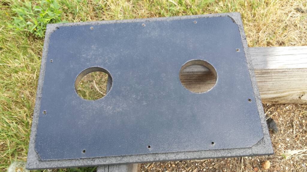

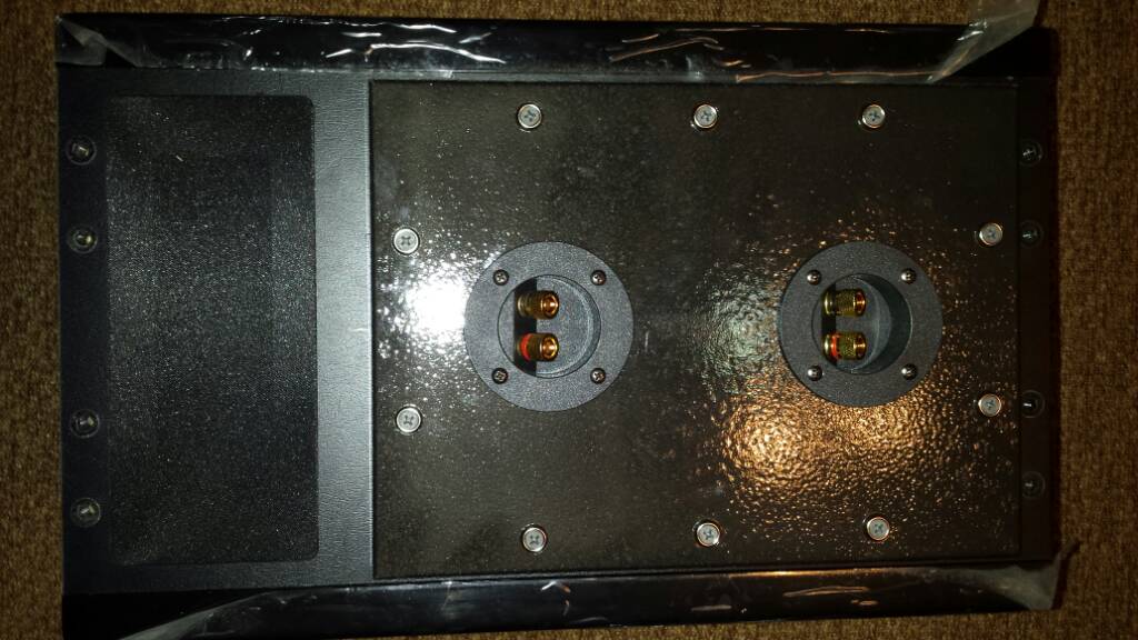

I made a back plate to use it passively until I find the right amp and then I will have an aluminum rear plate made with per input, amp and rca connector.
Yes that is the protective wrap still on the enclosure!!!
Why not?
It will work exactly the same (I guess both speakers are same tpe and model) and it will simplify your task enormously.

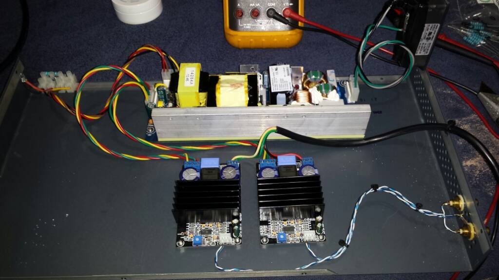

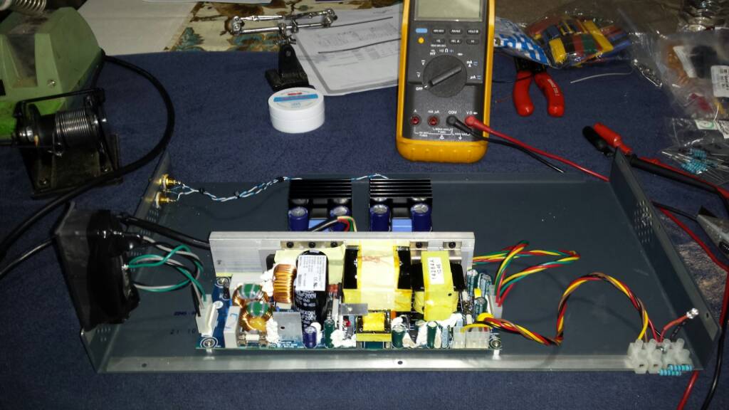

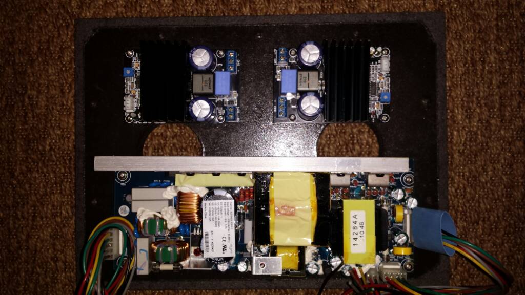

I went rummage through the garage and I found some amps I bought a while ago.
200 into 4 ohms and a 500W power supply. So I will see if I can put one amp on each driver.
I was hoping for an all in one unit to make the aluminum cnc work less involved but it's looking like a 3 pcb solution.
