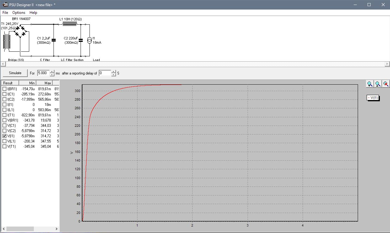

I have problems with my tx to reach B+ 300VDC 18mA, how can be changed the schematic for less B+ reaching the 18mA?
TIA
Felipe
TIA
Felipe

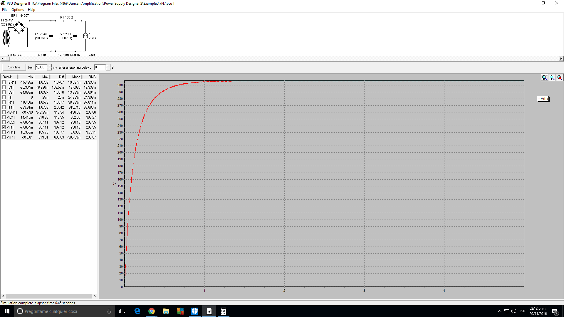

It seems my transformer can be enough for B+ 300VDC 18mA
No.I'm doing well the simulation for the psu?
With just a 1R resistor you won't have much filtering.
Do you know how easy it is to try something yourself in PSUD?
Just type in a different value and see for yourself how you arrive at the 300V or whatever you need.
Or change the topology. Replace the choke with a resistor... and what do you get?
Please sit down and try for yourself instead of constantly asking people for the easiest things.
Please sit down and try for yourself instead of constantly asking people for the easiest things. 😉

How much supply voltage do you have available ?

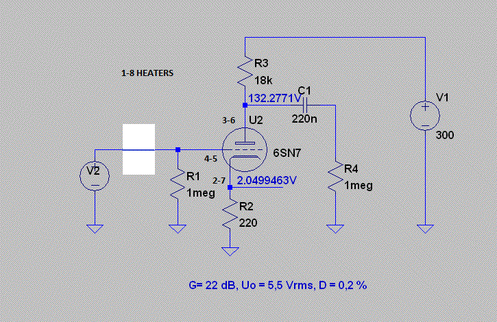

Here is one example:
What's the output impedance?
About 7kΩ.
I will use DC heaters is the same pin1 positive and pin8 ground or v.v.?
No difference.
How can lower the output impedance and increase the gain?
A cathode bypass cap would do both of these things.
