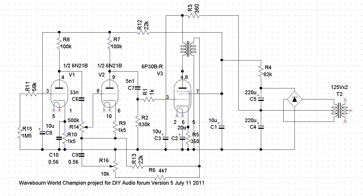

@Wavebourn Thanks for sharing that schematic of your amp! If there was more information I'd probably throw one together myself :D

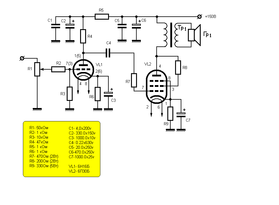

@Koonw The simpicity of this SE schematic is a good place to start. I'm not sure if it's verified nor do I know what wattage resistors to use so I'm not frying things. Also it doesn't show the rated primary impedance of the output transformer. I'd like to find something with tone controls but I don't see too many hifi amp schematics with these options.

By looking at the other schematic, about 5mA for R4=47k Wattage=I*I*R=0.005*0.005*47000=1.175W, use 2W for R4. R6=0.005*0.005*1000=0.25W.
About 30mA for R9=330 Wattage=0.03*0.03*330=0.29W, use 1W for R9.
The rest can use 1/4W to 1W.

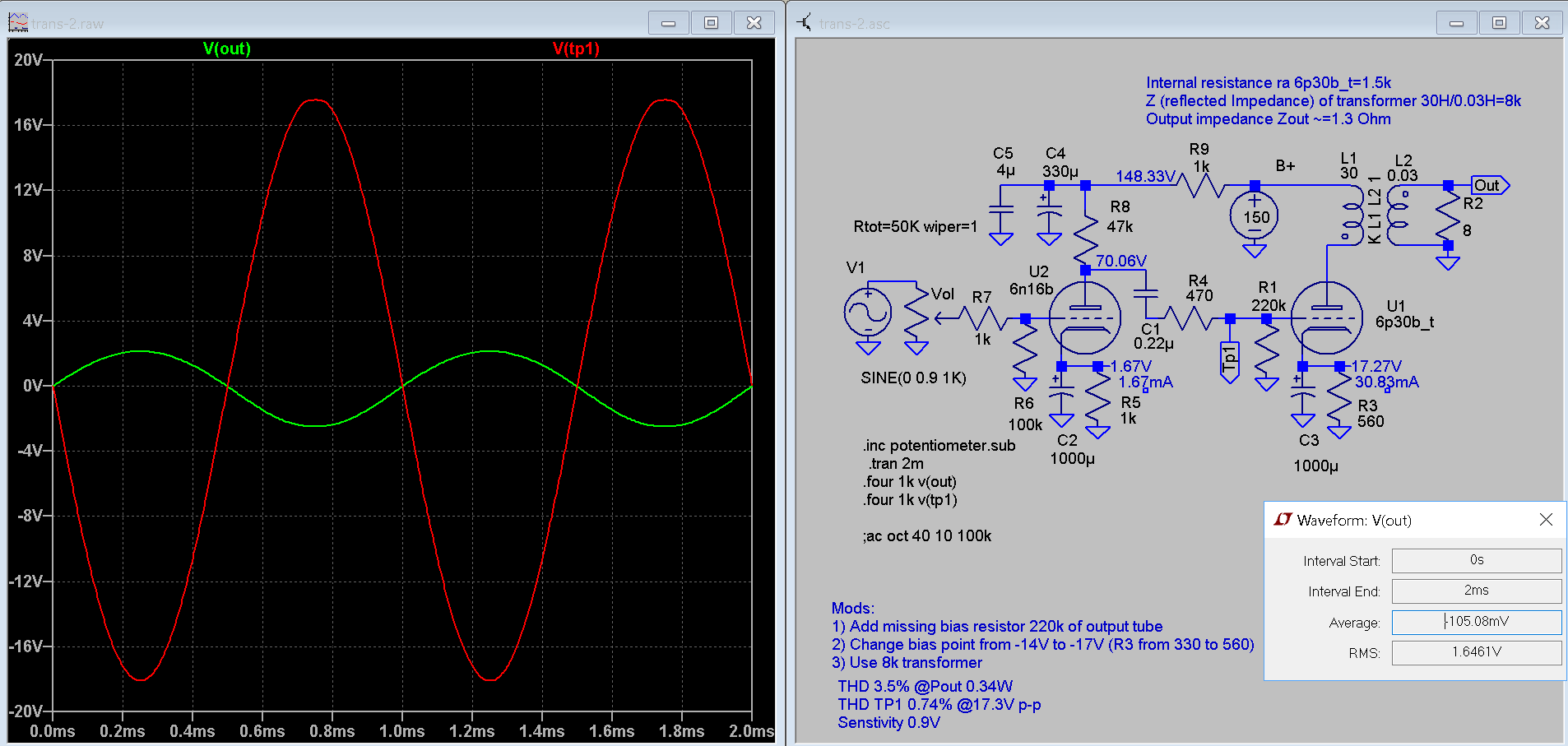

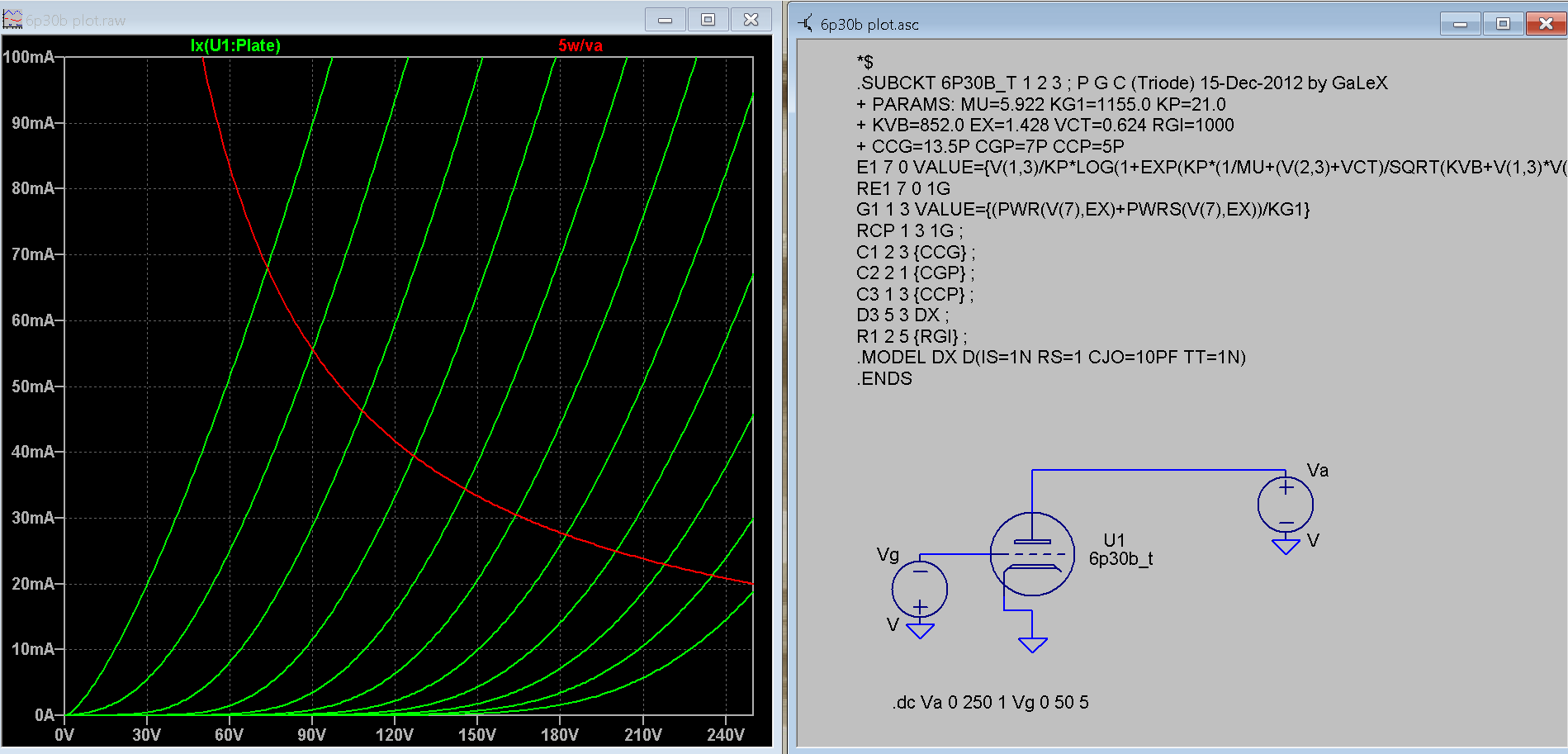

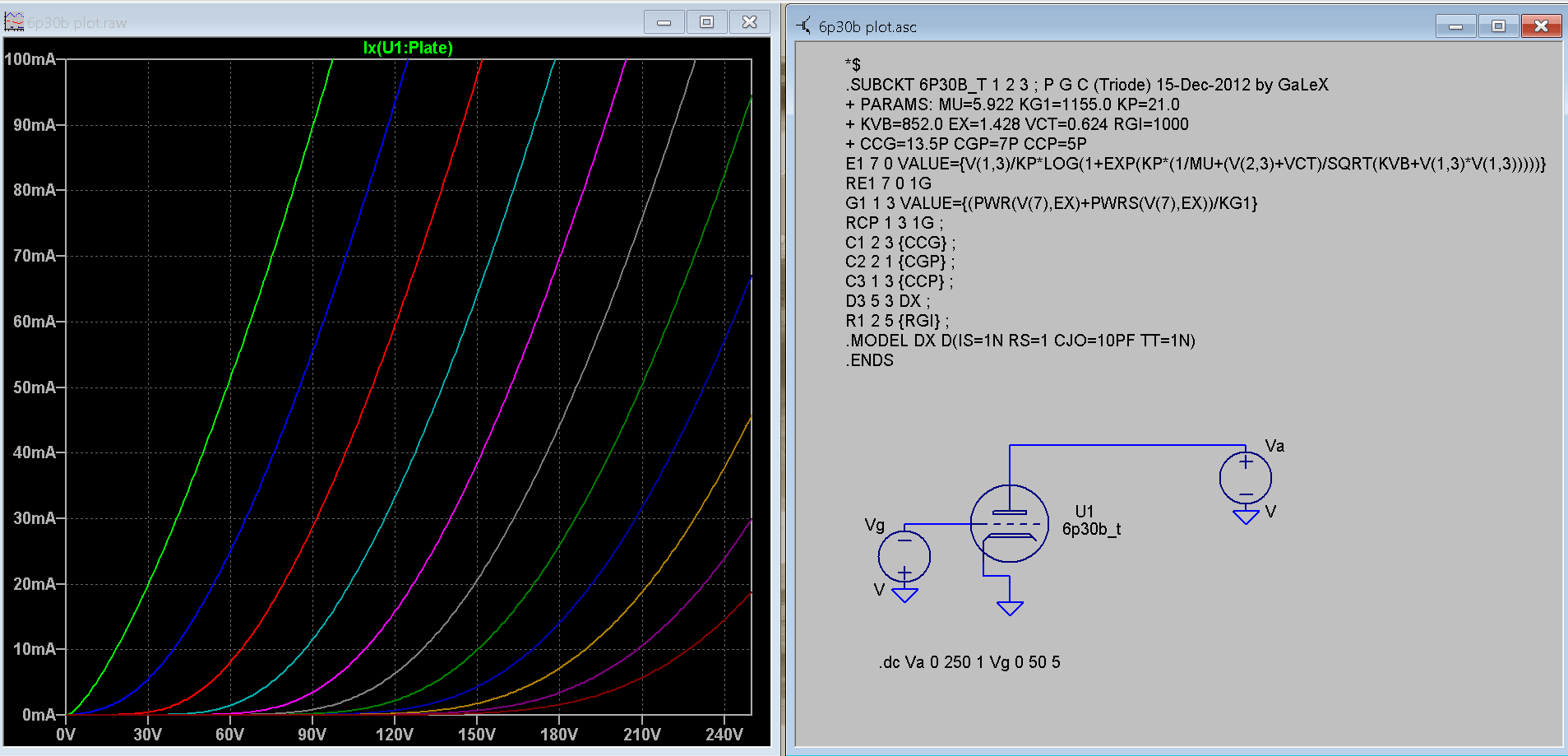

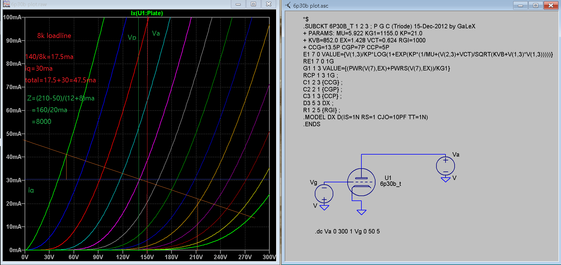

Here is asc file for 6p30n triode plot. You need to use "View->manual limits" to define the top and bottom current range you wish to displayed. You also plot the power dissipation curve by adding trace with this formula 5w/va. where 5w is power dissipation.
  • 6p30b plot.asc

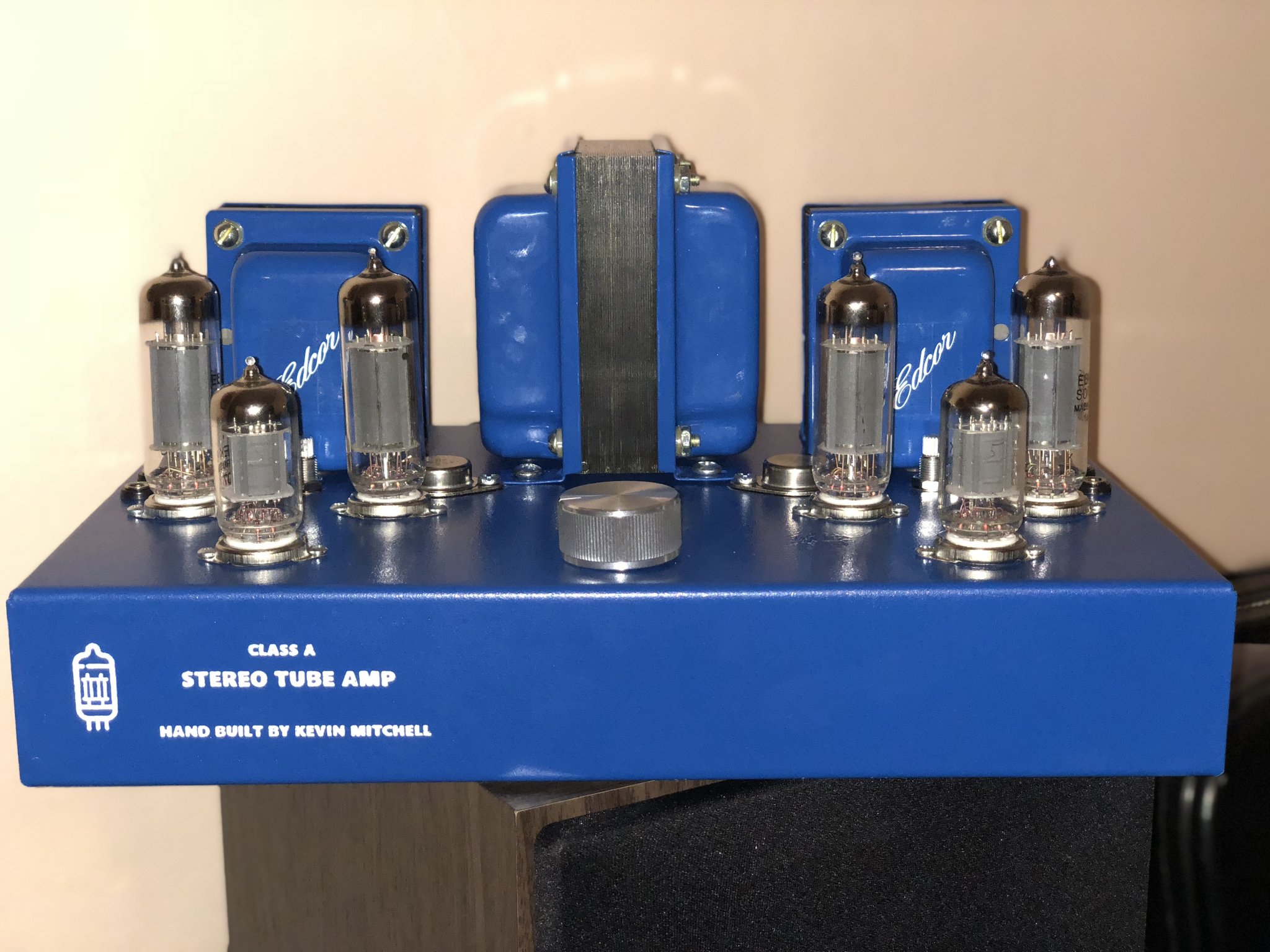

You putting the inductance rating into question educated me on something I did not consider entering the world of hifi audio. For that reason I had moved away from using line matching transformers as an OT and I had learned many if not all of the budget transformers I had been reviewing should not be purposed for circuits aimed for a quality spectrum of frequency response but would suffice for guitar amps. Looking around for alternatives and checking out the market for decent tube audio transformers I had found the EDCOR website. I eventually came full circuit to a project called Poddwatt. I had purchased the transformer set for the project which would work excellent for the submini project but likely will be put to use in a Poddwatt of my own.
In the world of hifi, I'm finding to not cut corners. In the general world of tube circuits, there is still much for me to learn.
