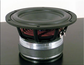

The speakers I'm using now look very much like (especially the distinctive lopped-off-square surrounds) Aurum Cantus AC130/F35 midwoofers. The manufacturer claims their speakers are proprietary, but it looks very much like they had Aurum Cantus build them. The cones look different, but all else looks the same and the specs seem right.
The cones look different..........
then it is different
.......and the specs seem right.

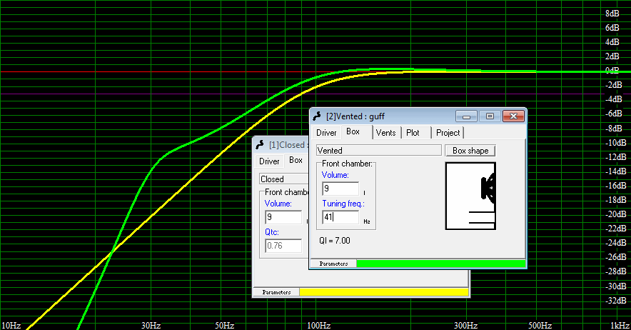

if have to be 5", theres a Tangband, W5-1685
Around a 1/3 of a cuft per driver is not unreasonable. A 1" dia 5" length port
per driver would tune them low, around 33Hz, but the other thread states
your using a 1" slot the full length of the cabinet, 5" deep it wont tune them
anywhere near bottom E, it will be much higher, and they'll overload easily
for all frequencies below the port tuning, producing little output to boot.
rgds, sreten.

I feel the need to stress the point that you want to use purpose designed drivers for a bass guitar (either guitar or PA speakers). A bass string has way more excursion than a hifi (linear) speaker can achieve. Only a speaker that compresses the peaks (generally identifiable by the accordion suspension) will survive.
FWIW its not the suspension its the magnetic system that separates
music drivers and hifi drivers usually. Hifi drivers have linear Xmax
above which distortion increases dramatically, but is low below Xmax.
Typically known as long coil / short gap or short coil / long gap.
Music drivers on the other hand tend to have equal coil / gaps.
They produce a lot more lower order harmonic distortion than
hifi drivers below the hifi drivers Xmax but unlike hifi drivers
they don't produce high order harmonics suddenly at Xmax.
E.g a near equal coil 5" driver is :
Madisound Speaker Store
With a 12mm coil and 12.7 mm gap it is the sort of driver you
want. At $2 each for 30 or more what more could you want ?
A 7x4 sealed cabinet will go seriously loud with at least +/- 6mm
from each driver, more with more distortion. If you know your
bass guitar cabinets you know the 2nd harmonic of bottom E
matters far more than the 1st, see all commercial cabinets.
for $60 worth of drivers you'd have an outstanding bass cabinet.
rgds, sreten.
Attached is a typical sealed and "power handling" alignment
for 1 driver, 1/3 cuft per driver, very near right for a 5".

with at least +/- 6mm from each driver, more with more distortion.
ehh, voice coil is 12mm underhung, in a 12.7mm magnet gap, gives +/- 0.35mm xmax 😕
