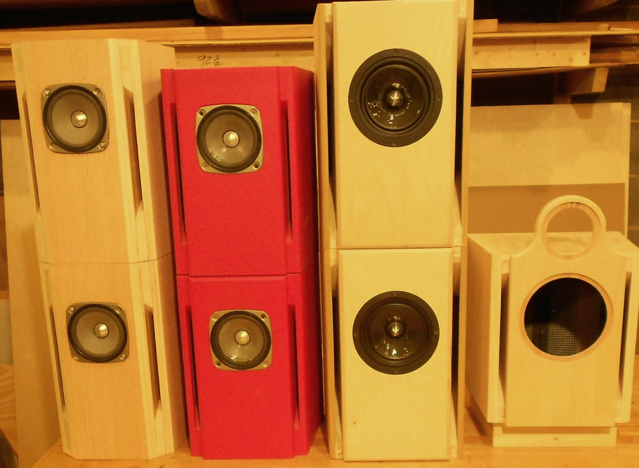

You might one of these designs with your 3" Tang Band.
http://www.diyaudio.com/forums/full...881si-enclosures-post3378919.html#post3378919
I have run both with the Lepai Amp and been happy with the result.

I've been on a roll with front-facing-dual-flare-ports boxes - might be the best invention since the toaster 😛
The taller TB boxes will rattle the windows (but they need a tweeter). Hard to tune? well I guess they are, but only takes a few hours.
Very nice! I have had great experience with these type of enclosure.
