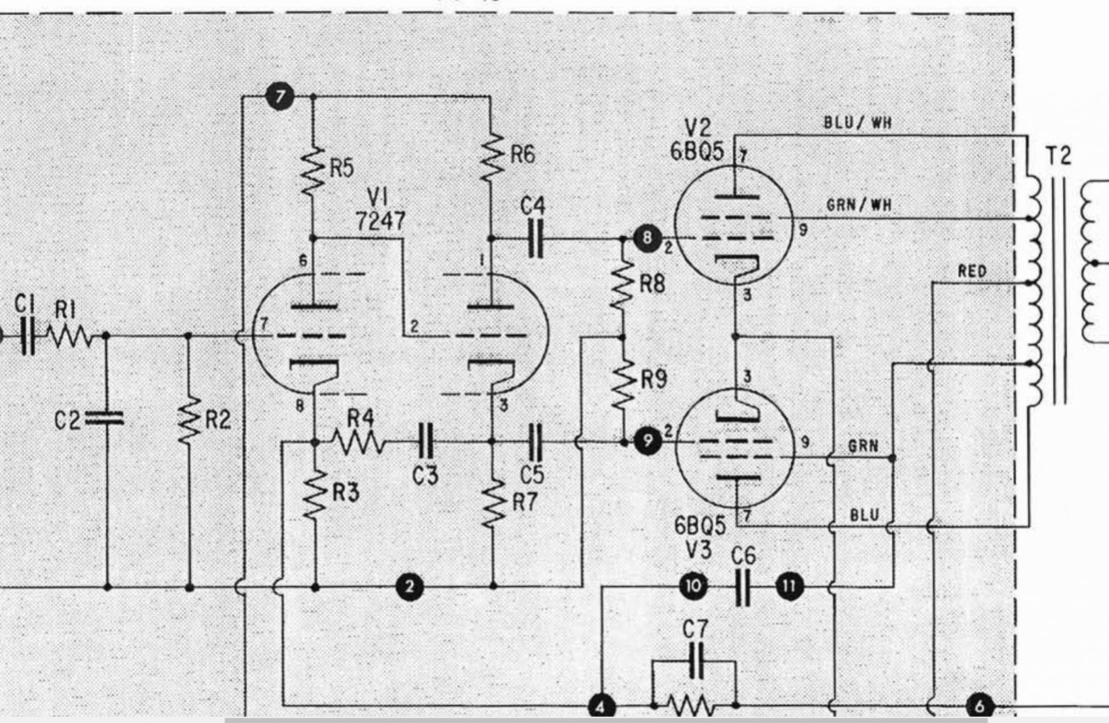

I notice you also have the -HFfb, like Dynaco used in their ST-35 with C6. I guess this is a stability tweek. Or maybe this is intended to reduce global N-Fdbk at HF by lowering gain. A crossover to local N Fdbk. Would there be any advantage in using a larger C6 here, with a series R, to set a definite break frequency?

The OPTs in those daze (1955) for the most part were for use as replacements or in Public Address systems.
Most of them never saw any kind of NFB at all. So when it came to using NFB, we had to step carefully.
For the PP amps that meant a realistic limit of about 10 db NFB. I liked to be safe so about 7 db NFB.
I found that it was possible to damp the HF oscillation sometimes seen as a sine wave approached clipping.
Crowhurst covered this, I'll have a look in the AM, think I have that here in the pile.

For a simple FB pair type amp I've used up to 20 db NFB with no problems at all. Even when the OPT
was in an All American Five (AA5) BC Receiver. In those I pulled the rectifier & replaced it with a SS diode.
Stuffed a 12J5 into the rewired 35Z5 socket. And replaced the 35L6 with a 50L6. so a FB pair
with 20 db NFB is possible. Then a terminal strip on the back to drive a 12 inch speaker in a ported box.

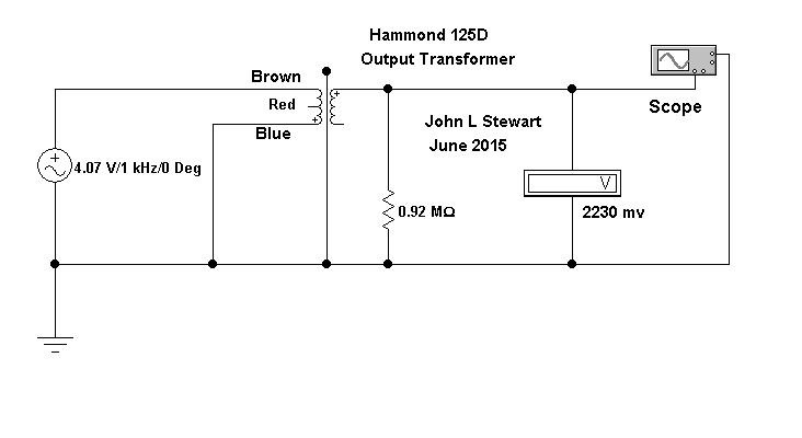

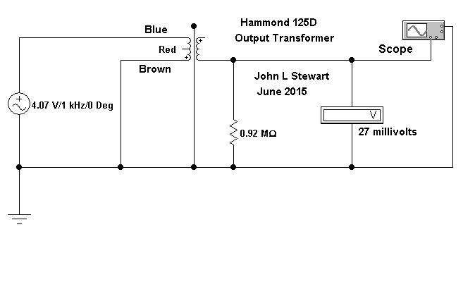

Test for parasitic capacity between primary leads & core, Hammond 125D.
For a SE OPT the red lead usually goes to the B+.
That way the plate of the power amp is not diving a large capacity.
Probably corrected in $$$ OPTs. But perhaps not, have a look.
The odd 0.91M load resistor in the schematic is a One M load in parallel with the 10M scope probe.
