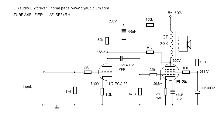

I'm looking for a input/phase splitting stage for a PP amplifier.
I've got both halves of an ECC81 / 12AT7 available per channel.
The complete stage does not have to have any gain,
just a phase-split of reasonable-to-good hifi standard.
The output(s) of the splitter will go through caps to both halves of an
ECC83 to drive EL34's in their turn.
I've got a B+ of 300V
Has anybody got a schematic which I could use ?

Use a cathodyne splitter. This has to be RC coupled at the input. The cathode load is made of 2 resistors: the self bias resistor + an additional load. The sum of the two resistances is equal to the anode load resistance.
Here is an example: 6F6 Amps
Why would you put a low power, low current ECC83 after a much higher current higher power ECC81?
Let the ECC81 drive the EL34's, and put any ECC83 gain stages BEFORE the splitter, not after.
Regards, Allen

that would be because I'd like to try two SE amps which I already build
as one mono PP. So the ECC83 is already taken :)
I got one PP output transformer so I thought I'd give it a try....
Thanks !
Empee
