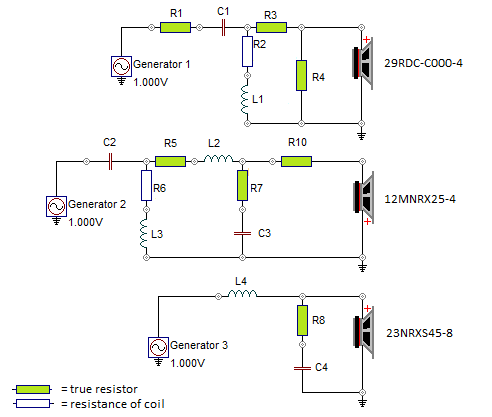

SB26STC tweeter option on Troels' SB Acoustics 3 ways
..Better sound??...Save $40!!
In Troels' SBacoustics 3-way Classic Design, the SB26STC-C000-4 tweeter could be a better choice for the 3,700Hz LR2 crossover to the SB12MNRX25-4 midrange than the currently selected larger diameter SB29RDC-C000-4. The SB26STC has a smoother SPL extension to 20Khz and beyond.
Since both are excellent tweeter, listening tests are as important as datasheets.
The SB26STC-C000-4 costs ~$33, and the SB29RDC-C000-4 costs ~$52.
The large 29mm dome diameter and low Fs=600Hz of the SB29RDC-C000-4 and SB29RDNC-C000-4 dimpled dome tweeters is commonly selected for the required ~1800Hz LR4 crossover to the 6.5" midbass SB17NRXC35-8. The physically smaller SB29RDNC-C000-4 can reduce T-M center-to-center separation, especially when the plastic face plate is further trimmed. 116mm vs 142mm
Getting good measurement data (FRD, ZMA) is harder than calculating and simulating passive crossover values.

It would be just beautifull if this project SB acoustic 3 way could include
satori mw13p-4 instead of SB12MNRX25-4 midrange and Satori tweeter TW29R rather than SB29RDC-C000-4
comparing those drivers data-sheets ,they looks very similar ,do you think they could be just swapped ?
that could be real hiend small classic 3way ...
