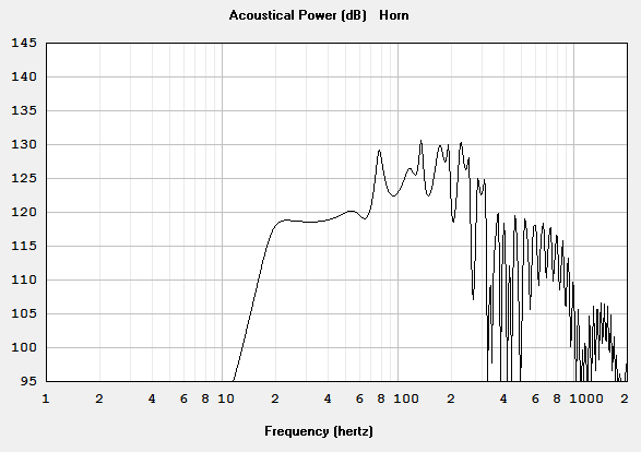

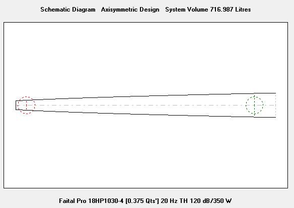

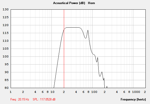

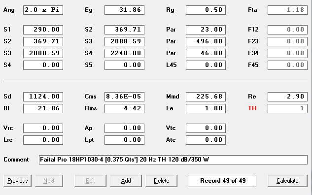

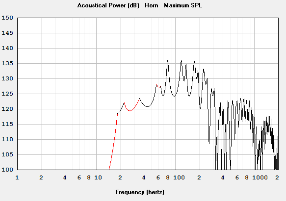

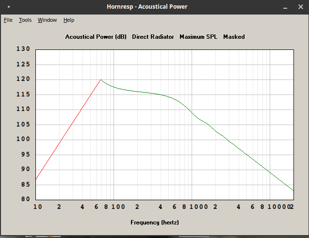

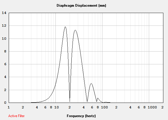

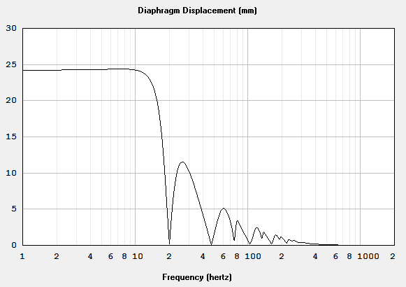

Here is what SPL and excursion look like for the simple tapped horn GM posted above, both raw and filtered (4th order 17hz highpass + 4th order 55hz lowpass), 350 watts. You can have 117+db at 20hz if you want. This is an excellent choice if you are certain about having no box size limits!
If you're not familiar with tapped horns this is just a giant rectangular box, with one divider inside it, slanted across to make a taper. Here is a photo of the inside of an 800L tapped horn, showing how simple the layout is:

Note that this is 2pi (out in the open), so up against a wall or corner it will be louder to a lower cutoff or need even less power, so overall a very high SQ (infra) sub system plus with DSP the upper corner can be extended to 80-120 Hz if desired.
