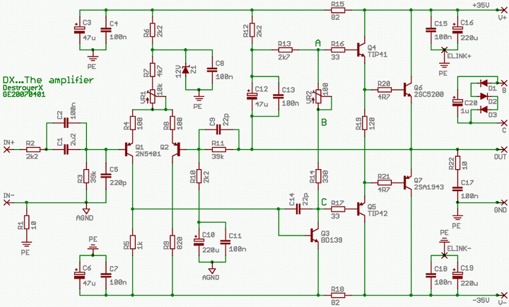

The Dx amplifier can work with many voltage and can use many kind of transistors
including those ones you mentioned.
The schematic is attached..... if you like it , go ahead...if negative... I trully hope you can find, and fast, something that match your needs.
If need some help..go to Dx tread...my thread...and you will have the help you need.
This amplifier, adjusted to your transistors, will need supply of 22 pulus 22 volts DC...this will make it produce something alike 20 watts RMS over 8 ohms...and may reach the TIP31/32C dissipation limit when using 4 ohms.(dangerous with 4 ohms...may burn if receive loud signal..constant distorted guitar at the input when driving 4 ohms... this will be a burn test...)
Even the 8 ohms speaker, has peaks and valleys of impedance...so... even using 8 ohms speakers you may have problems if the transistor dissipation is not good to work...say...to 4 ohms loads too.
To perceive power increase in one amplifier you will need to multiply the power 4 times...just to perceive something...so...a 20 watts amplifier will sound almost the same into human perception than a 70 watts amplifier.
This amplifier will need adjustments to work with smaller voltage then the designed one.
VR1 will need to be adjusted to 8150 ohms..this is to reduce the offset, that output residual voltage, to 3 to 5 milivolts.
The bias to be adjusted must be around 40 to 50 miliamps
R10 must be substituted to a 3K9 unit
The voltage amplifier, Q3, can be BD139 or TIP31C
The upper transistors, driver and output, Q5 and Q7 will be TIP32C
The lower transistors, the ones at the negative power rail, Q4 and Q6 will be TIP31C
All electrolitic condenser can be 25 volts.... the exception is C12..this one will need to be 50 volts.
Do not feel shy if dislike this amplifier...no problem... i love to cooperate..even if the guy give up related my design.

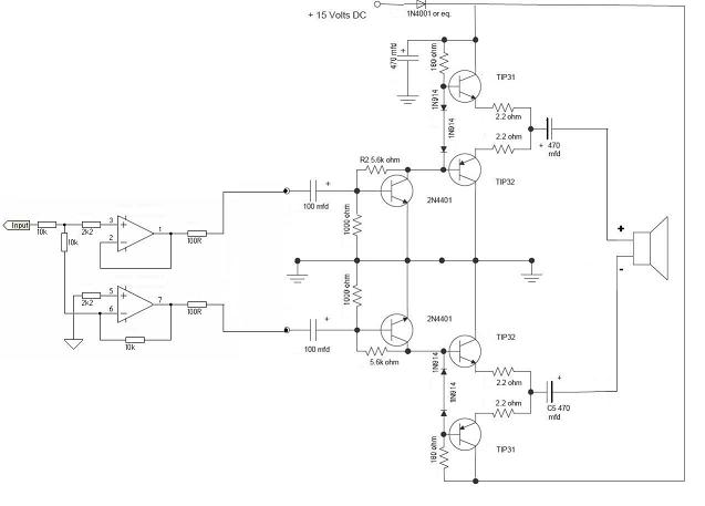

Hi.... I came up with this design and I was wondering if you think it would work OK??
I know it only runs off of a single supply but I was wondering if you could tell me first if this would work?? and secondly if it would be possible to change it to run off of a Dual supply and how to do that and what would have to be changed to make it run at a higher Voltage (20v-24v)......
I basicly have a opamp at the input to act as an Inverter and with each side of the Transistor amp pushing +/- into the speaker....
I don"t know if it will work so I thought I would ask you folks.....
Thanx
Thanx

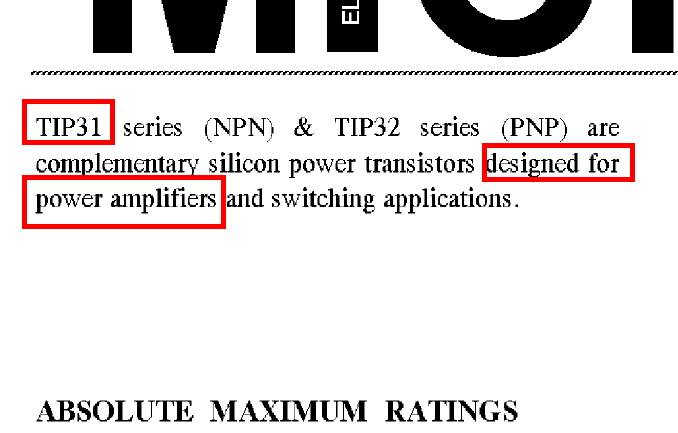

I don't really think TIP31C/32C are suitable for outputs. You'd need more than one pair in any case.
Thing is you really need some medium power devices as VAS transistors (Q4 and Q5 on the C70 schematic). BD139/140 or MJE340/350 would do and are quite common.
You would be best trying to get some TIP2955/3055 or perhaps even the TO-3 versions as outputs, and use the TIP31C/32C as the drivers (Q7 and Q8). The 2N3904 could be used for Q1, Q2 and Q3 with no problems.. and possibly also as Q6 although that might require altering the values of R12/R13/R14.

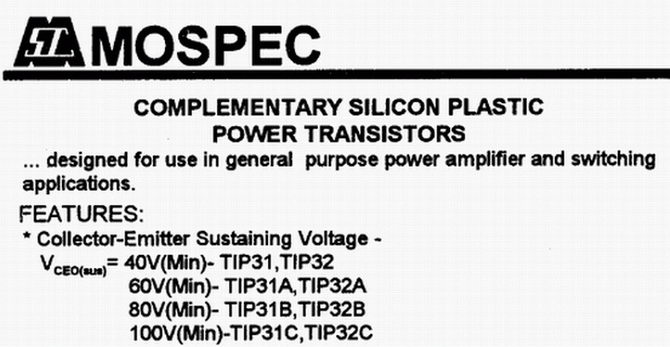

Not the power level you like Jaycee...but for sure it is output units.
They were used in thousands amplifier models around the world ..including your country sold many Kits using it in the past...even today you have Radio Shack models using it into the output.
Of course, now a days, the power levels forum folks prefer, it will be more suitable as drivers.
Yeah!..i have understood what you mean...but there are beginners that may understand your message as final words...some of them may send TIP31 to trash box...when those transistors can be used.
Maybe not the power level you respect, the power level you like, the power level you prefer..but for sure it is a power output transistor.

I guess they could be used... indeed I have seen old power amps using similar transistors, but they were only 15W or so, and not on 4 ohms.
I guess if that's all you had, then yeah it could work... but some medium power devices like MJE340/350 or BD139/140 are still a must, really. Maybe you could run a few of the small signal transistors in parallel to provide enough drive current?

Also did anyone look at the schematic I posted above?? Does it look like a working curcuit??

Try a variation of the buffered op-amp in DIB's website:
http://www.dibsplace.com/dibsed/CIRCATS/audbuf.pdf
While a great design, it can be simplified greatly and its output capability increased to meet your needs.
1) Replace the MJE182 with 1 x TIP31C (darlington) and 2 x TIP31C (paralleled)
2) Replace the MJE172 with 1 x TIP32C (darlington) and 2 x TIP32C (paralleled)
3) Reduce the emitter resistors to 0.47 ohms
4) And, if you're not up to the bias circuit or lack the parts, replace Q2, R6, R9, and R12 with 4 x 1N4004 diodes.
5) Even simpler, eliminate all components between the op-amp output and the darlington Base connections and run the circuit Class B.
6) IF you use an NE5532 op-amp like the schematic, you can run the power supply rails at +/- 20VDC as the 5532 max is +/- 22VDC.
Minimum parts count, okay performance and sound, and perfect for a small guitar amp.
