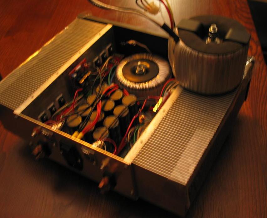

Ok the two I used in my TXO monoblocks work great!!! No vibration from the trafo or humm even with ear on trafo. Very good!!!
Cheers!
Russ
Cheers!
Russ
More info...
The trafos are wound for 117V, and the secondary voltage output is actually a bit lower than 22V.
Here is what I get.
20.5VAC/0/20.5VAC
At my power supply that translates to 29VDC(measured) rails.
Not bad really, and I am driving a current thirsty bridged amp where the current these 650VA trafos offer is the key advantage.
Over all, an excellent find.
Cheers!
Russ

OK everyone, Lets see pics of them in action. I like looking at big round...tttransformers. Man, I guess wasn't weaned properly.
That just gave me an idea of a layout for a pr of these big-uns
Hey Russ, tell me about that amp.
