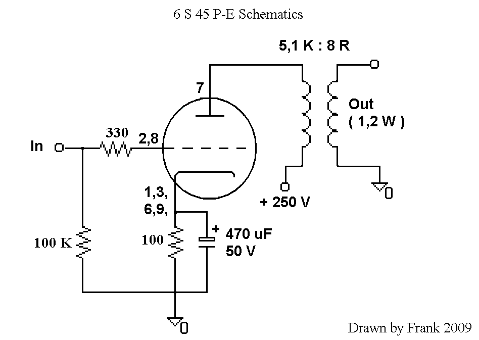

I want to build single tube amplifier. Not like ECL82, when there is triod and pentode in one, but real single stage. It have to be like this in my mind:
input transformer--->tube--->output transformer.
Did anybody make sumething like it?
2W output at 8Om will be anough.
As compromise integrated tubes triod+triod is possible (2 stages).
You can do it with high GM triodes like the super expensive 437A or the russian 6C45 which is much more reasonable. These tubes don't even need a step up transformer. There are plenty of pentodes too, 12HL7, 6AG7, 6CL6, 8608, etc etc.
I have once seen an amplifier done with a single Russian 6J52P, but can't unfortunately find the link anymore. However, it should not be a top engineering project to design such amplifier. 6J52P has very high gm - 55 mA/V - and max. anode dissipation is 10 W. So these features seem to be very suitable to single tube configuration.
I would try to make it with simple cathode bias and without input transformer. One suitable output transformer would be Hammond 125 ASE.
It has plenty of primary and secondary taps to find the best load impedance for the tube.

Here is Minimalistic Single Tube Set Amp project for You,but with only 1,2W output power.
And here is the link for same project:6S45P-E SE Amp
