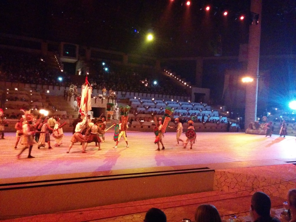

One exception. Is xcaret in cancun mexico. There is a huge stadium and an illustrious performance. I believe it was all yamaha stuff . But need to check
