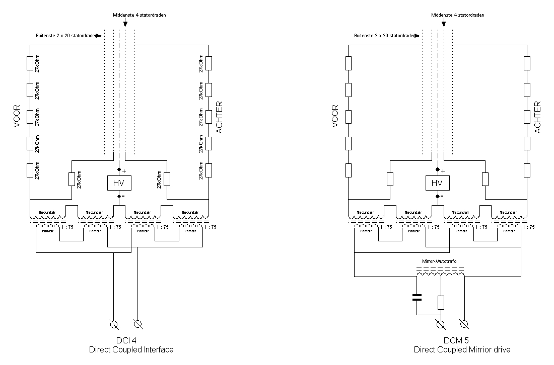

Hi Guys,
Just take into consideration that the best ESL has never been build! It's all about compromises!
This is the best I can do for you guys.
Remember, that when you use a long through panel that the high freq. will suffer due to (doppler) distortion.
All the best.
Audiofanatic 😉
P.S. BTW you don't want to attach this beast to your amp. It's almost short circuit! A 1.2 to 4.0 R in series is a must!

Wow!
Thanks Audiofanatic for sharing the DCM4&5 transformer setup.
Interesting that you need to add a series resistor to protect your amp. Is this something the Audiostatic owner's manual recommends? or something you have found out from experience. I would think that the larger the resistor you used the more the high frequency response would be attenuated.
1. The intention of using 4 transformers is to optimize core/bobbin design regarding bandwith. Its easier with e.g. 4 stepups than with one large.
2. I guess the primary wire size is chosen in order to provide a certain dc resistance by the primary winding itself, so no need for additional resistor in serie
3. There is a 27 K resistor in serie to the middle segment of the ESL, which adds additional impedance at high frequencies. The impedance calculates to 27K divided by 150 in square, means 1,2 ohms. So at any frequency impedance never gets lower than 1,2 ohms , adding primary dc resistance of e.g. 1 ohm, means 2,2 ohms at least.
4. the fundamental resonance is damped by the rear wave like structure, which is close to the membrane
