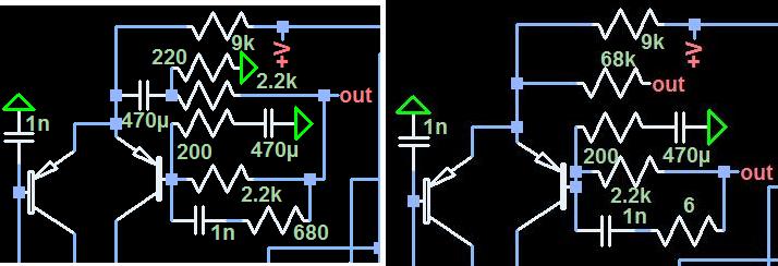

I have noticed that long tail pairs tend to be nonlinear because the current input at the emitters changes when the voltage at them changes with the input and feedback audio. The normal fix is to supply constant current to the emitters instead of using a single resistor. The constant current source is a clean solution distortion-wise.
I believe that I have discovered that there might be a remedy which is an alternative to a constant current source. Connect a suitably-valued a resistor from the audio output to the emitters of the long tail pair. Such a resistor cancels out voltage changes.
I doubt that I am the first to notice this solution. I would be interested to see who else has tried it and what the result seemed to be.

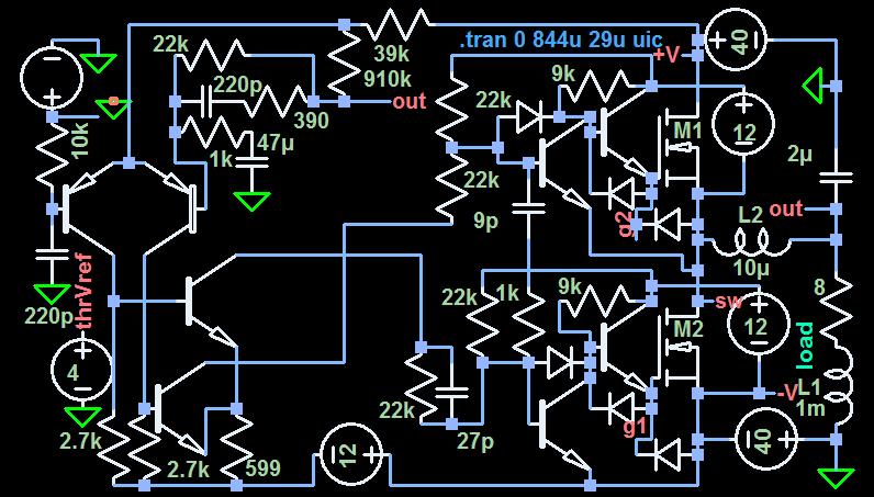

Hi Andrew. I was playing around with the idea on a circuit I have been designing in LTspice. I am working on the simplest class D amplifier that I can come up with that uses discrete components, only N-ch MOSFETs, and operates on at least +/-40vDC.

I have a new long tail pair linearizer. It offers a simple alternative to constant current sources. It looks different than other things that I have seen, but I doubt that it hasn't been tried before by someone else.

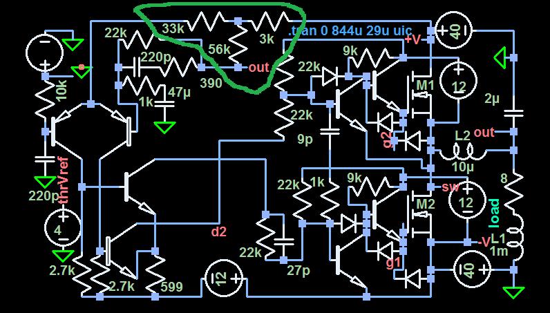

I selected the three resistor values which replaced the original 39k resistor by first setting the sum of the ones in series with the B+ equal to that 39k one. 36k + 3k = 39k. Then I used LTspice to find the third value by trial and error. That 56k resistor maintains almost constant current through the 36k one.

The latest example that I showed is close to a type of bootstrapping. If I added a capacitor in series with the 56k resistor, it would be. In order to make this project easy to assemble with p2p and very compact without SMD parts, which I always avoid, I've omitted the capacitor. it isn't really much needed since the voltage on the emitters of the long tail pair is only nominally offset by .7v above the output voltage.
I was seeking a lessening of the fluctuating of the input impedance within an audio cycle. I wanted to make operation of the circuit more like inputing the audio signal at the inverting input, but without the loss of input impedance that you get at the non-inverting input.
I have now used the simulator to confirm that a single resistor will do the job. So, I went back to using the original 39k resistor and was able to determine the optimal value of the linearizing resistor to be 910k, placed between the amplifier output and the emitters of the LTP.
Calculate it by multiplying the amplifier gain by the value of the current resistor and then go up to the next higher value. You want the normal feedback divider at the base of the feedback transistor to be the dominant actor in the circuit.
I confirmed the 910k value by temporarily adding a 1ohm resistor in series with the emitters of the LTP and using simulation to measure its current. I have not shown the 1ohm resistor in the next diagram.

That is an interesting way of manipulating the input pair, modulating the input tail current wrt the output voltage. I haven't tried that before. What I have tried is modulating the tail current wrt the VAS common mode bias current. Thinking of the input stage and VAS as a single entity, I used a fixed CCS for the VAS and its mirror, and a CMFB loop to adjust the tail current to always maintain a fixed common mode bias in the VAS. What I like is that it works in a symmetrical topology too and reduces the effects of having a slightly dynamically mis-matched input pair. (J-fet's🙄 ) But I love J-fet’s so, and am unwilling to fork over such a high stack for matched pairs.😀 The amp I made like as this on vero-board 2 years ago still works perfectly.🙂

The next step would be to discard the second (inverting input) transistor from the pair and get better (in terms of audio) linearity, higher slew rate, and wider frequency band. It may be viewed as an emitter follower for the negative feedback signal. If output resistance of your amp is low, do you need an emitter follower?
