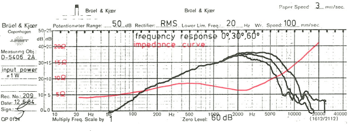

And it looks like we need some clarification about that Dynaudio midranges. There are two versions:
D-54 AF is version without waveguide, flat front face. Given SPL is 94 dB/W/m.
D-54 is version with waveguide. Given SPL is 96 dB/W/m. Thats the one RevDev has, what his pictures show in post #9.
Except for waveguide (and different response as result), two versions are identical.
This is SPL (black line) and impedance (red line) chart from D54 pdf in post #27.
First on the left, from 0 to 50, are SPL values.
Zero level is 60 dB, as noted middle-below chart. For eg, 40 level is 100dB.
Second on the left, from 0 to 25 are impedance values, also written in red beside it.
From 2000-5000Hz SPL is 96dB.
At 1500Hz its 94dB
At 1000Hz its 89dB, and so on.
