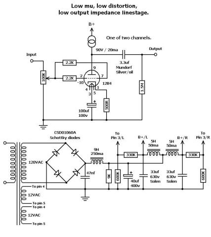

Long term I would like to roll my own preamp, but in the interim, does it make sense to upgrade the PAS 3 with one of those Tubes4HiFi PC boards?
I would not spend much on the PAS, if you are going to build soon. The buffer you build for the PAS will serve you well in combination with the new, DIY, preamp. 😉 The awkward cabling situation will not disappear and you will already have the circuitry needed to cope with it. Given the presence of a competent buffer, a nice sounding 12B4 based line stage could work out very well.

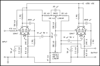

BTW, asking the 'X7 triode to drive both the power amp and tone control circuitry, as was done in the old Dyna PAS preamps, is problematic. AVA offers PAS rebuild kits that eliminate the troublesome tone controls. I can tell you from 1st hand experience that the AVA stuff is good. My son uses a rebuilt PAS of mine hand me down. 😉 I've uploaded a schematic for a single channel that shows just how complicated good tone controls are. Also, it is a fact that few recordings benefit from tone controls. Therefore, tone controls, if present, should be capable of being totally switched out of the signal path.

Yes, I want to add a defeat switch for the tone controls.
The circuit presented is a little hard to read (too small when expanded), but it looks like the output impedance is going to impact the tone circuit. Is that true?
The next step would be drilling down to a good recommended circuit that I could not only use for my next amp, but could also transplant into my PAS.
Having an active tone network would be the cat's meow versus the circuit used now in the PAS.

Other than the commercially available upgrades, leave the PAS alone, if no reason other than severe PSU limitations.
PM me with your EMail address and I'll send you the high resolution, .bmp, version of that Max Robinson designed tone control setup. 4X 12AX7s for 2 channels of tone controls is (IMO) OTT. It doesn't take much effort to replace the cap. coupled cathode followers with DC coupled ZVN0545A source followers and reduce the bottle count to 1/channel. 😉
As Max's design is "unity" gain, my inclination is to switch the tone control circuitry in/out of the signal path right at the line stage's I/Ps.
FWIW, the PSU I have in mind for the cable driver buffer will easily support a 12B4 line stage, along with the buffer. 😀 Perhaps a combined line stage/buffer effort is in order, as you will avoid some duplicated work. Ignore the PSU in the uploaded 12B4 line stage schematic. FWIW, the 12B4 line stage can drive a 10 KOhm I/P impedance amp, IF the interconnect cabling is reasonably low capacitance. Your situation is anything but reasonable. 🙁

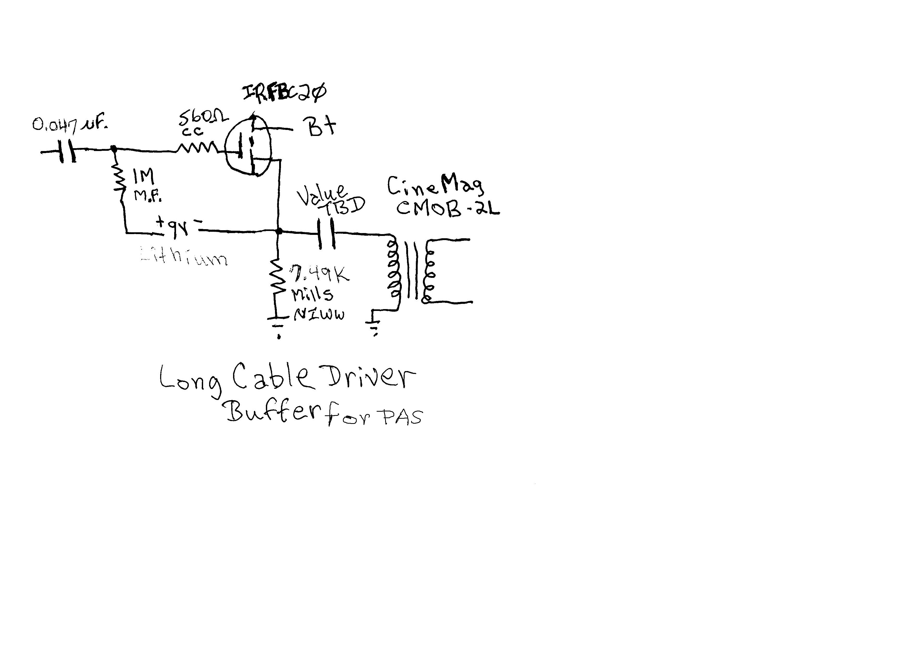

I've uploaded the 1st cut schematic for buffering the PAS. Assistance from CineMag is needed in properly sizing the DC blocking cap., that's in the O/P circuitry.
If a combined 12B4 line stage/buffer project is to be undertaken, the FET will be DC coupled to the triode. Fewer caps. in the signal path is "always" better.

OK, then cross out the trafo in the buffer cuicuit I uploaded. The buffer's O/P cap. will be a 4.7 μF. metalized polypropylene (MPP) part, like a Solen. Bypass the MPP part with a film and foil part up to 0.47 μF. in value. The low cost bypass is a 716P "Orange Drop". The boutique bypass cap. is a MultiCap PPFX series part.

Guys pay attention, please! The sort of transformers under discussion need to be driven by low impedance sources. Look at the trafo data sheets, closely. Dyna PAS preamps are anything but low impedance sources. 🙁 The approx. 470 KOhm I/P impedance of Dyna tubed power amps is not accidental. Sometimes, tweaking of the secondary side loading to stop ringing is necessary.
BTW, even if the PAS did not impedance mismatch with the ground loop blocking trafo, the capacitance of 20 ft. shielded cables will roll the HF info. off., very badly.
Build the buffer!
Build the buffer!
