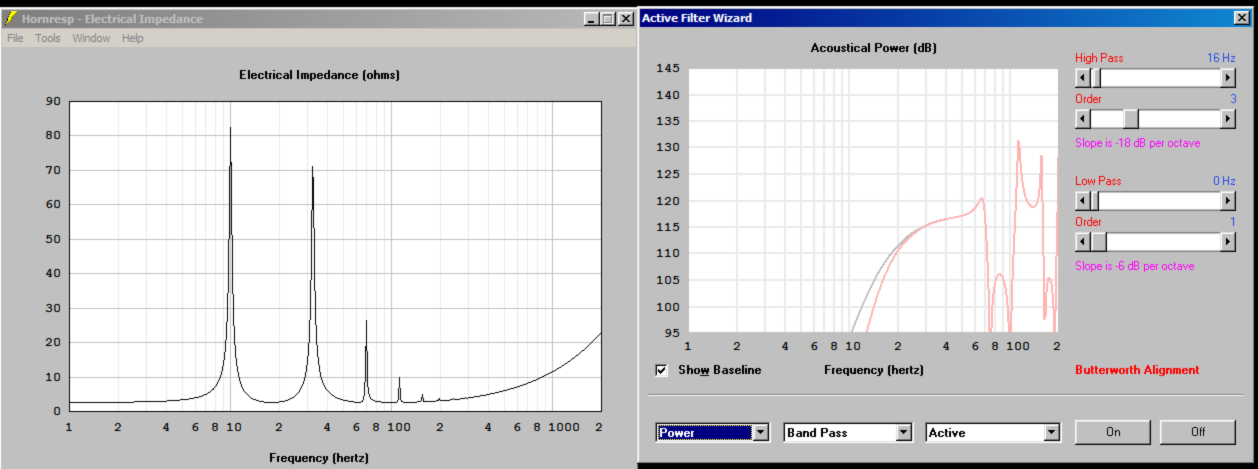

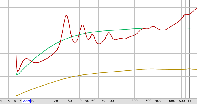

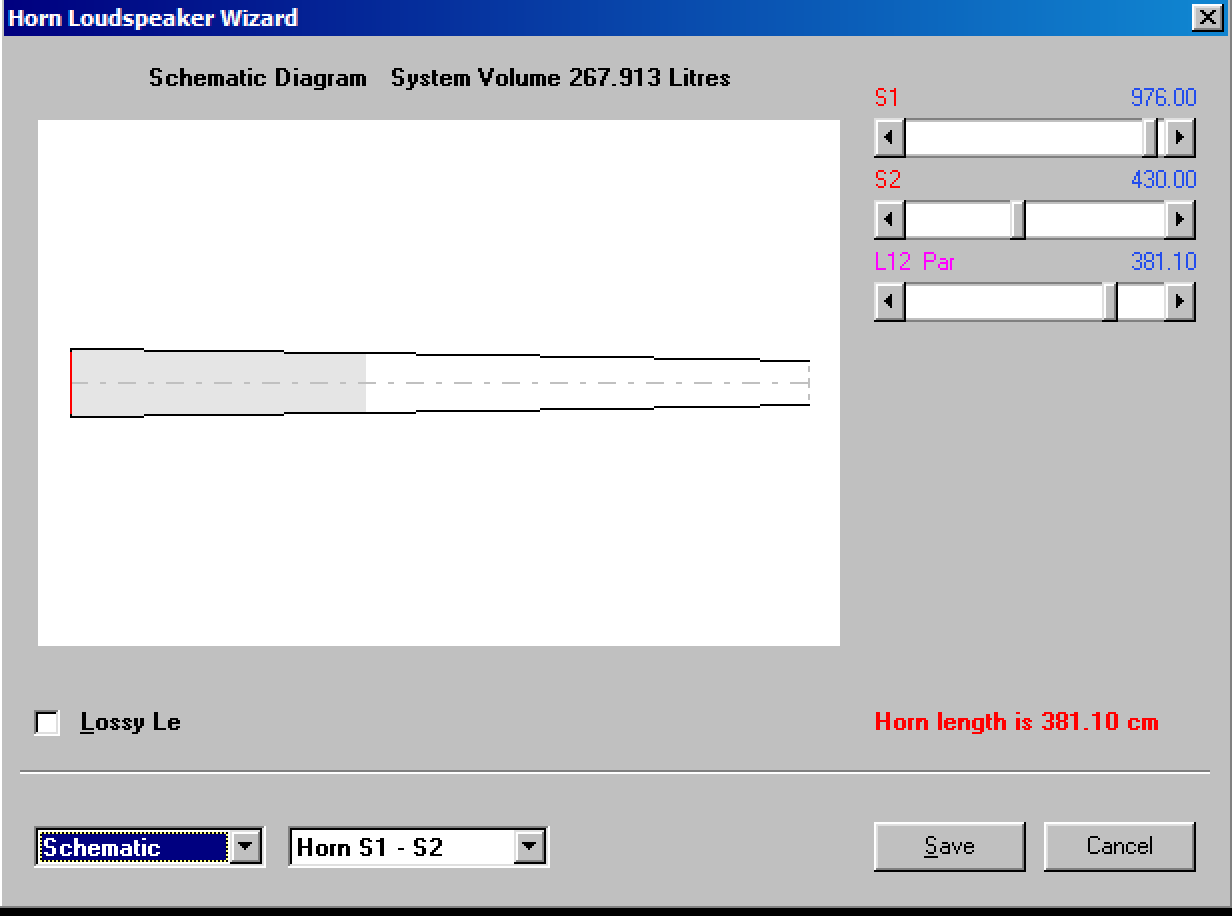

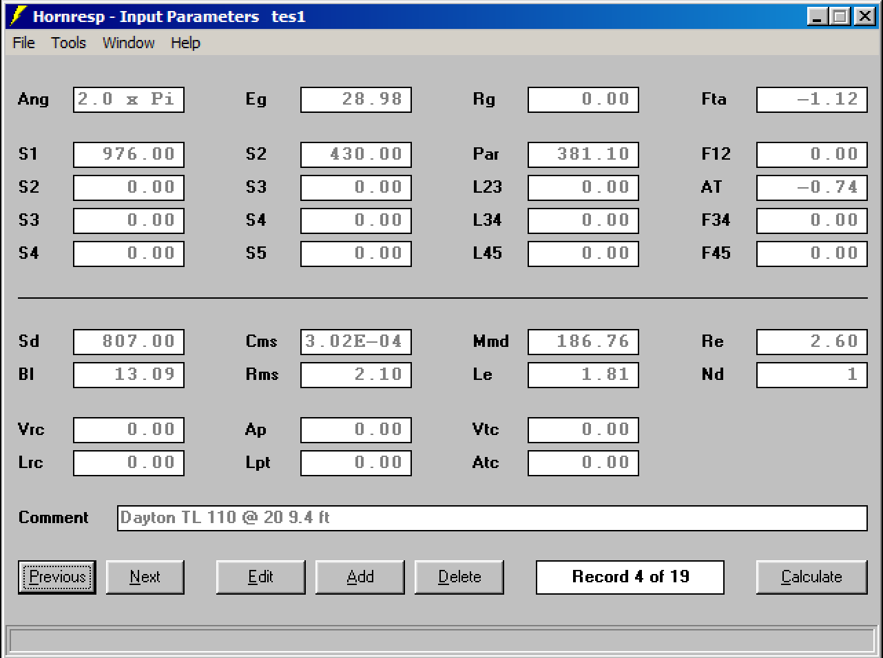

Hey you can give the old dump truck sub a rebuild for 2022😃 not much there to see just a little bit different approach and some other real estate to stuff maybe? Maybe it’s both outputs in the same location you’ll notice something different
Or you can swap the first three cross-sectional areas out for 1296 cm2 go under the 20,000 leagues mark.

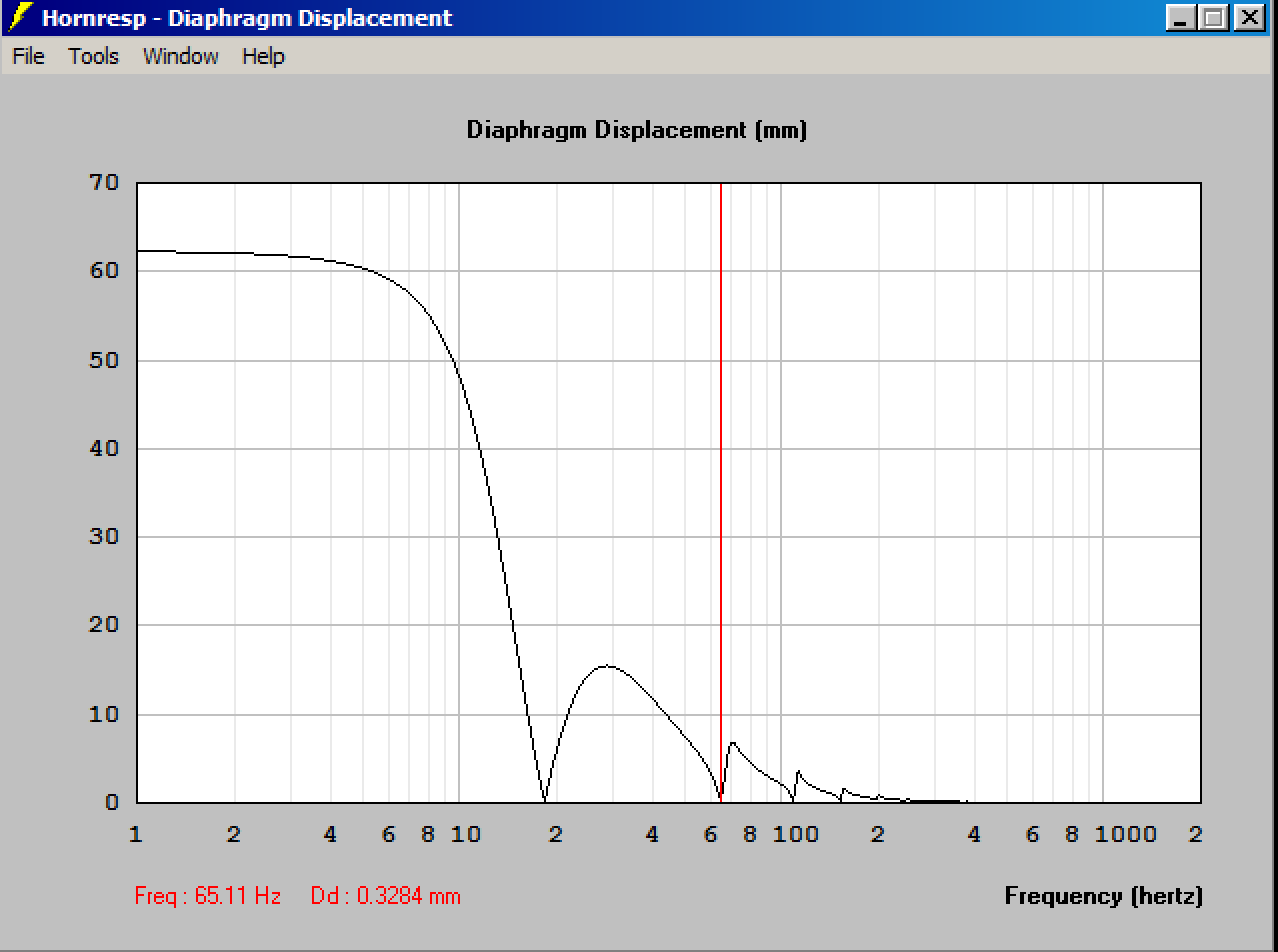

The only issue I can think of with going so low (assuming it’s pushing the issue in a way that’s not typical) for base extension is the group delay will start racking up points quick Why do you hit that threshold. And you’re already using a reduction in cross-section to do so.
However that may or may not bother someone if they’re not sensitive to it or don’t perceive it. Kinda hard to say and some people seem to like portions of the lowest notes at that point you can barely hear anyhow as long as they’re still around and present maybe they’re still a good contribution to your listening experience or Not that much lower and it’s a ‘feeling’ experience more than audible?
I’m Still waiting for a driver to get back in stock at parts Express so I can have two of them and try my best at making a 12-16 Hz infrasonic experiment And see what it’s all about

What once was 00349206349 (Thats 20/360* , is now in a compound cabinet 05238 or 30/360 with with 300 separating the drivers.
6.2857142 (360 cm) is the total and 5.238 is 300 cm Between the drivers and .5238 is the distance from each closed end , from a zero and 360 essentially . So its 1/12 and 11/12 of a circle if using that as the basis for the cabinet design. Which once you do everything works out beautifully. Can you can see that Further using circumference equals two pi R and using pieces of radius to define those arcs as a radian to divide up these numbers as angles or what they are in degrees as centimeter?? it works both ways. You can see it in different designs were both numbers can affect the other. But since we’re not familiar with radians we don’t use that for much of anything anymore it’s long gone with navigation to GPS nobody’s familiar with that and the numbers to seem odd to all of us as a result..
Originally 03492 in a 300 cm cabinet was 104.76 cm. ((It’s 20° and 300° and 60° in a variety of explanations numerically describe them ) Either way it’s still The absolutely perfect position to put the driver entry in in the ODTL mode. And it’s giving it the correct cross-section for the drivers TS parameters appropriately that all worked out excellent every time.
And the same idea then becomes the alignment to which you want things overlapping in the compound cabinet and the same approach has then much greater advantage in that acoustical output and low pass filter effect it will once you’re incorporating it.
