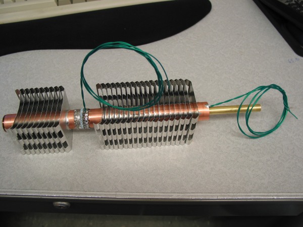

Steve: all your answers lie in 36 resistors soldered to some slant fin..on a desktop..with some green kynar soldered in..

You mean like the monstrosity below? 🙂
