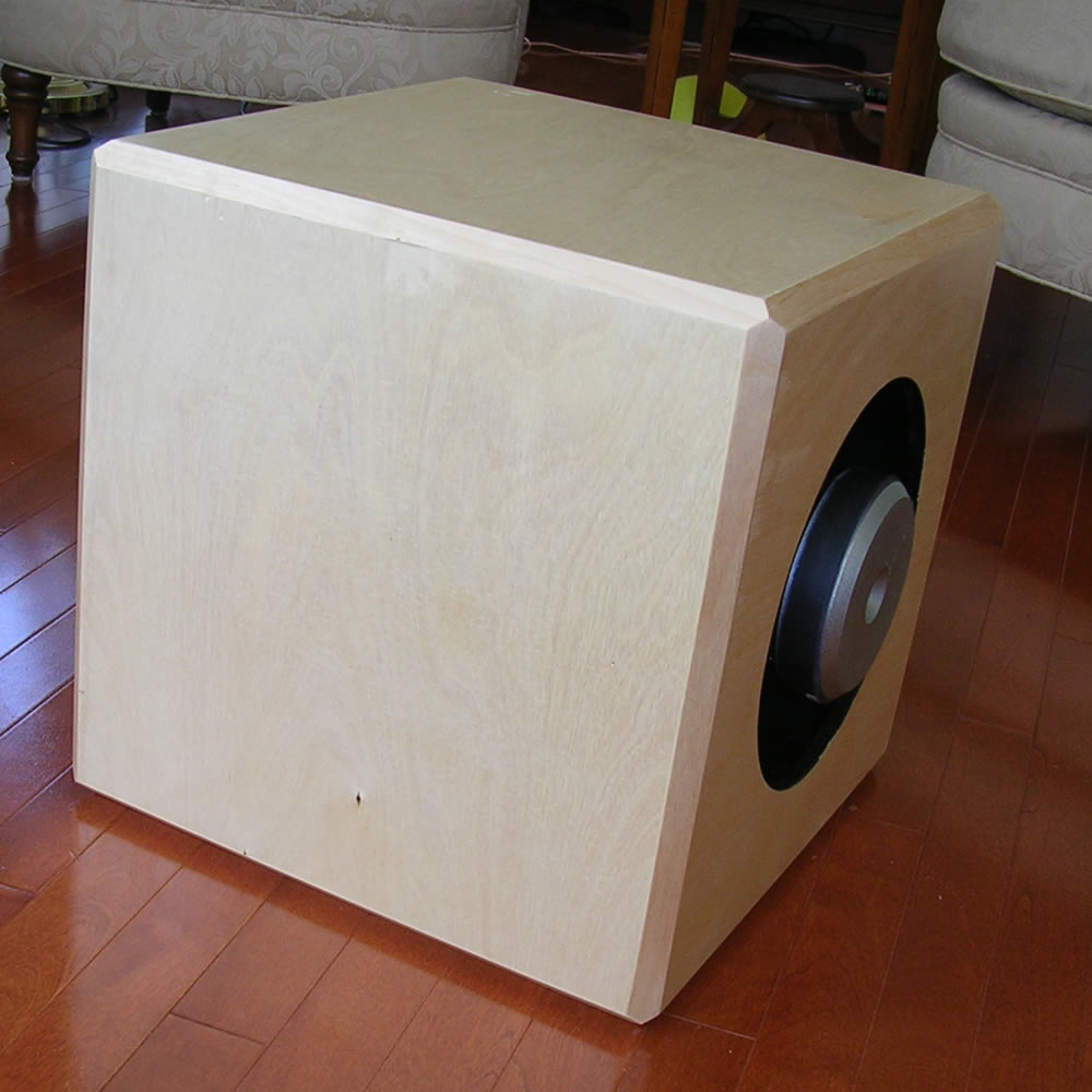

Hi all. I’m looking into getting the tools together to do a lot more projects around the house. Including things like loudspeaker cabinets - but I was reading and I’m having trouble understanding something.
Some cabinets require beveled edges 10-12 inches long at specific angles. I’ve noticed most chop saws have around 7 inch capacity cutting at 90 degree miter. Does having a dual bevel allow you to make longer bevel cuts or is this really something that needs to be done on a table saw?
What are other suggestions? I’m currently looking at a 12 inch Makita people say is good. But is only single bevel and I’m wondering if I need to save my money for something else.

A sliding miter saw that allows the saw motor to tilt will do compound miters.

I made a speaker with bevels on several edges that had to line up at the corners - which they did perfectly. I've also cut bevels on my build of Dave's Fonken speakers. All these bevels were at roughly 45degrees. In each case I used a hand-held disc saw with the base plate adjusted to the appropriate angle. I also clamp a strip of wood to the speaker to act as a guide for the base-plate of the saw to run along.

Yes. Thanks. Actually the Bosch is the table saw I was going to get. I just wanted to make sure I wasn’t missing something in how I understood the chop saw. I am getting the chop first and table second
I suggest looking into a track saw, a newer hybrid that I would buy if I did't have half a dozen table saws from 8-12". If you are going to stay with small boxes the slider will do, and also handle your trim cutting. I have the DeWalt, would buy the Bosch Glider. It does not require the space to the rear that the others do, so can be used on a bench or stand up against a wall.

This thread needs to be moved to construction tips. That said the problem with doing bevels, rabbets,or dados on a table saw is that plywood is warped and needs to be pressed securely to the table or the joints will be sloppy. I love my table saw and it's the most used tool in my shop however if I were just getting started and just wanted to build speaker boxes I would get a standard circular saw or a track saw (but $$) and a 1/2" router. That way you can clamp the plywood down to a workbench to flatten it as you work. You need the router to cut holes anyway.

The track saw is VERY useful for making cabinets.
It's difficult to break down a full sheet of plywood or MDF on a table saw, but a track saw makes it SO easy.
Also, if the wood is warped or the edges aren't straight you will get lousy results from a table saw.
Eventually you will want both, but buy the table saw last.

One can diy a track saw with an existing circular saw though the base plate needs to be flat. Full sheets of ply/mdf and portable table saws do not mix well, and the bevel cut is a third dimension, or axis, that is surprisingly cranky.

For cabinet work, I would also recommend the hand held saw, with a clamped-on guide like this;

I would buy a stationary table saw first, it can handle the bulk of your work in a wood shop. Feather boards, strait edges,jigs and good tecnique can fix imperfections in the material. One cut with a skill saw usually makes a full sheet managable on the tablesaw. If you wood is that warped that you cant hold it flat on the saw to cut a dato maybe you should rethink the material you are using.

I started building speakers over 30 years ago using just a handheld drill, a circular saw, an accurate, 9 foot long straightedge, (before track saws were being widely hawked) and a router. So it can be done, but it is suboptimal from a speed and accuracy standpoint. You will need a circular saw to break down a 4 x 8 panel. (If you are only doing panel cuts consider a cordless). Note, however, that I consider the circular saw to be the most dangerous of the two dozen or so power tools I have in my shop. Use it with care.
But, if you are at all serious about woodworking, buy a table saw (and if you value your fingers, consider a Saw Stop).
I bought a table saw when I bought a house. I used it to build an extension to the house, a bathroom, a kitchen and more speakers. It made accuracy so much easier. Get yourself infeed and outfeed roller stands, or a helper. (An outfeed table is a nice luxury but the roller stand will do. I used one for years). My first table saw was an inexpensive Craftsman. It served me well for 30 years. When it gave up the ghost I bought a new one immediately (although not a Craftsman).
And you absolutely do need a router. (Several in fact. I have three and am considering another). Use a router table if you are going to use large bits (a 1/2 inch shank, 45 degree chamfer bit is already a 2 inch diameter hunk of high speed, sharp steel).
