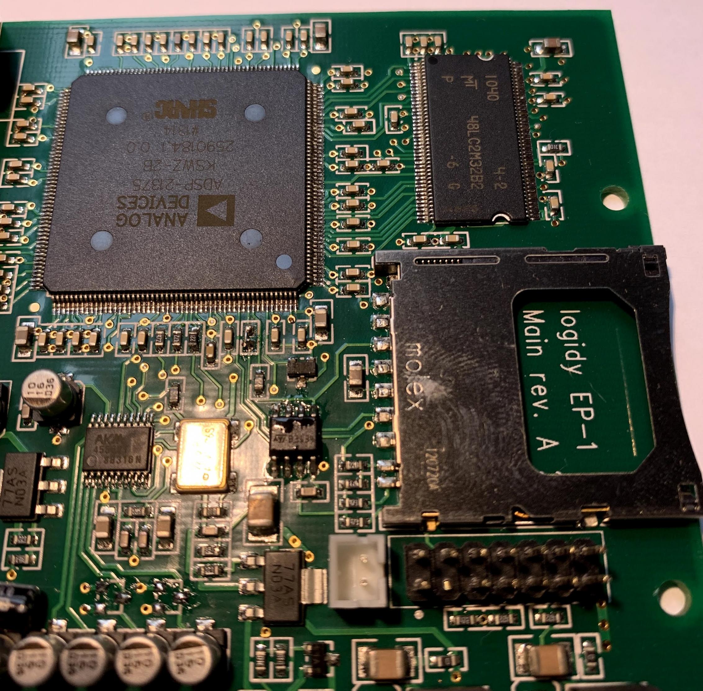

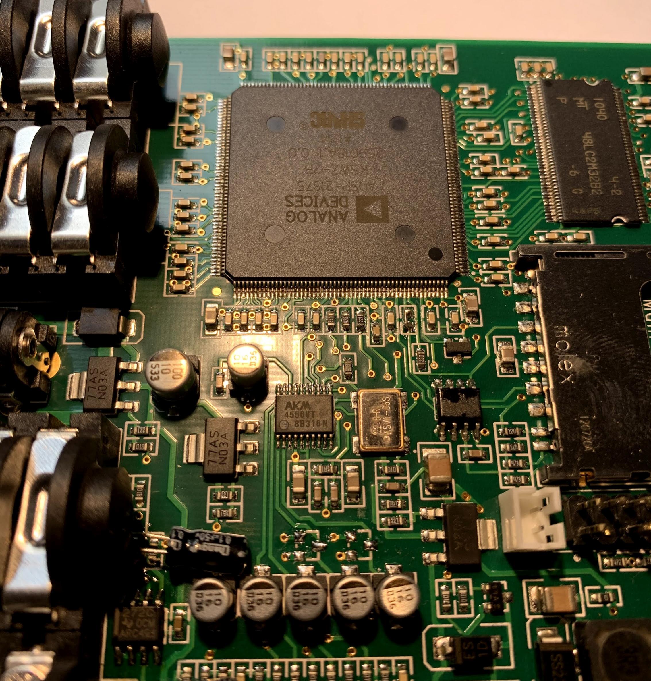

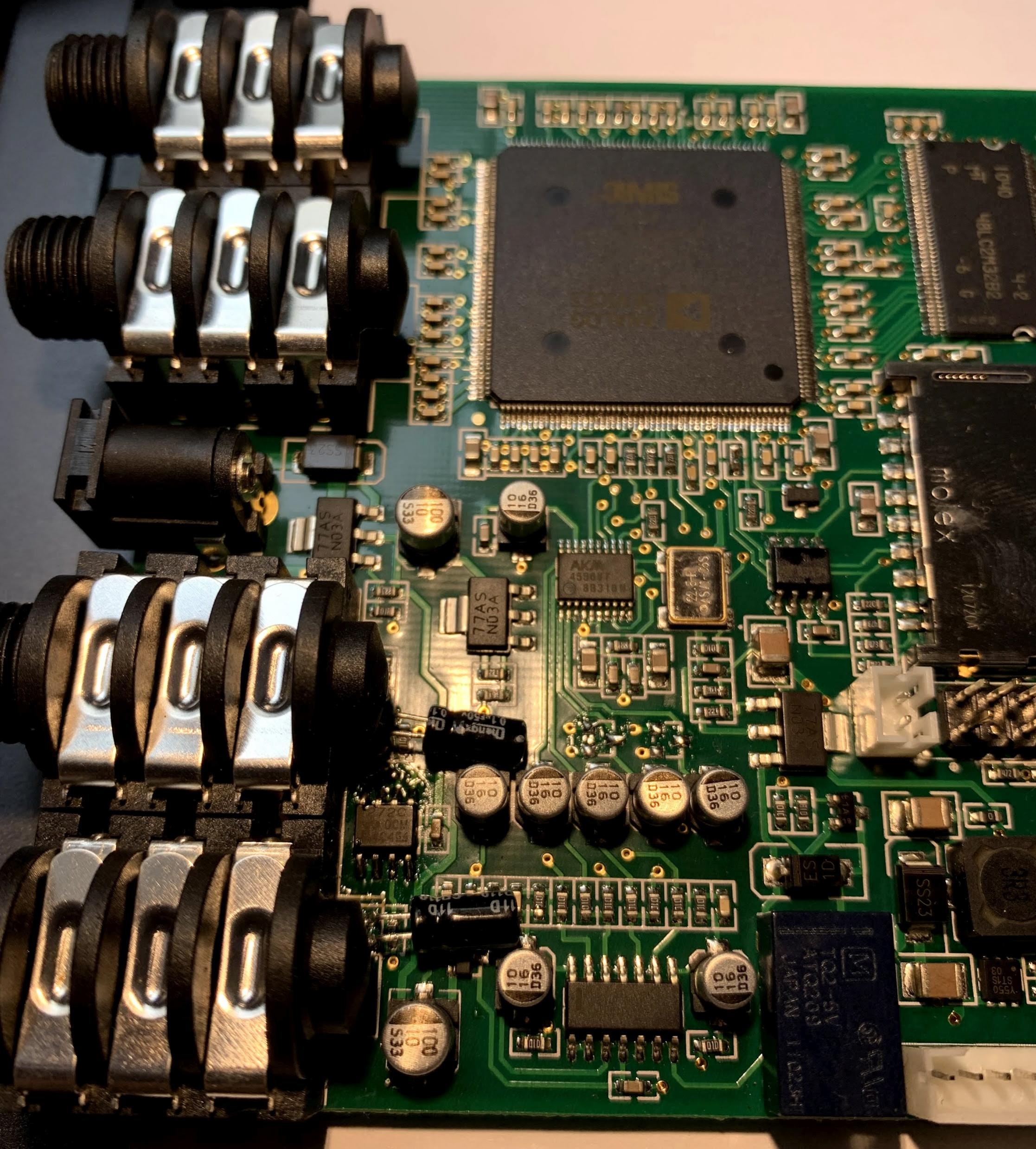

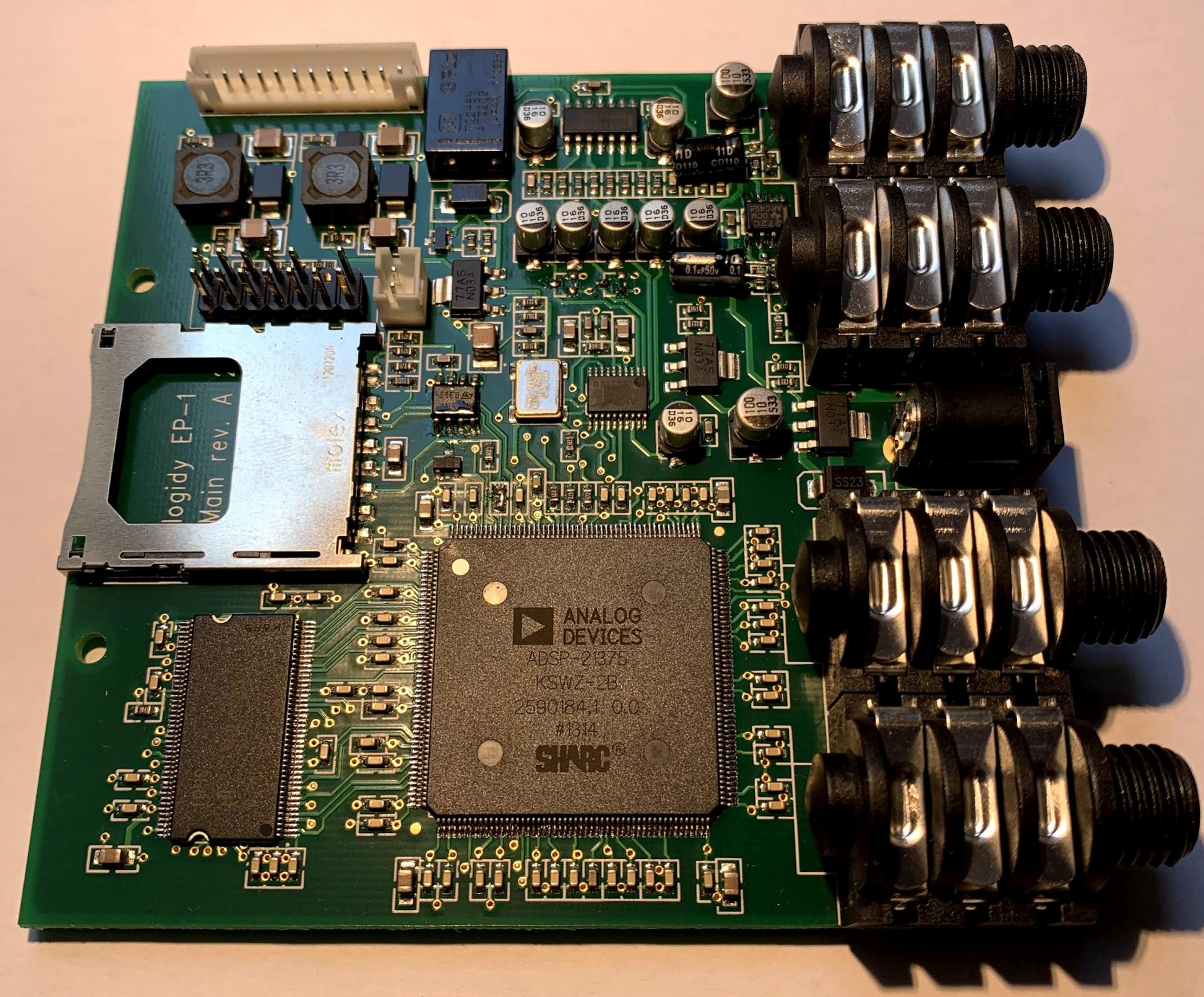

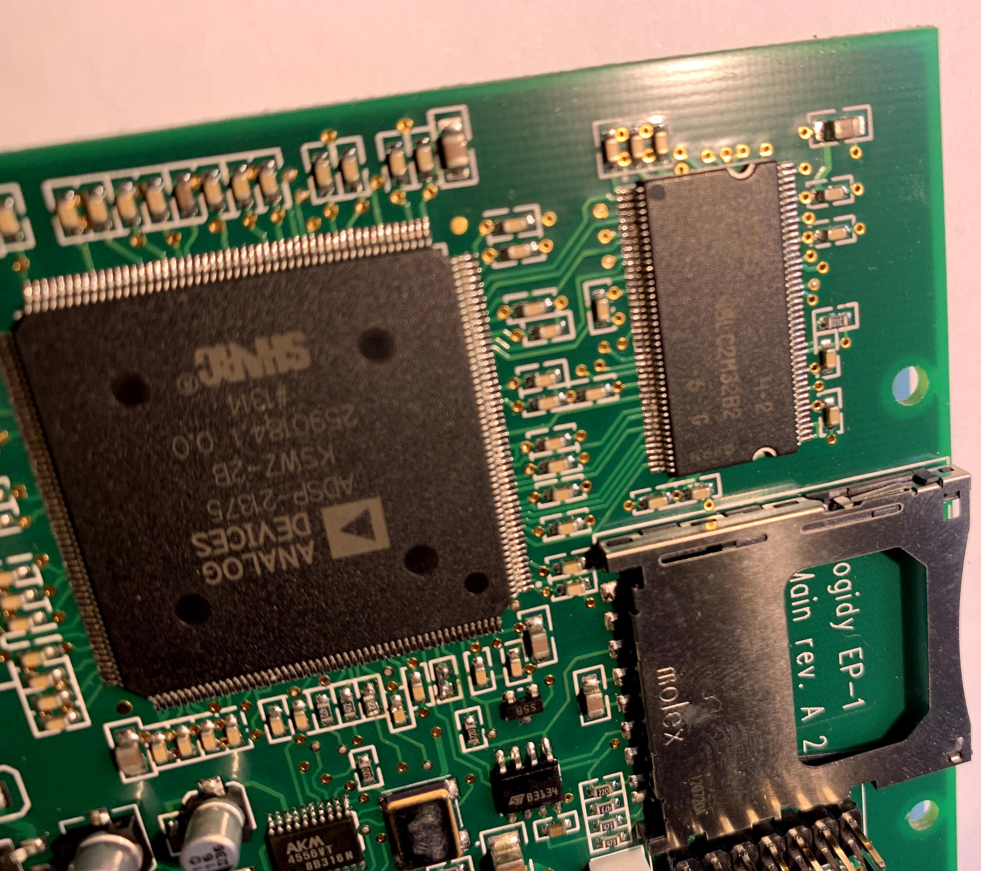

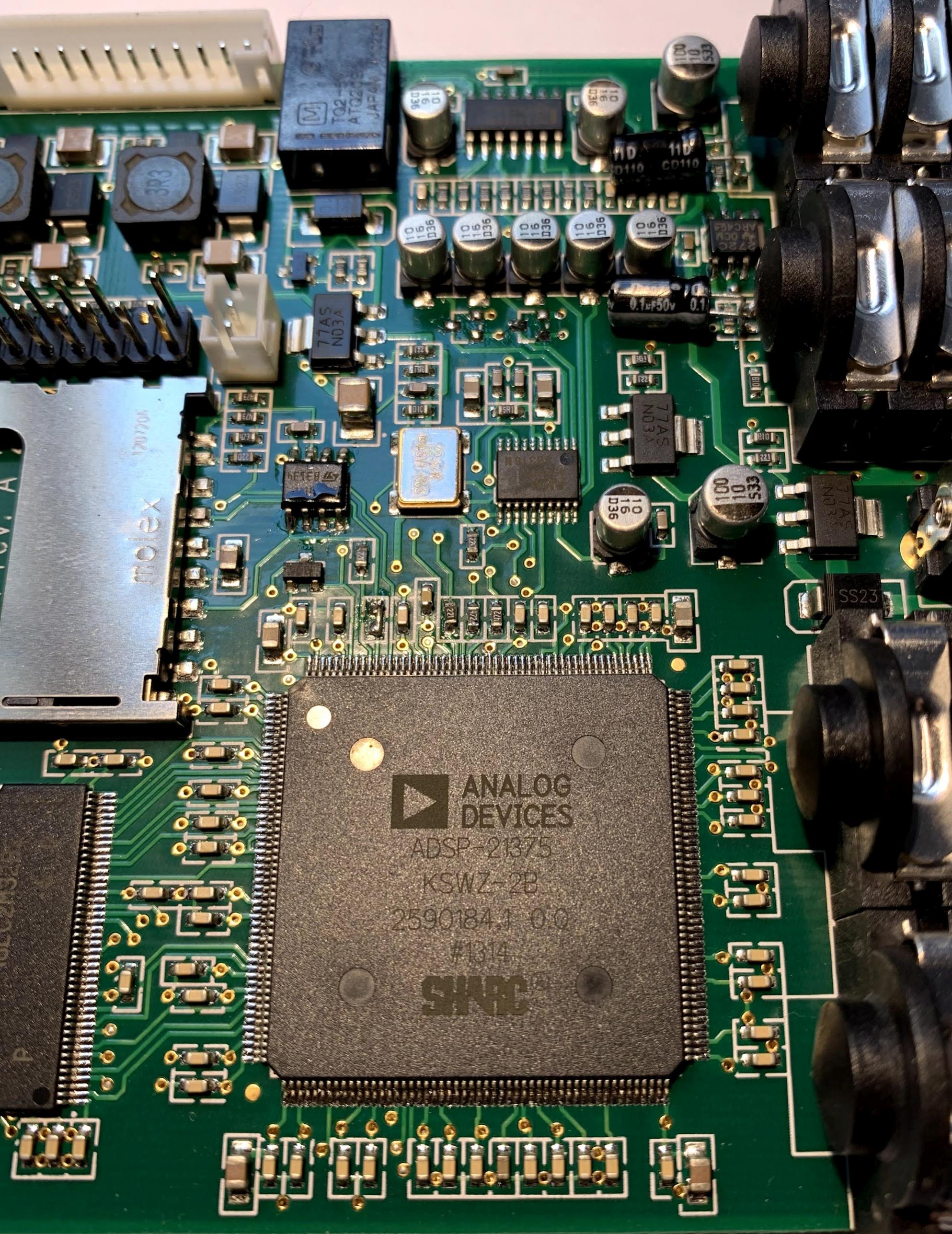

Anyway, I have that piece of hardware and it can do stereo convolution with an IR wav 24 bit stereo with maximum of 65535 samples. I wonder if I could try to do DRC and/or phase linearization with this device - I think I can, if I am able to get the IR wav I need...any thoughts on that?
A problem with using a digital guitar pedal for hifi audio is that the data converters (ADC/DAC) inside it are very unlikely to be well suited to hifi.
Have you opened it up to see what chips and clocks are inside? Any good, in-focus, high-res pics of the board you can post?
This device really interests me. Also, I wonder, why it's not being made any more or why no one else seems to have picked up the idea? Was the UI too basic? Seemed to excite a number of people at the time.
Any progress with the pics @pelanj? - it's been a while I know...

Here are some pictures of mine. I hope you can see something there. I can recognize only the DSP and maybe some opamps🙂
