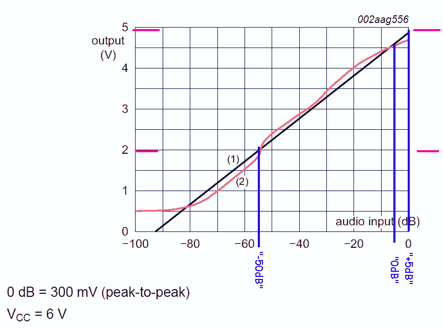

As I understand from SA604A datasheet it has two amplifiers - pin 16 is an input of fist one, with 39 dB.
Pin 12 is an input of second amplifier - it has 40-50 dB.
According to Fig. 2, at 55 dB below its maximum input level, the output is at 2 V, and at maximum level at about 4.8 V. Hence, you could connect the minus side of the meter to a voltage divider with 2 V open-terminal voltage and a resistance of (4.8 V - 2 V)/500 uA - 650 ohm = 4.95 kohm. You then still need to add an attenuator at the input to reduce your +5 dB level to 300 mV peak-to-peak.
Assuming an accurate 6 V supply, the voltage divider that generates the 2 V would consist of two resistors, a 14.85 kohm resistor (15 kohm nearest E24 value) to the +6 V and a 7.425 kohm resistor (7.5 kohm nearest E24 value) to ground.

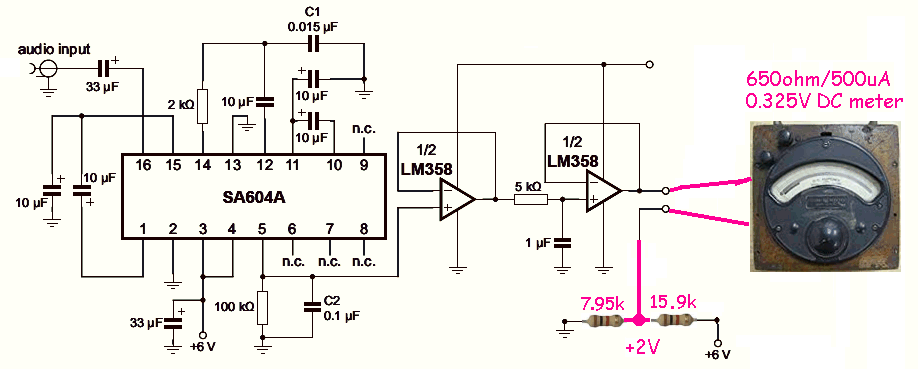

I drew before I saw what MarcelvdG described. (Don't know why we got different resistors.)
Designing a *Good* audio level meter is not just some cellphone RSSI pin and adapting it to a needle. Average? Peak? RMS? Peak-Hold? Decay?
I never thought to have the negative terminal floating. Would that cause issues when the input signal level falls below 55dB and the meter gets -2v?

Should I add an opamp buffer to the input side then? I have a 15VAC transformer already being used for an amplifier that I can pull rails off. I can also add the attenuation potentiometer into the feedback loop of said opamp for input-level tuning.
It will drive the needle way into the left corner, but probably without damaging it. If you want to prevent that the meter gets driven negatively, you could replace the LM358 with a rail-to-rail dual op-amp and add a diode between the output and the feedback point of the right op-amp, so the output can only source and not sink current.

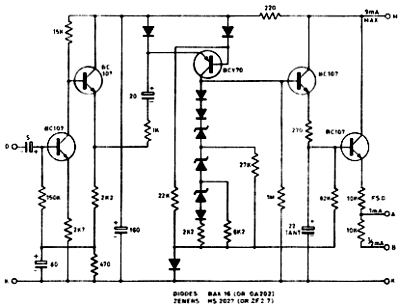

So far we are adding a below-zero suppressor, an input buffer, a quasi-peak detector, which includes attack/release time constants.....
So what is really left is the chain of clippers to give a rough approximation of "log". Which really could be a couple diodes on an opamp.
There are many ways to skin this cat. Maybe without needing a lot of side-dishes to finish the meal.
This was good enough for the BBC:
The input buffer is not needed if you want a +5 dB level far above 150 mV peak, just make a voltage divider with the internal 1.6 kohm. The quasi-peak part can be left out if the thread starter doesn't require quasi-peak detection, otherwise it can probably be combined with the below zero protection. I don't believe for a moment that that BBC circuit has 55 dB of range.
